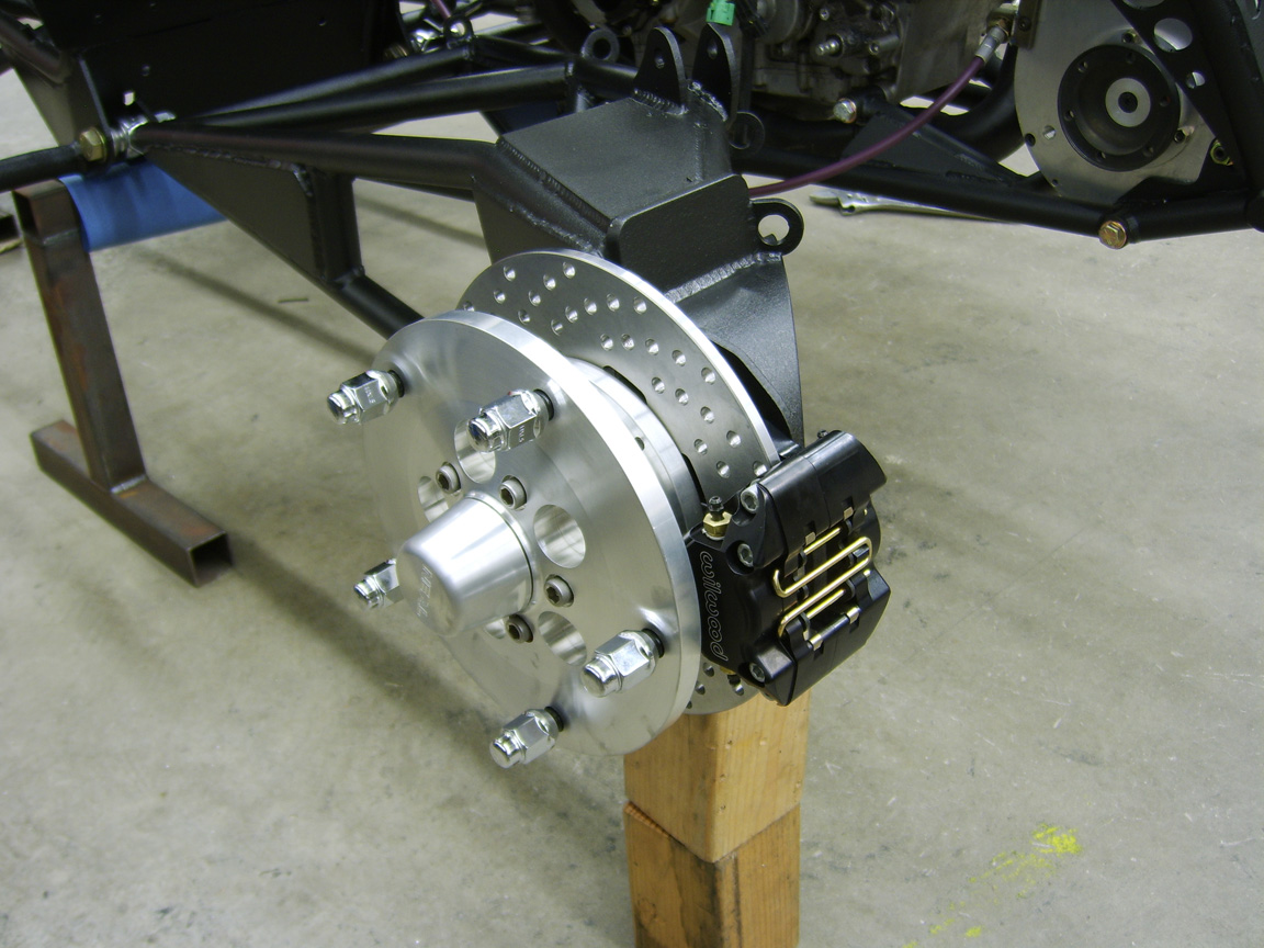

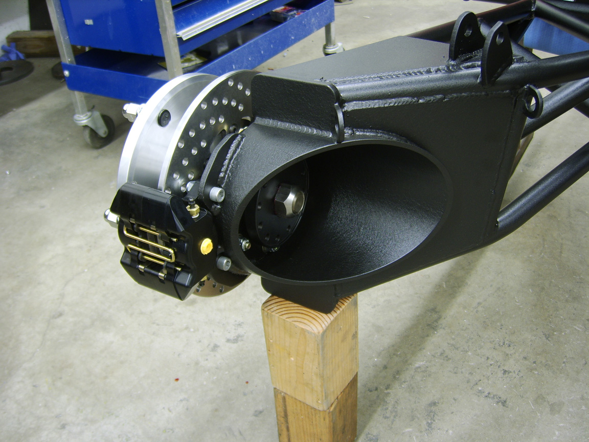

I run Neal rear brakes, rotors and hubs. It is a 3 piece setup with the rotor and rotat hat bolting between the main hub and the center section, so you can just order it without that setup.. I actually order mine without the splined center section because I build my own stubs, hubs and bearing carriers to mount in his unit...
