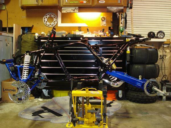

Tomm Posted January 8, 2009 Share Posted January 8, 2009 So I have a 2002 Banshee that sucked in a bit of sand..... So I figured what a perfect time to tear the whole thing apart and rebuild it from the ground up. I have finished the frame and now its a complete rolling chassis. Now to the fun part, the motor. Now obviously I want to be the fastest guy out there and relibal at the same time. What im thinking is the Hot Rods 4 mill stroker kit, 35mm carbs (don't know what brand would be the best idea) Cool head (wondering what sized domes to run), I have a set of Toomy 5's , kinda want to run the CPI in frames but they r kinda spendy. Id rather put the $$$$ in the motor. Any advise is much appreciated. Quote Link to comment Share on other sites More sharing options...
