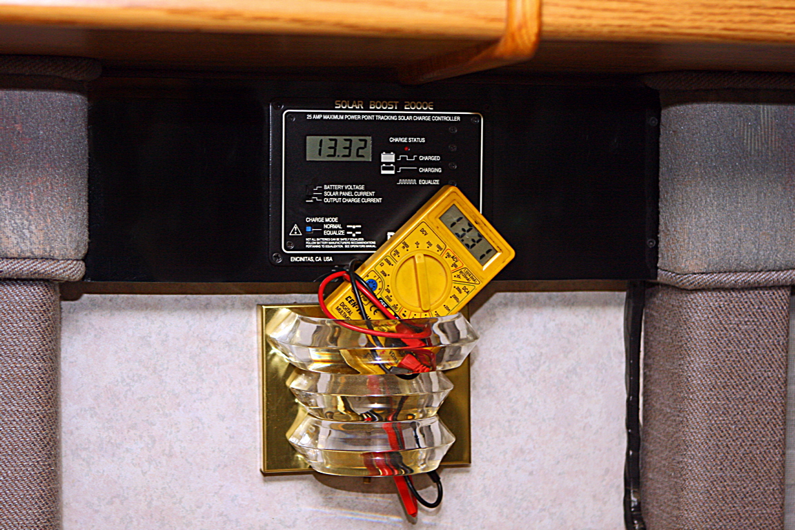

RUn2it Posted January 10, 2009 Share Posted January 10, 2009 effen dingle poked pinholes in his trojans hey wait...i used one of them too OHHHH :poop: back to topic from the side topic i have had t he costco brand 6 volt batts for about 3 years now. they work great. i would recommend the switchover if you can do it. the 6 volts i have fit in the battery boxes that came on my trailer too good luck Ditto Richard Cheese, my 1st set of 4 Costco 6v lasted 8 years and were still good but replaced them and added 4 more. Every time you let voltage get below 12.25 (no load) you shorten their lifespan. Stick a cheap digital voltmeter somewhere easy to see. This is where I had mine till I did the solar setup. Quote Link to comment Share on other sites More sharing options...
