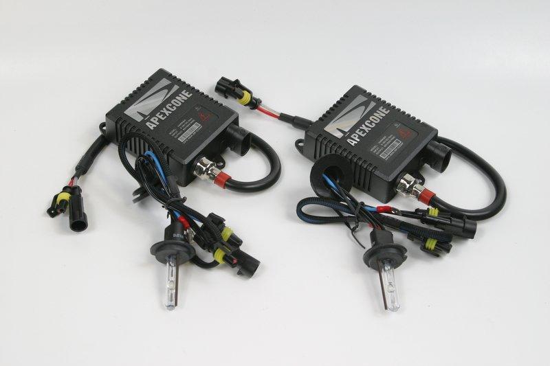

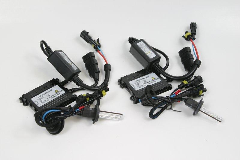

Richard Cheese Posted January 11, 2009 Share Posted January 11, 2009 hey joe joe check this shizz out http://www.ddmtuning.com/hidkihidbuhi.html scroll down to the raptor brand hid's im runnin them in my truck, as well as my bro and a few friends...no problems whatsover.... from the looks of the pics on the ebay links you posted, they are the same small ballast...you just need to find out what bulb your rappy runs and buy those...save yourself some coin too! Quote Link to comment Share on other sites More sharing options...

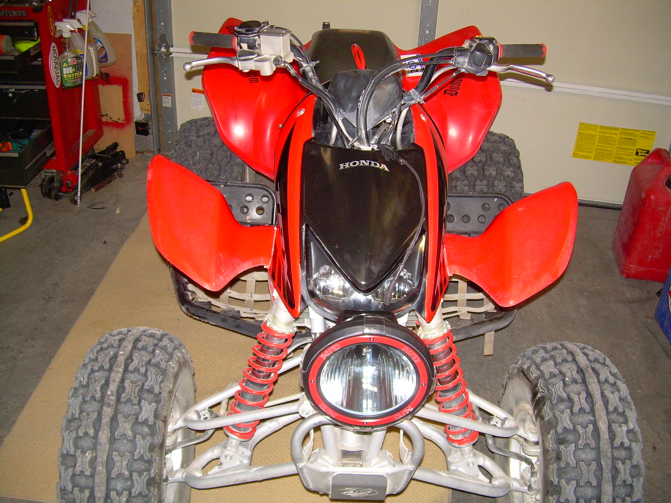

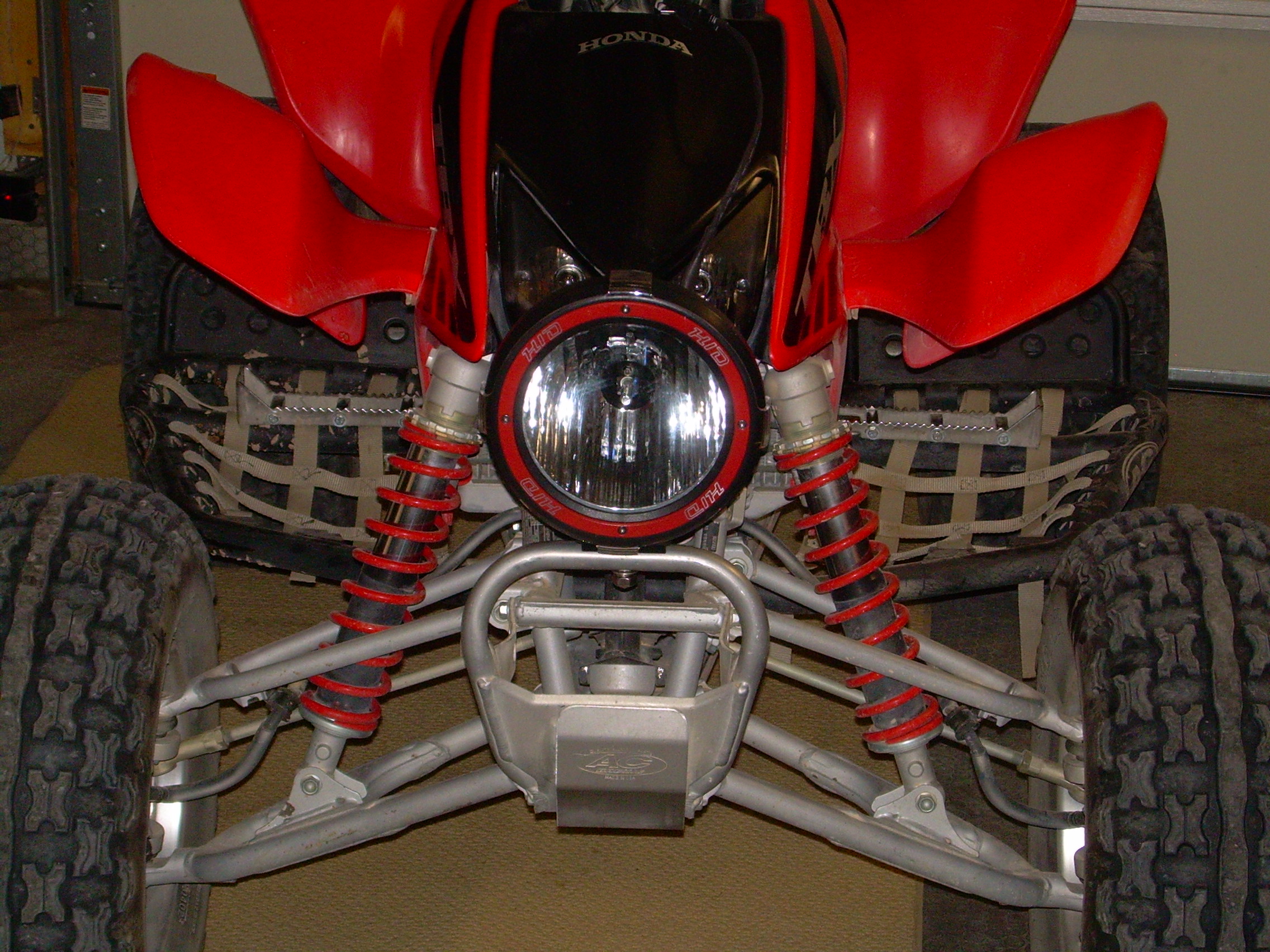

Vegas250rr Posted January 11, 2009 Share Posted January 11, 2009 (edited) i have read on another forum with another brand of 50 w hid's that the stock harness cannot handle the initial power it takes to fire up the hid's have you tried the 35 watt ones instead of the the 50 watts?? is this happening with only the sol-tecs on, or other lights too? how many sol tecs? I did a HID conversion to my solteks, I wired a 10g. hot and Neg through a 40amp relay and a maxifuse... I have more than enough wire in my harness. and I am using a HI/LOW foot switch out of a older ford truck to fire the relay. see the pics below Edited January 11, 2009 by Vegas250rr Quote Link to comment Share on other sites More sharing options...
Richard Cheese Posted January 12, 2009 Share Posted January 12, 2009 I did a HID conversion to my solteks, I wired a 10g. hot and Neg through a 40amp relay and a maxifuse... I have more than enough wire in my harness. and I am using a HI/LOW foot switch out of a older ford truck to fire the relay. see the pics below yep...enough wire you could fuggin light up a small casino with that setup call them on their lifetime warranty. you would be the first person i have heard of to do it Quote Link to comment Share on other sites More sharing options...
White Rhino Posted January 12, 2009 Share Posted January 12, 2009 (edited) I did a HID conversion to my solteks, I wired a 10g. hot and Neg through a 40amp relay and a maxifuse... I have more than enough wire in my harness. and I am using a HI/LOW foot switch out of a older ford truck to fire the relay. see the pics below Fuggin A, Vegas250RR doesn't do things HALF a$$!!!! very nice set up!!! Edited January 12, 2009 by White Rhino Quote Link to comment Share on other sites More sharing options...
