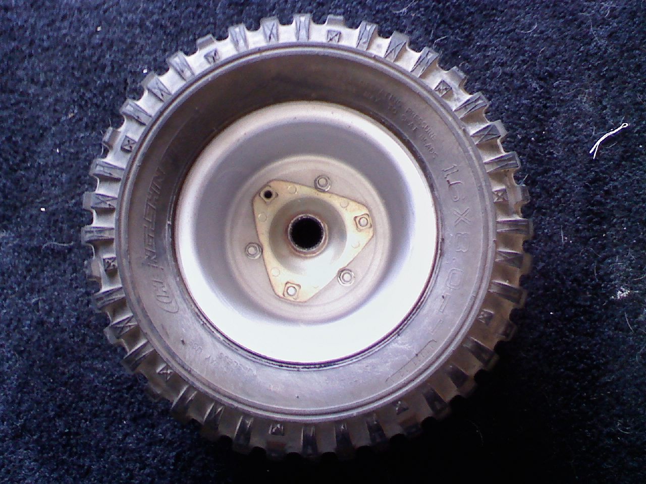

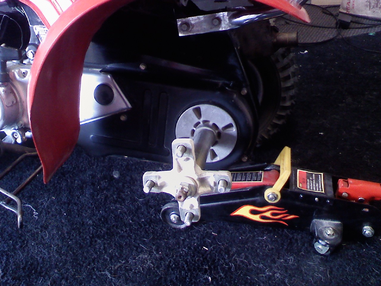

RAGDOLL MX Posted January 23, 2009 Share Posted January 23, 2009 (edited) u got any tips/ tricks or other information and part #s that could help other 70 owners. well as iam tinkering with my 70, iam wanting to get rid of the 3/100 bolt pattern, and iam looking at a set of blaster 200 rear hubs, i wondering if they fit the spline.. YES they do!..now i can up grade 4/100 24 spline COLLAR,WHEEL (U49) 2XJ-25383-00-00 $78.31 or go here and get a 4/110 for a set 35.00 http://www.sterdyproducts.com/productcart/...mp;idproduct=87 just FYI old nasty 2 peice wheel with the 3/100 hub newhub to accodimate the new wheels 4/100 Edited January 23, 2009 by NACHOOOO MOG Quote Link to comment Share on other sites More sharing options...
mineurbiz Posted January 23, 2009 Share Posted January 23, 2009 Cole you should try some YFZ or Raptor hubs, bad thing about Blaster hubs is that they are the only ones in the Yamaha family to use that bolt pattern. Tip: If I am not mistaken with a little work you can get the CRF50 aftermarket pipes to work on a ATC70, but I will verify this. Quote Link to comment Share on other sites More sharing options...
Vegas250rr Posted January 23, 2009 Share Posted January 23, 2009 Cole you should try some YFZ or Raptor hubs, bad thing about Blaster hubs is that they are the only ones in the Yamaha family to use that bolt pattern.Tip: If I am not mistaken with a little work you can get the CRF50 aftermarket pipes to work on a ATC70, but I will verify this. ATC 200x hubs fit also... that will give you the 4/110 pattern Quote Link to comment Share on other sites More sharing options...

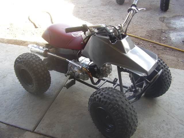

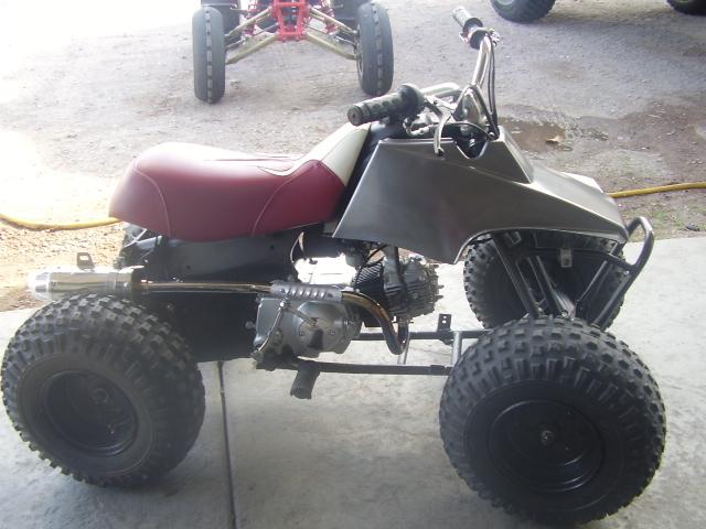

Sand_YFZ Posted January 25, 2009 Share Posted January 25, 2009 I bought an after market big bore pipe off ebay for my trx 70 and had no problems bolting it right up.I had to bend it a tiny bit for clearance issues but it was minor.Of course I have no rear fenders on mine so I guess that would change alot.I think the best thing to do is ditch the whole motor and drop in a bigger one.It makes it so much more fun to ride.The aftermarket motors will bolt right in with no mods to the frame. Quote Link to comment Share on other sites More sharing options...
Sand_YFZ Posted January 25, 2009 Share Posted January 25, 2009 (edited) Here is a more recent pic of the TRX110.It doesnt matter how long this thing sits it always fires right up and runs like a top.This is the only bike ive ever owned that gives me zero issues. Edited January 25, 2009 by Sand_YFZ Quote Link to comment Share on other sites More sharing options...
