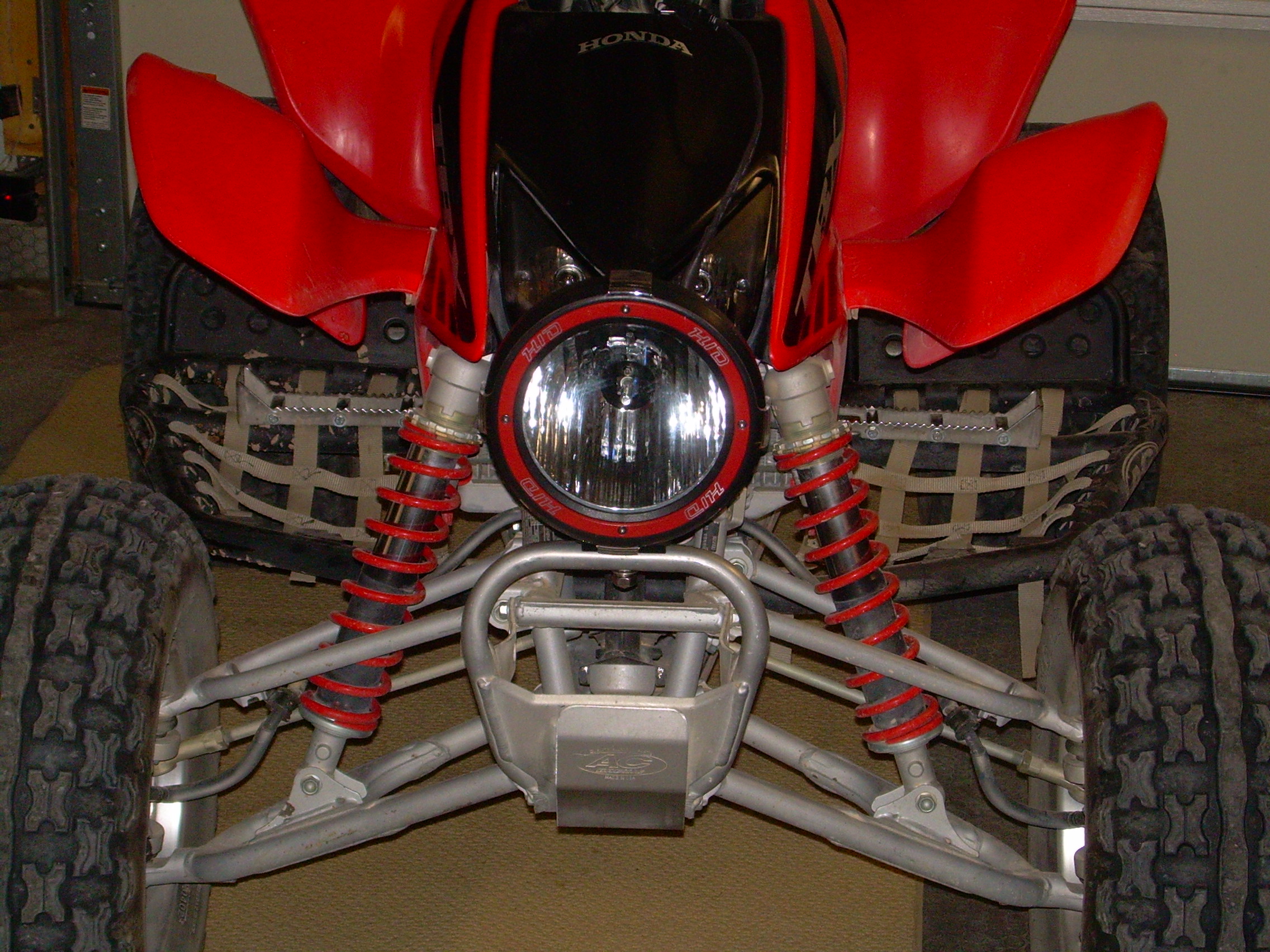

vegas style Posted February 3, 2009 Share Posted February 3, 2009 RUn2it said: You run a HID High Intensity Discharge light that has a ballast and igniter on AC power? yep i run a checker auto $!00 7" hid on my 04 honda 450r kick start no battery. i have it wired into the high beam circuit no real flicker very bright puts all the stock quad lights to shame. have posted the pic several time here it is again. Quote Link to comment Share on other sites More sharing options...

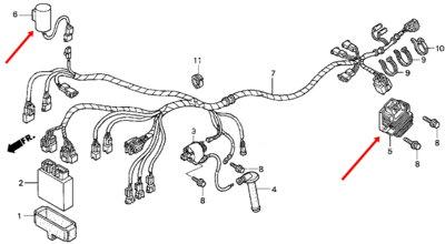

RUn2it Posted February 3, 2009 Share Posted February 3, 2009 vegas style said: yep i run a checker auto $!00 7" hid on my 04 honda 450r kick start no battery. i have it wired into the high beam circuit no real flicker very bright puts all the stock quad lights to shame. have posted the pic several time here it is again. I looked your quad up and it has a rectifier/regulator and a capacitor which takes the place of a battery. Without these it would fry. Too bad all quads don't have these. Quote Link to comment Share on other sites More sharing options...

Vegas250rr Posted February 4, 2009 Author Share Posted February 4, 2009 vegas style said: yep i run a checker auto $!00 7" hid on my 04 honda 450r kick start no battery. i have it wired into the high beam circuit no real flicker very bright puts all the stock quad lights to shame. have posted the pic several time here it is again. how good is this light for peripheral vision? Quote Link to comment Share on other sites More sharing options...
vegas style Posted February 4, 2009 Share Posted February 4, 2009 for me its great i put it on at night and take it off in the morning. it has a huge oval beam. Quote Link to comment Share on other sites More sharing options...
