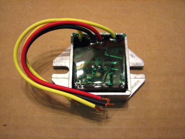

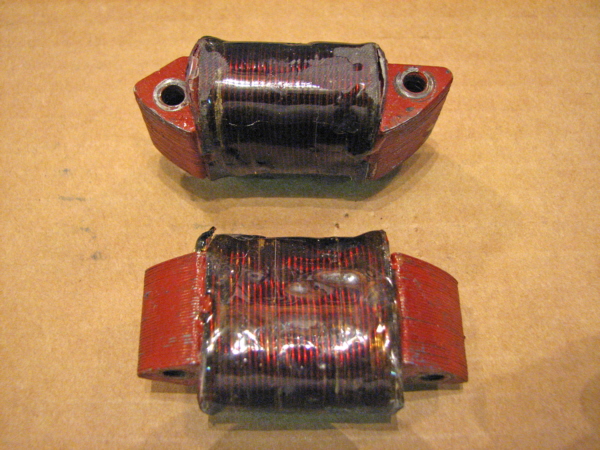

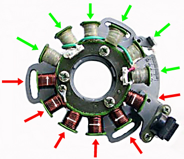

RUn2it Posted February 17, 2009 Share Posted February 17, 2009 On super bowl weekend, I switched my stock stator on my banshee to a new 200w ricky stator stator. Went for the first ride and it quit on me. When I got back, I called them about the warranty. After talking to a few people, I guess this isn't an isolated incident. Anyone else ever had problems with ricky stator? What are other good brands? Sandfrk33, you said it quit on you, quit running/ignition or the light quit? Was it a new/aftermarket assembly or rewound lighting coils and your orig stator sent for a core? The lighting coils are an easy rewind, the trick to make them last is clear epoxy coat the coils so they don't vibrate and wear through the insulating coat and moisture proof. I made new coils for my LT 250 & 500, iron laminate core and windings and no problems for 10 years, the epoxy is the trick, regular not quick dry, too brittle and vibration cause little cracks thats not moisture proof. Your banshee stator has 6 ignition source coils (green arrows) and 6 lighting coils (red arrows) and the higher wattage rewinds just use bigger gauge and wound in alternating directions (white arrows) Add 1 of these (rectifier/regulator) and a small battery (some get by with a capacitor) and you can run an HID or 2, more light and uses less power. Quote Link to comment Share on other sites More sharing options...
otis Posted February 17, 2009 Share Posted February 17, 2009 Add 1 of these (rectifier/regulator) and a small battery (some get by with a capacitor) and you can run an HID or 2, more light and uses less power. Have you done the HID conversion to your bikes? .... You wouldnt happen to have pics and a step by step would you??... Quote Link to comment Share on other sites More sharing options...
RUn2it Posted February 17, 2009 Share Posted February 17, 2009 Have you done the HID conversion to your bikes? .... You wouldnt happen to have pics and a step by step would you??... I have an HID on the LT500. 1, HIDs (and bikes, quads with a battery) must have DC power. 2, all ATVs, bikes etc have a stator (ALL stators are AC) and a regulator to shed voltage above 14V so your elect components don't fry OR elect start and some kick starts have a regulator/RECTIFIER that turns AC current to DC (Alternating Current to Direct Current). If your bike, quad has a battery simply replace the light with an HID (some have a capacitor in place of a battery like the '05 kick start CRF 450 quad), The LT 500 was the stator/regulator type so I had to put a regulator/RECTIFIER and battery BEFORE the HID was installed. I helped a friend put an HID setup on his Banshee that used a capacitor in place of a battery, he said it worked OK but I'd rather have a battery even if it's just 1 of the little dry cell pack that are sold with some HID kits. There you go, and some HIDs are EXPENSIVE and there's HID conversions for existing lights for under $75 w/lifetime warrantee for 2 lights, so you could get a couple halogen lights that have a light pattern you like (I've seen pairs of Hella at Walmart was around $70 +/- I think) and a HID conversion from someplace like DDM (Google it). Just remember HIDs Must have DC power. Quote Link to comment Share on other sites More sharing options...
