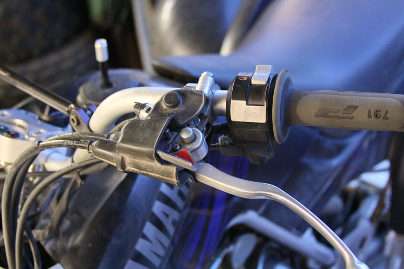

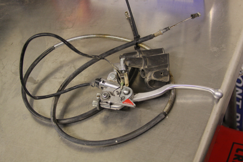

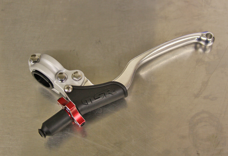

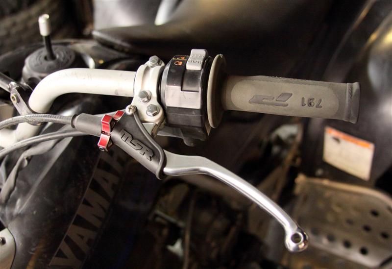

dunefreak Posted April 15, 2009 Share Posted April 15, 2009 I don't know why I didn't do this a LONG azz time ago. As everyone knows those park brakes are the worst idea ever on the Raptor 660's. They never work and when they do they usually stick. So I picked up a new MSR EZ pull clutch perch from Ebay for only about 25 bucks. I feel like I just removed about 100 pounds of absolute chit from my quad tonight. What a difference! Cheap, easy bolt-on bike improvements are the best. BEFORE AFTER This thing is nice. It has a super easy cable adjustment too. :poop: Quote Link to comment Share on other sites More sharing options...
rushjunkie Posted April 15, 2009 Share Posted April 15, 2009 Looks good! I've been wanting to do this on my 450. Did you just unplug the wires coming from the oem perch? no splicing? Quote Link to comment Share on other sites More sharing options...
dunefreak Posted April 15, 2009 Author Share Posted April 15, 2009 Looks good! I've been wanting to do this on my 450. Did you just unplug the wires coming from the oem perch? no splicing? yep I just unplugged them. Bike still starts so I didn't worry about having to do anything else. Quote Link to comment Share on other sites More sharing options...
