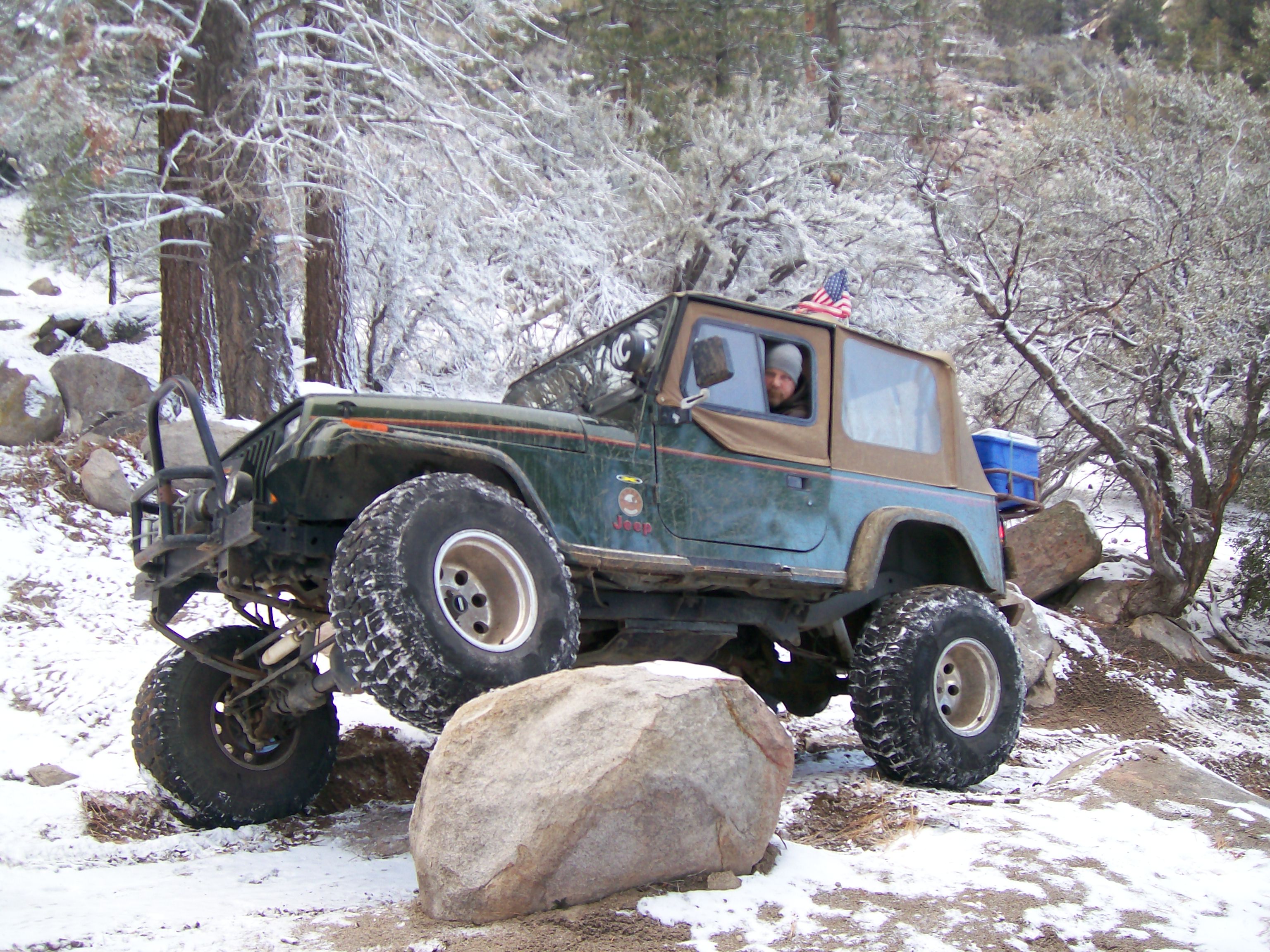

barefoot bob Posted May 4, 2009 Share Posted May 4, 2009 (edited) mountain off road engineering flip kit unless your going for a small lift Edited May 4, 2009 by barefoot bob Quote Link to comment Share on other sites More sharing options...
Jeep4Cern Posted May 4, 2009 Author Share Posted May 4, 2009 4" lift. Quote Link to comment Share on other sites More sharing options...
barefoot bob Posted May 4, 2009 Share Posted May 4, 2009 make sure what ever kit you get that it has the front shackle reverse kit. in other words your front leaf springs are shackled to the back of the jeep not the front. i dunno what kind of wheeling you do but if your gonna play on the rocks you should get a sway bar quick disconect. if you replace any of the springs make sure you specify soft ride. flipping the axel gives you 6 " and you have to lower the t case you still might have to to get proper angle on the four. or sell it and just buy mine ................... Quote Link to comment Share on other sites More sharing options...
