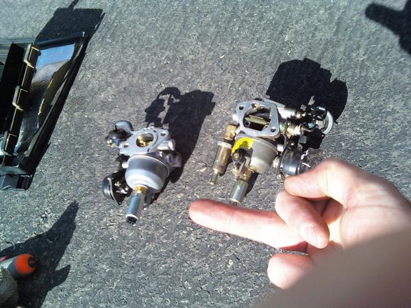

dunefreak Posted August 6, 2009 Share Posted August 6, 2009 Well my recent problem I had with my generator was NOT the carb. :beer_bang: How do I know this? I just bought a new carb and put it on and nothing has changed. Same problem still exists. So anyways, hopefully someone can help. Here's what it's doing. Earlier it fired up with a couple pops right after startup but it fired up. Then I turned both A/C units on and ran it for about 45 minutes. It ran great. Then it chugged for a split secoond a couple times, then about 10 seconds later it backfired then died. Now it fires up no prob with the usual pop or two right after startup, but as soon as I turn on the AC unit (or any other heavy load) it bogs and backfires bigtime. Here's is what I have checked... -oil level is good -fuel volume seems ok and fuel qaulity is good -fuel filters are both new -new carburetor -200 bucks and 2 beers later I'm still pretty pissed off eff yoooou 200 dollar carb for nothin Night drags trip ain't lookin so good! Quote Link to comment Share on other sites More sharing options...

dunefreak Posted August 6, 2009 Author Share Posted August 6, 2009 Thanks skinner. I checked the fuel line all the way from the generator back to the tank. It seems fine and doesn't seem like it is routed anywhere near a heat source that would cause it to vapor lock. I still think it is fuel issue and possibley a faulty fuel pump. I just need to find out a way to test it. I'm gonna bring home some test equip from work today and see if I can check it. Quote Link to comment Share on other sites More sharing options...
raspadoo Posted August 6, 2009 Share Posted August 6, 2009 Pete, have you replaced the fuel line? try running a temporary line if you have some laying around :freakin_nuts: Quote Link to comment Share on other sites More sharing options...
dunefreak Posted August 6, 2009 Author Share Posted August 6, 2009 Pete, have you replaced the fuel line? try running a temporary line if you have some laying around :freakin_nuts: I thought of doing that and running a line right into a gas can from the fuel pump inlet. But like I said, I checked the line and it looks to be in good shape and no links either. Quote Link to comment Share on other sites More sharing options...
bp-guy Posted August 6, 2009 Share Posted August 6, 2009 It sounds like an air in the fuel issue. But if you checked all your lines then you would have seen a craked fuel line. How about the carb gasket area? Did you try the brake cleaner trick to find an air leak when running? Start the generator and lightly spray around the carb where it mounts and listen to the idle for a change in rpm's. The fuel pump might have a pin hole in the diaphram also. Try having a small can with fuel hung above the carb outside the trailer and let it gravity feed into the generator. If it runs fine with just gravity feeding it then I would suspect the pump being faulty. Quote Link to comment Share on other sites More sharing options...

dunefreak Posted August 6, 2009 Author Share Posted August 6, 2009 This is a good way to check it. I ran a line to a 5 gallon jug that was sitting under the geni and it ran all day. Being a pull pump, it would suck the fuel a short distance no prob. Sucking the fuel through 35 feet of fuel line, no bueno! Also, is the pump real quiet when you prime it? A good pump taps like a mofo when it priming........ Is there an echo in here? LOL I thought of doing that and running a line right into a gas can from the fuel pump inlet. But like I said, I checked the line and it looks to be in good shape and no links either. Quote Link to comment Share on other sites More sharing options...

dunefreak Posted August 7, 2009 Author Share Posted August 7, 2009 Well I checked a bunch of stuff tonight. 1. checked the valves. None were sticking or seemed to be hanging up. They were on the loose side so I adjusted them. They seem quieter now, but no change with the backfiring under load. 2. Fuel pump is flowing plenty of fuel. I even ran a fuel line from the inlet of the pump to a gas can and also removed the line on the carb to watch the fuel and it flows plenty. 3. Most of the time when the A/C or any large load is turned on, it chugs & backfires immediately. When it does this I spray carb cleaner in the carb and it only makes it worse. I am pretty convinced it is not a fuel problem or lean condition. Sometimes it will run one ac unit with no troubles at all. It's hit or miss. 4. I double checked all grounds and connections. I got nothin. It seems like it might even be electrical at this point. If it was a fuel issue, it would start to surge or at least wait until the carb bowl went dry then backfire. It does it as soon as you turn the A/C on. It's like the ignition is almost being draw down or grounded when there is a large load applied. Quote Link to comment Share on other sites More sharing options...
