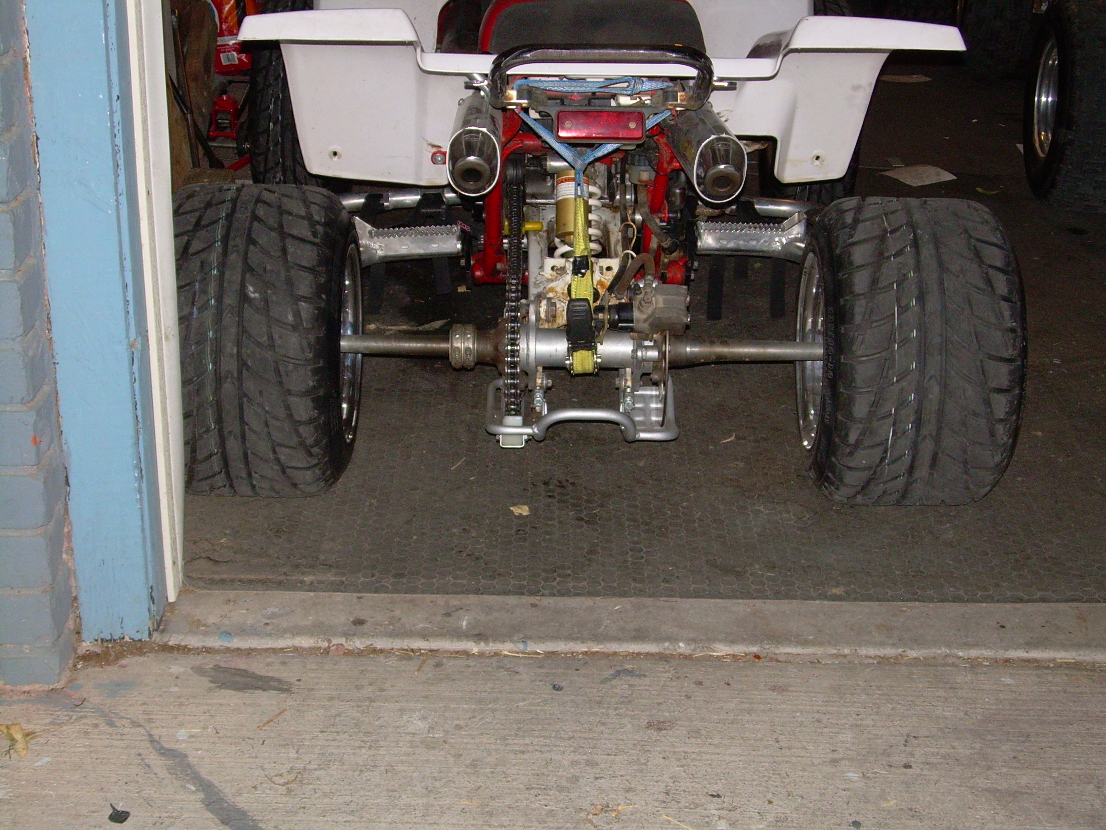

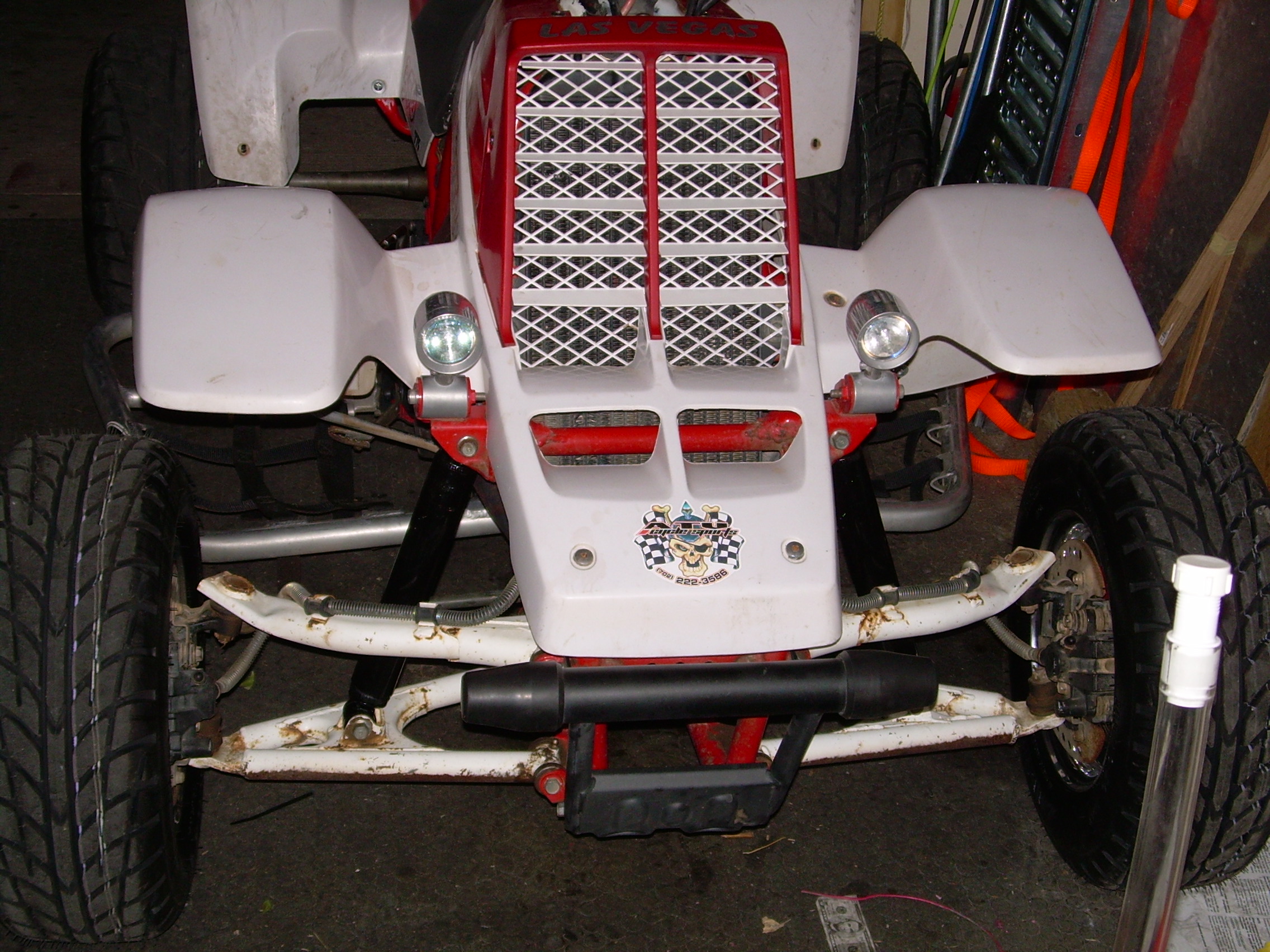

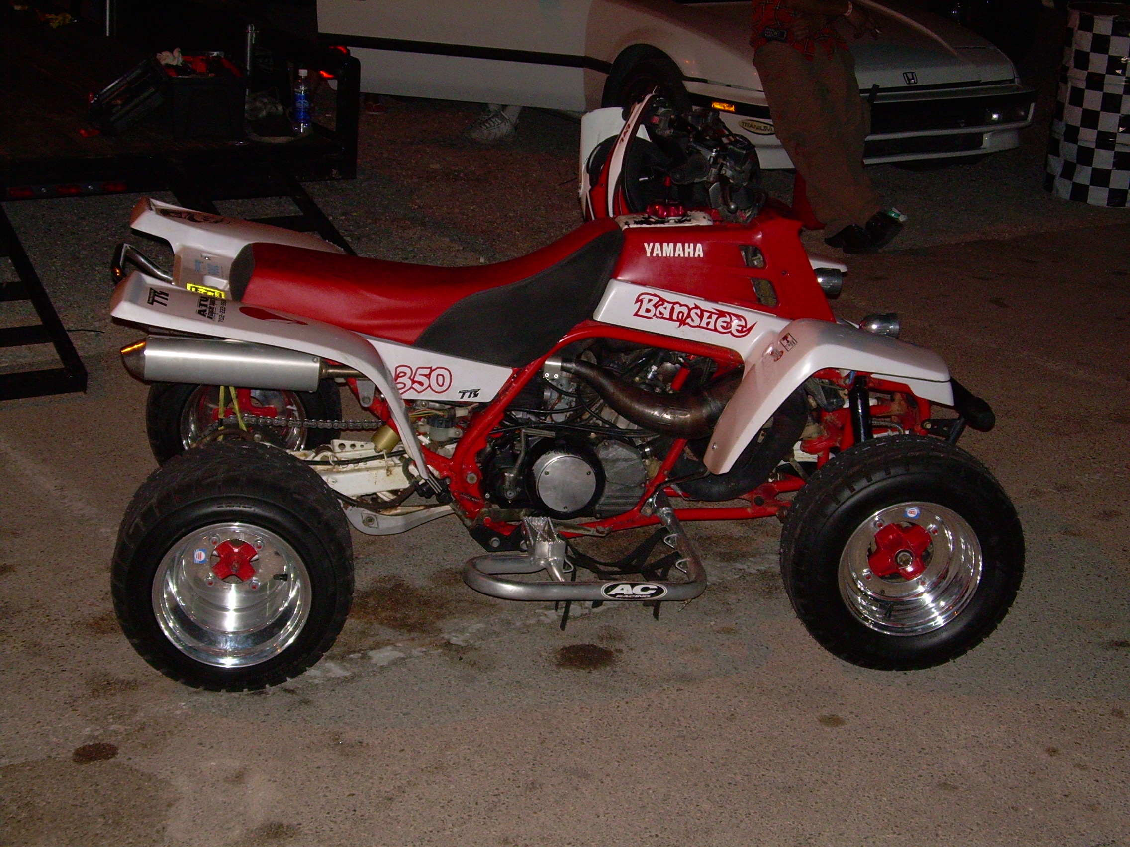

vegas style Posted August 14, 2009 Share Posted August 14, 2009 a few years ago we ran our quads out at the sloan go cart track. on my banshee i ran front shocks with no springs and we ratchet strapped the rear down making it ridged. and street slicks. a little ghetto but was a cheap set up (other then the tires) for the limited track time. Quote Link to comment Share on other sites More sharing options...
