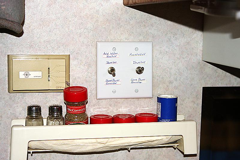

RUn2it Posted August 15, 2009 Share Posted August 15, 2009 The micro/water heater panel Oh yeah, most electronic stuff have some current draw when turned off, I think my Dish receiver uses nearly the same power off or on. Quote Link to comment Share on other sites More sharing options...

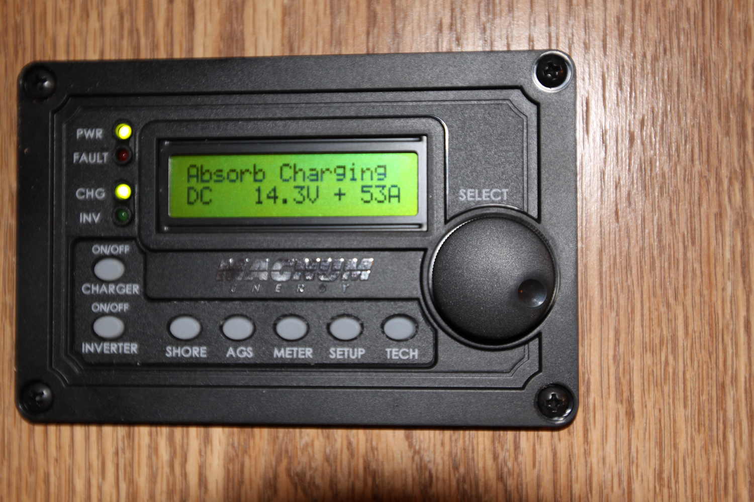

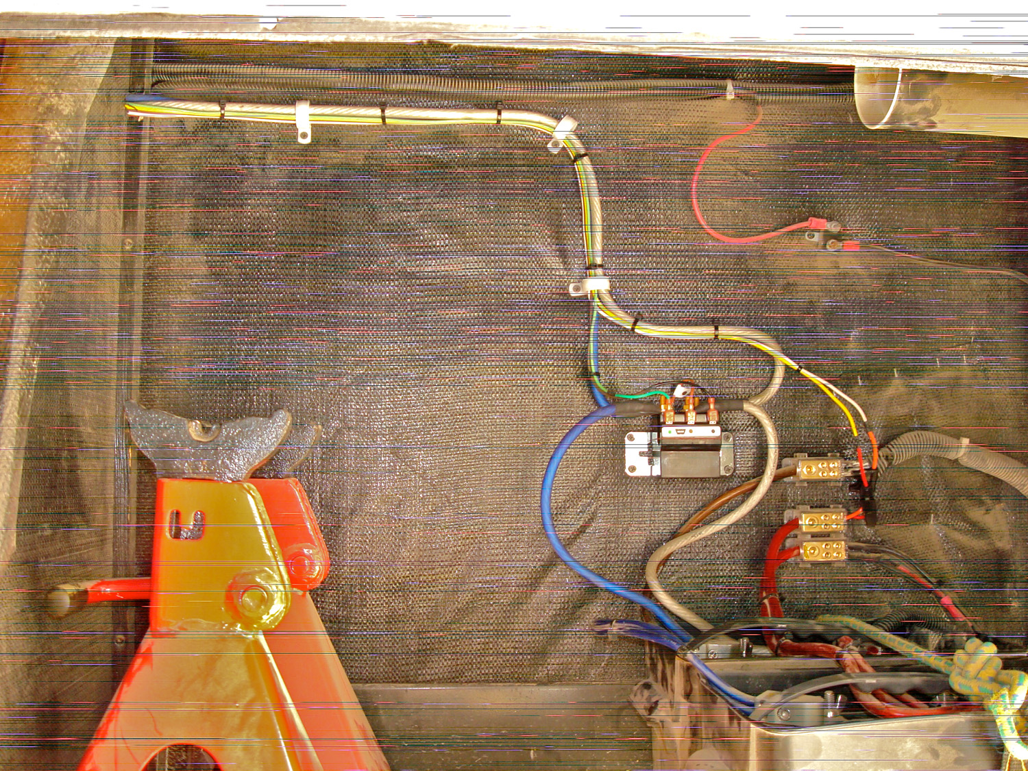

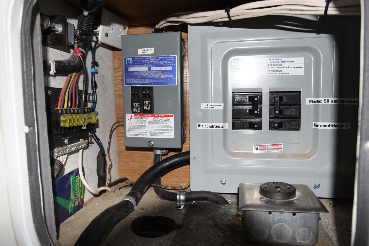

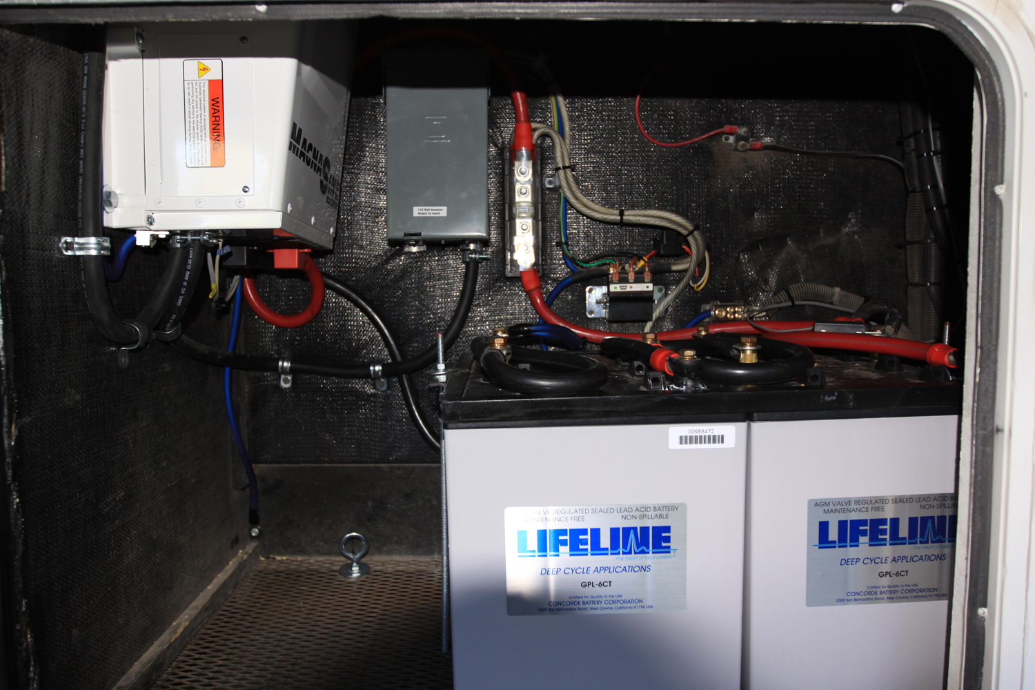

80grit Posted November 7, 2009 Author Share Posted November 7, 2009 I finished my inverter project and converted to 6 volt batterys. Here is the finished set up. Original pic of battery compartment with 2-12 volt supplys & winch connections. Here is the conversion Inverter is the white box on the left. Its a 3000 what inverter with 100 amp charger. Running two 30 amp lines to and from it. The grey box on the right is dual 120volt 30 amp breakers from the inverter (I pulled two 30 amp lines out of the inverter to feed the trailer) The next thing to the right is a 300 amp DC fuse I welded up a collar for the batterys and welded 4 steel strips under the batterys for support of the battery weight and then tied those together on each end with a threaded rod. (They wont slide out of place ) Then went with 4-300 amp hour sealed life line batterys (they are no maintenance batterys) They are 93 lbs a piece In this picture I added a sub panel to take the supply from the inverter and supply 4 - 15 circuits to the trailer. Everything but the air conditioners are on this. The panel on the right is the original panel that supplys 50 amp service to the trailer. I put in a double pole double throw 30 amp breaker in to supply the inverter with 2 - 30 amp circuits. Although I would never use that much power, it leaves the charger with plenty of power to charge the batterys at 100 amp charging rate when the generator is running. There was a small 45 watt charger where the sub panel is now and I took that out as it was no longer needed. The whole system is accessable inside the trailer via a remote control It was a fun project to tackle just took a while to plan it all out. Installation was not hard at all. Ill run some tests this next trip to see how long I can go before recharging via generator. Quote Link to comment Share on other sites More sharing options...
