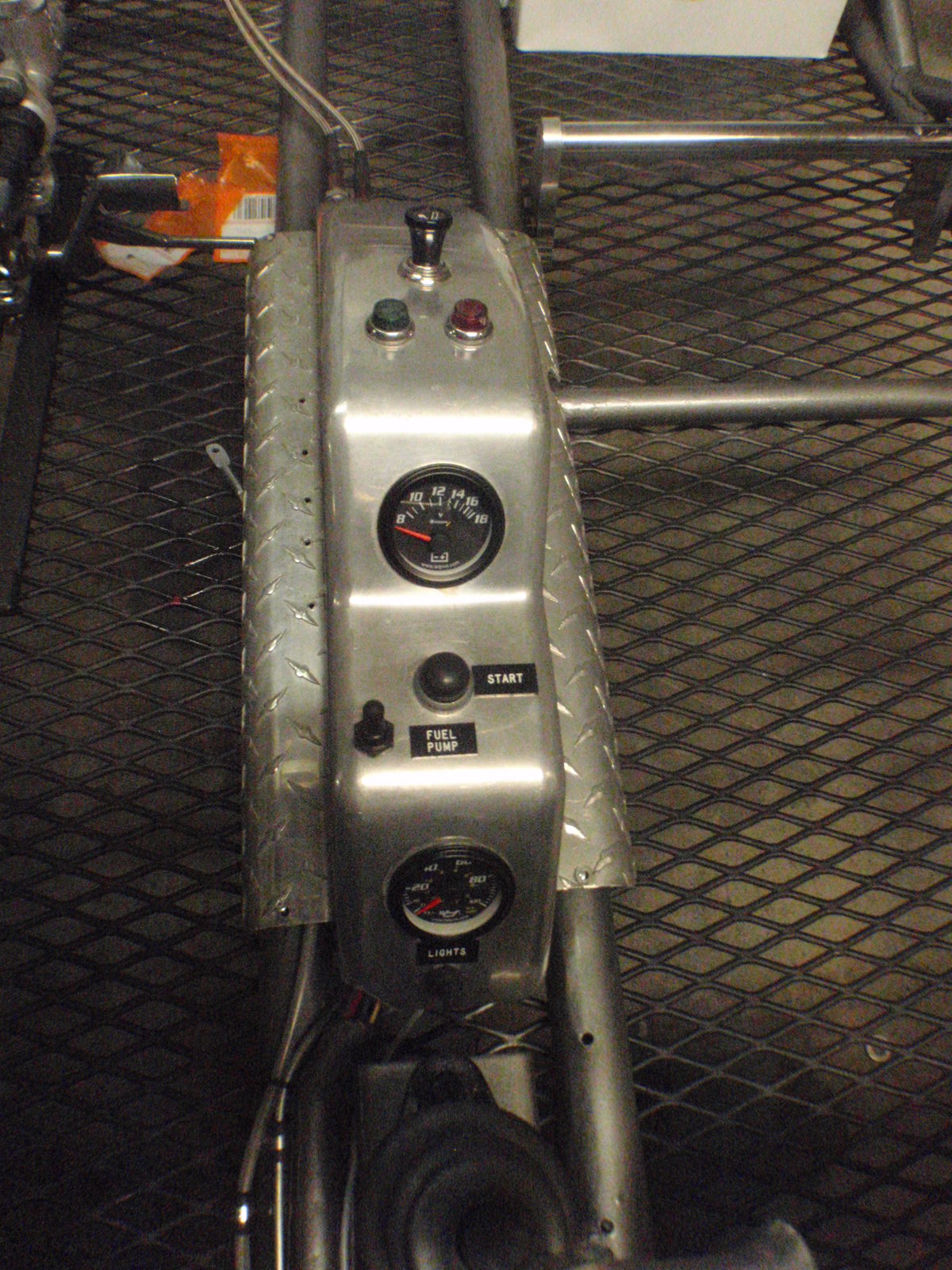

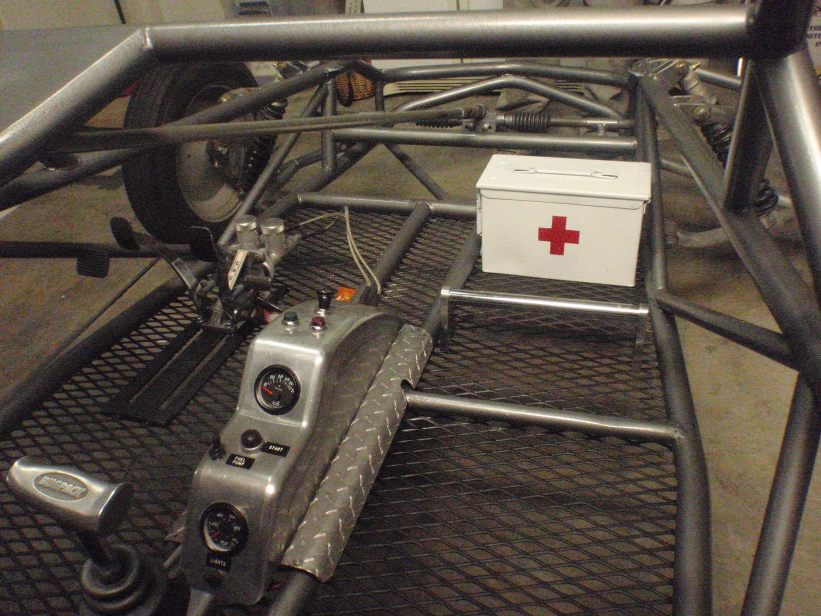

fctryblack84 Posted October 23, 2009 Share Posted October 23, 2009 is that a cigarette lighter i see in the switch panel? Quote Link to comment Share on other sites More sharing options...

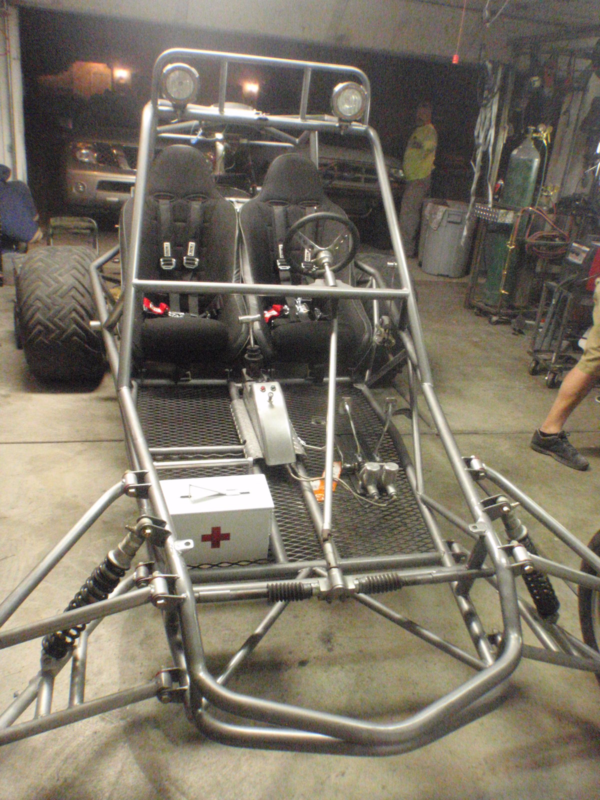

RAGDOLL MX Posted October 23, 2009 Author Share Posted October 23, 2009 it dosent go vroom yet...need to add oil and change trans fluid...and yes thats a ciggerette lighter.. inside the medical box is "Sand rail medical" it contains 1 beer, pack of ciggerettes, lighter, 1 band aid, 3 inches of wire and a loratab... Quote Link to comment Share on other sites More sharing options...

1BADYFZ Posted October 26, 2009 Share Posted October 26, 2009 looks great!!! One question....Does it fit in the new hauler? Quote Link to comment Share on other sites More sharing options...
RAGDOLL MX Posted October 27, 2009 Author Share Posted October 27, 2009 yup it sure does, with plenty of room to spare, were taking off the generator and installing an alternator so it can handle the lighting. the only problem right now is the drain plug in the tranny, it looks like a bolt could fit in it. but we tried that and that will not be good...so if anyone has the right tool then let me know. but other than that it seems to be working out pretty good. Quote Link to comment Share on other sites More sharing options...

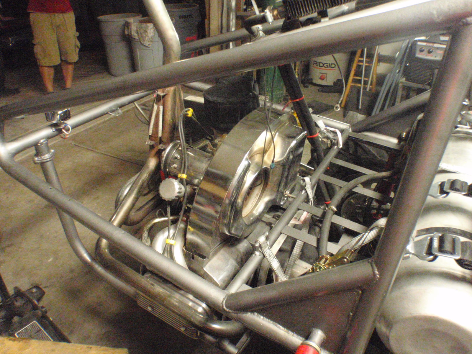

Vegas250rr Posted November 1, 2009 Share Posted November 1, 2009 I am digging your project, looks like a really fun little rail now. I have not seen anyone mention it yet so I will, might think of changing the poly lines to the oil pressure gauge, they don't last long with chaffing, and it looks like its gonna see some through the grate at the bottom of your floor. maybe encase them in some brake line? or go copper tube all the way back I had a Nova some years back and was turned out of tech at the Strip because I had poly lines to my gauge... they were worried about oil downs on the track... got me to thinking... if I could cause a oil down with that teeny tiny little tube, how long would it take to pump all the oil out of my motor... just something to think about Quote Link to comment Share on other sites More sharing options...
RAGDOLL MX Posted November 1, 2009 Author Share Posted November 1, 2009 i have most of the tubing ran through another line with the wiring, but a sheath sounds good too, ill definatley look into it. Quote Link to comment Share on other sites More sharing options...

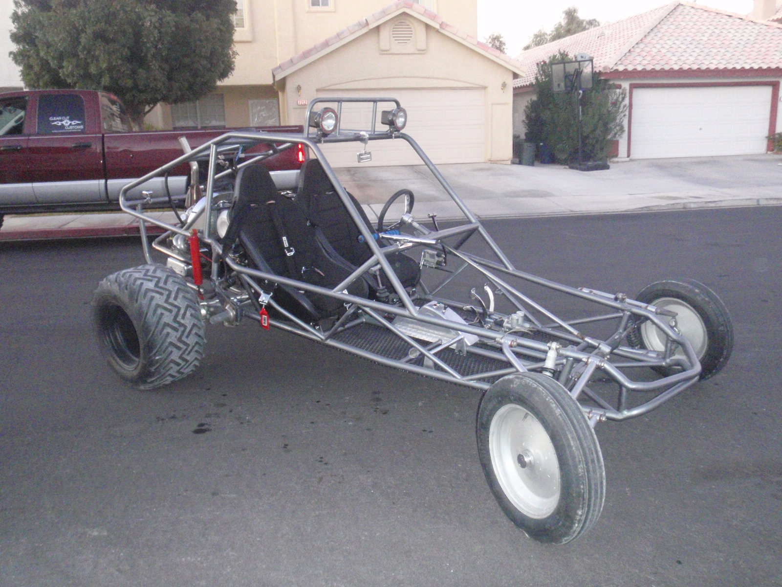

Yoshi Posted November 22, 2009 Share Posted November 22, 2009 I'd highly recommend changing the bracing below the a-pillar, that top side tube will bend pretty quick if you roll it, especially since the lightbar frame is welded to the front top and will apply a good amount of load to the a-pillar..... Quote Link to comment Share on other sites More sharing options...
