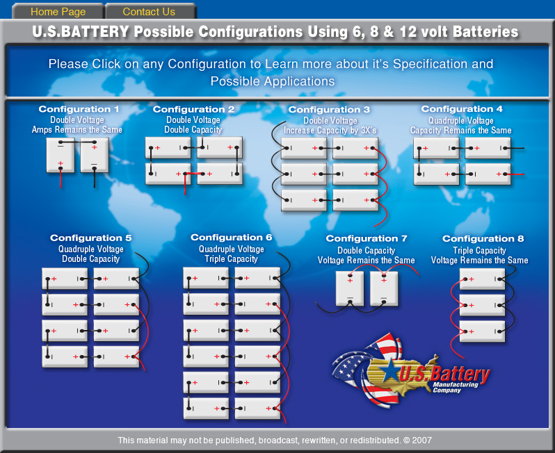

indasand Posted September 26, 2009 Share Posted September 26, 2009 Just an FYI for anyone converting to two 6 volt batteries for the first time. Be sure to hook two 6 volts up in 'series' to get a 12 volt output. If you are running two 12 volt batteries hook them up 'parallel' to get a 12 volt output. Here's some examples: Two 6 volts parallel = 6 volt output Two 6 volts in series = 12 volt output Two 12 volts parallel = 12 volt output Two 12 volts in series = 24 volt output If you are not sure and can't figure it out with a volt meter, then ask someone who knows so you don't stress your coach. R- Can you draw me a picture? j/k ha ha Quote Link to comment Share on other sites More sharing options...
Richard Cheese Posted September 26, 2009 Share Posted September 26, 2009 Can you draw me a picture? j/k ha ha Quote Link to comment Share on other sites More sharing options...
lvnalolife Posted September 29, 2009 Share Posted September 29, 2009 Thought I would pass it on. If anyone wants to convert to 6 volt battery's or get new ones, Sams club has them for $71.00 a piece. I picked up a couple this morning. Nice find. I need new batteries. Wish I would have never switched to 12v's! Time to go back to 6v. Quote Link to comment Share on other sites More sharing options...
foolofsand Posted September 30, 2009 Share Posted September 30, 2009 Can you draw me a picture? j/k ha ha this may help Quote Link to comment Share on other sites More sharing options...

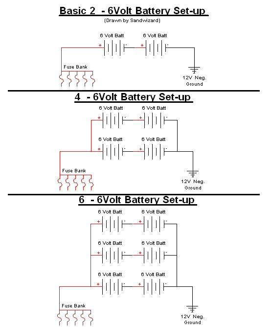

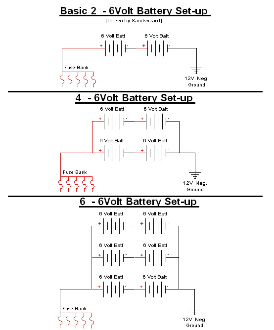

sandrash1 Posted September 30, 2009 Share Posted September 30, 2009 Pretty diagram I use. Quote Link to comment Share on other sites More sharing options...

Jakster884 Posted October 21, 2009 Share Posted October 21, 2009 (edited) Pretty diagram I use. Great info.Thanks Edited October 23, 2009 by Jakster884 Quote Link to comment Share on other sites More sharing options...
