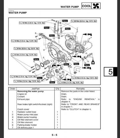

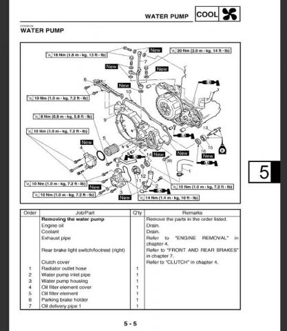

wingnut Posted October 20, 2009 Share Posted October 20, 2009 Here's the part numbers. Bearing~93306-00105-00 (B6001) Large oil seal~93102-11008-00 Small oil seal~93102-12106-00 (SD-12-22-5-HS) Impeller~5GR-12458-00-00 Side case gasket~5TA-15462-00-00 Quote Link to comment Share on other sites More sharing options...
Free Agent Posted October 20, 2009 Author Share Posted October 20, 2009 Here's the part numbers. Bearing~93306-00105-00 (B6001) Large oil seal~93102-11008-00 Small oil seal~93102-12106-00 (SD-12-22-5-HS) Impeller~5GR-12458-00-00 Side case gasket~5TA-15462-00-00 Thanks, I went in Monday and the parts kids was totally lost, had no clue. I'll try my local Yami dealer armed with your parts list today. Appreciate you taking the time to post it. Quote Link to comment Share on other sites More sharing options...
