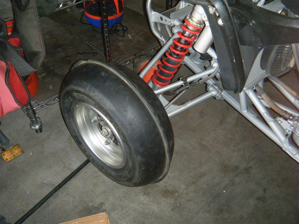

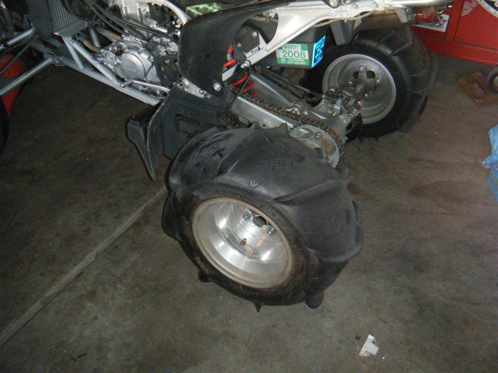

Ok so I am finally ready for my first upgrade!!! :beercheers:
Thanks to Charlie and Mike, I have new tires to try out on Halloween weekend!!
Hoefully this will help me to turn at the faster speeds that I have recently found! :whoop:

Congrats...remember to run about 3-4 psi front and rear...those rears are heavy tires, so stay on the throttle at the tops of the dunes and in the soft stuff or they are going to sink. You should definately be able to tell a difference now, just be careful not to crash while getting use to them ;) .

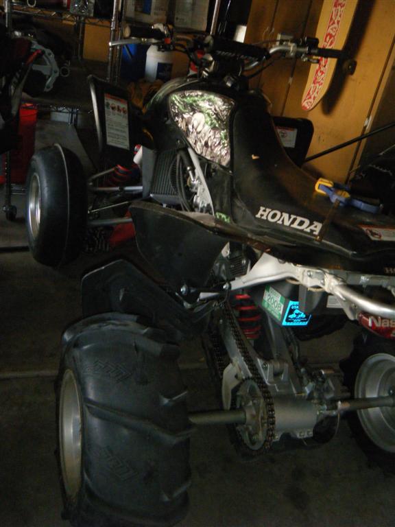

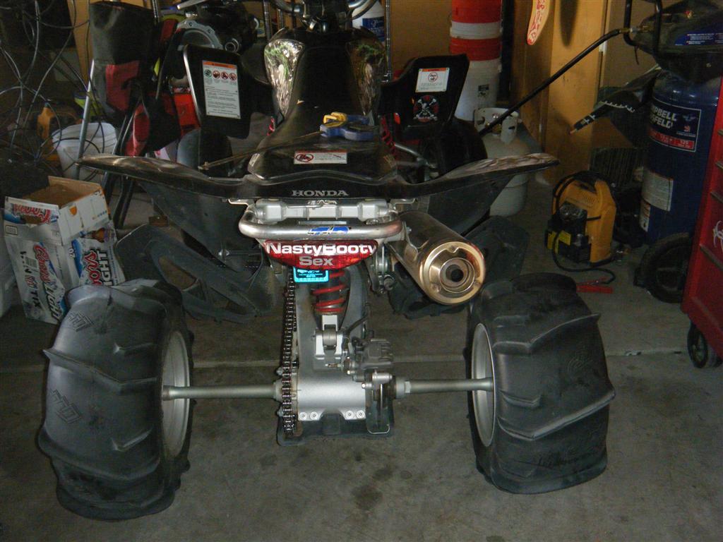

i like that upgrade sticker you have on your back breaklight.... nice touch!!
might as well put an astroglide sticker on your rear fender :old:
You like that? :banghead:
Makes for some GREAT conversation starters out in the dunes as well!! :idea:
I actually finally added some DDR stickers to her and took off the tank graphics! :lol: Verde Power Sports!! That would NEVER make it right!

Just keep the PSI down and you will get around just fine, these just have a different style paddle so they will turn and slide a little differently...not too much since you stayed with a molded V paddle and didn't switch to something completely different like a hauler straight paddle. Those V style paddles do turn better than straight paddles, but they don't climb up the dunes as well so you will still have to work to get up the steep soft stuff and over the razors...so just go faster!! :laughing:
You should be able to tell a difference in the front, those will stay on top of the sand better than the dirt tires and you will be able to turn better.
