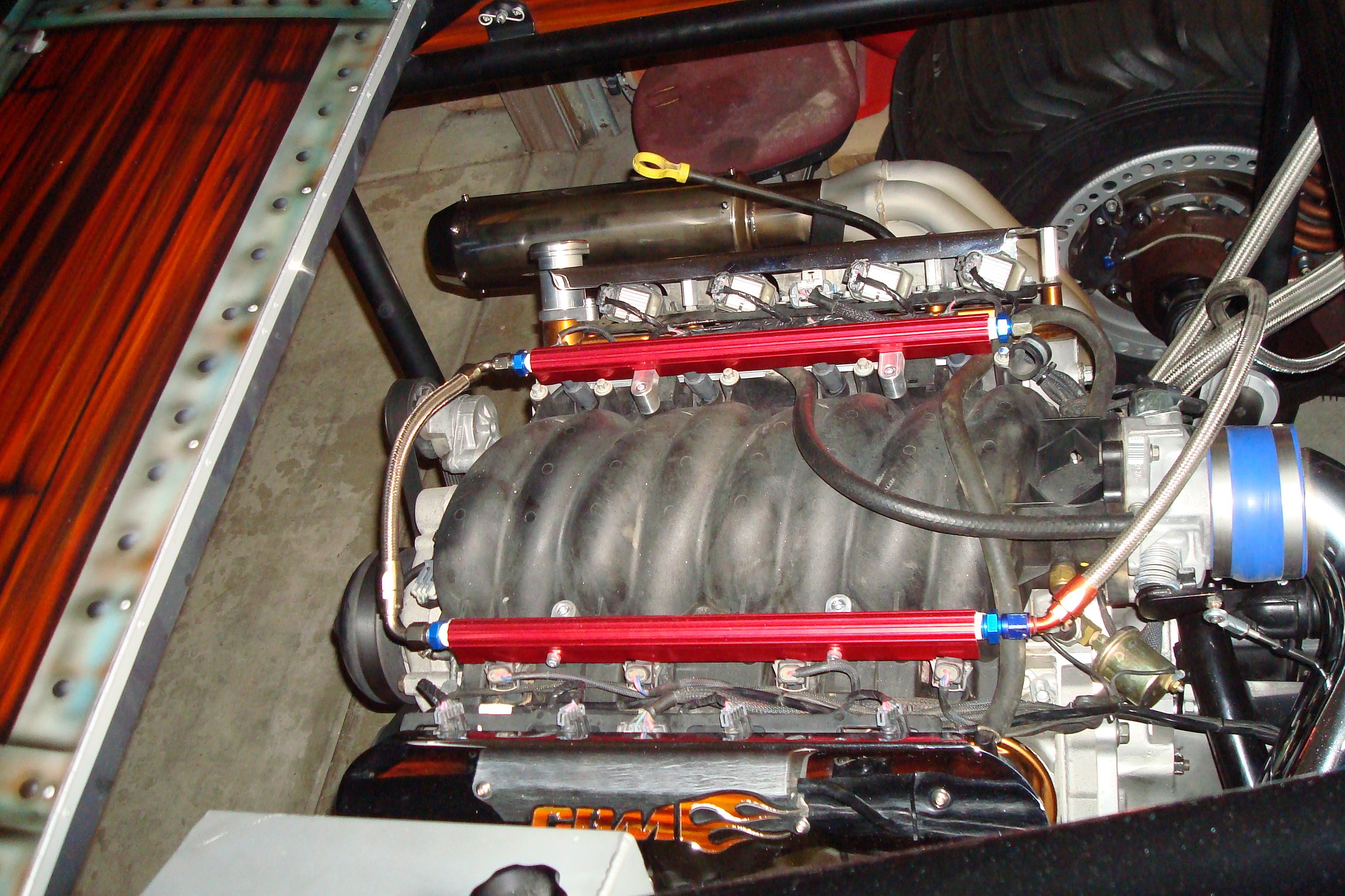

Just Mike Posted October 26, 2009 Share Posted October 26, 2009 I am currently running the car intake on my LS1 and I was wondering what benefit there was to running the truck intake. I have heard that the truck intake gives the motor more torque but wanted to get some opinions of those who have tried the two. Quote Link to comment Share on other sites More sharing options...

barefoot bob Posted October 26, 2009 Share Posted October 26, 2009 i hope i have it right , my info is from cbm, they say the truck intake provides longer runners with its heighth and creates more tourqe . the dis advantages are you have to change your pulley system ( i think) and the water pump. i know for sure going the other direction its a must . i might know someone. who will go straight across his complete system for your complete system. quite honestly, the cheapest way to pull a real benificial power. is to do the head /cam changeout. high tourqe cam , and cnc heads would give you an honest 50 to 75 hp gain depending on the type of cam you can raise the tourqe 40/ 65 ft pnds. for about 2,500 capt 6.o really woke up in the playtech car with a simple cam swap and computer tune. dont quote me but i believe it was right at 1500. << capt can be more exact. either one you get your car dyno tuned to match your combo. bruce told me that is the cheapest bang for the buck the 10 extra or so ft pnds tourque from the truck intake is really not a whole lot noticable. faster daddy ran the truck intake we thought it was the only upgrade and was impressive but as it turns out it was a glenns ls1 motor and had higher compression heads on it. :call cruce at cbm Quote Link to comment Share on other sites More sharing options...

Just Mike Posted October 26, 2009 Author Share Posted October 26, 2009 Well it already has a cam in it so I guess the next step would be to get some heads. That will have to wait. I might call Bruce and see about getting it tuned. Maybe that will give me a few extra ponies. I have access to a truck intake. Just wanted to know if it was worth doing. Thanks for the replies. Quote Link to comment Share on other sites More sharing options...
barefoot bob Posted October 27, 2009 Share Posted October 27, 2009 I dont see why you would have to change the w-pump and pulleys thats why i said im not positive, but i know for a fact to go to the drop intake or car intake you have to change out the truck pullies, << we went through it on davids car. and the water pumps are different because of the accesorie locations. just visualizing it seems you could just slap it on :kissass: so maybe its just the other way around the throttle boddy hits the belt. :surrender: Quote Link to comment Share on other sites More sharing options...
sanddunesaddict Posted October 27, 2009 Share Posted October 27, 2009 thats why i said im not positive, but i know for a fact to go to the drop intake or car intake you have to change out the truck pullies, << we went through it on davids car. and the water pumps are different because of the accesorie locations. just visualizing it seems you could just slap it on so maybe its just the other way around the throttle boddy hits the belt. :surrender: I am not doubting you Bob I just think you guys got took. The only difference in the waterpump is the upper rad hose either comes out the front on cars or out the top for trucks but either would hit anything. Unless its a different belt routing for a sand car because the stock stuff would be fine. Quote Link to comment Share on other sites More sharing options...
barefoot bob Posted October 28, 2009 Share Posted October 28, 2009 I am not doubting you Bob I just think you guys got took. The only difference in the waterpump is the upper rad hose either comes out the front on cars or out the top for trucks but either would hit anything. Unless its a different belt routing for a sand car because the stock stuff would be fine. i know the throttle body interferes with the truck system pullies adding the lower rise intake the truck pump if im not mistaken extends further out to the right than the car system power steering sits down low on the truck system where the car system sits high and alt sits low. but you are probably right adding the truck intake would raise it on a pully system that already sits lower so there shouldnt be a problem Quote Link to comment Share on other sites More sharing options...

Just Mike Posted October 28, 2009 Author Share Posted October 28, 2009 I don't think I could put the truck intake on because the air filter intake hose would not clear my wing. Quote Link to comment Share on other sites More sharing options...
