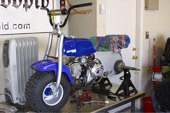

EY3BA11 Posted December 29, 2009 Share Posted December 29, 2009 is it just me or is your front fender on backwards? Quote Link to comment Share on other sites More sharing options...
dunefreak Posted December 29, 2009 Author Share Posted December 29, 2009 peewee the pinstriper said: I'm so goin to hell fer this!!! but i had to join in on the fun!!! You guys are a-holes! I love it. ISBB said: is it just me or is your front fender on backwards? Nope, it's just you. Quote Link to comment Share on other sites More sharing options...

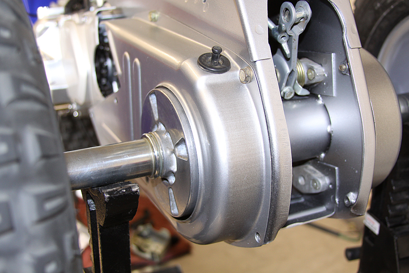

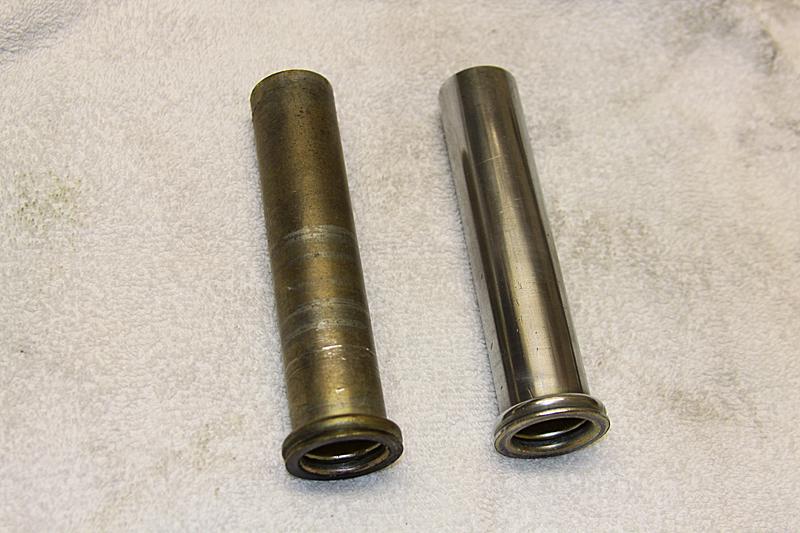

dunefreak Posted January 8, 2010 Author Share Posted January 8, 2010 Well not much progress yet...I'm still waiting on more parts. They should be here today or monday. I can't wait to fire this thing up and ride it. I polished up the axle tubes. Quote Link to comment Share on other sites More sharing options...

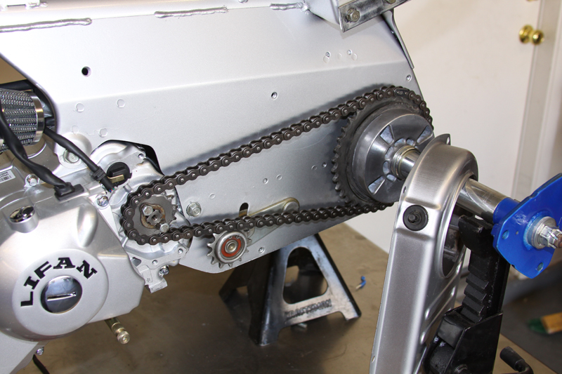

dunefreak Posted January 8, 2010 Author Share Posted January 8, 2010 mineurbiz said: I would like to see the Lifan 110 run against Coles 88, I am on the fence about doing the 88 kit or a motor swap. I have seen some 88's run, but they were just the jug and piston. I am waiting to see how the 88 with race head, cam, bigger valves, bigger carb and exhaust does. We shall see hopefully very soon! POULE43 said: GREAT JOB and AWESOME going with Blue / Blue 70's are the best 70's no matter what anyone says!....They just are! Gear it at 15 36 / you will love the Lifan......GITRDONE (Scott) geared his at 14 36 and loves it / I am gonna ride it next time out! Anyway, LOOKS SWEET...looking forward to meeting you guys at Dumont! Andy Thanks Andy! Good info there. I need to get a sprocket too so that info helps a bunch. I have a few things to do still like get a pipe, mod the footpeg bar, and finish building my battery holder. It is coming along great though. I am so stoked to hear this this run and most of all to just hit that button to fire it up instead of the ol skool pull start. Quote Link to comment Share on other sites More sharing options...

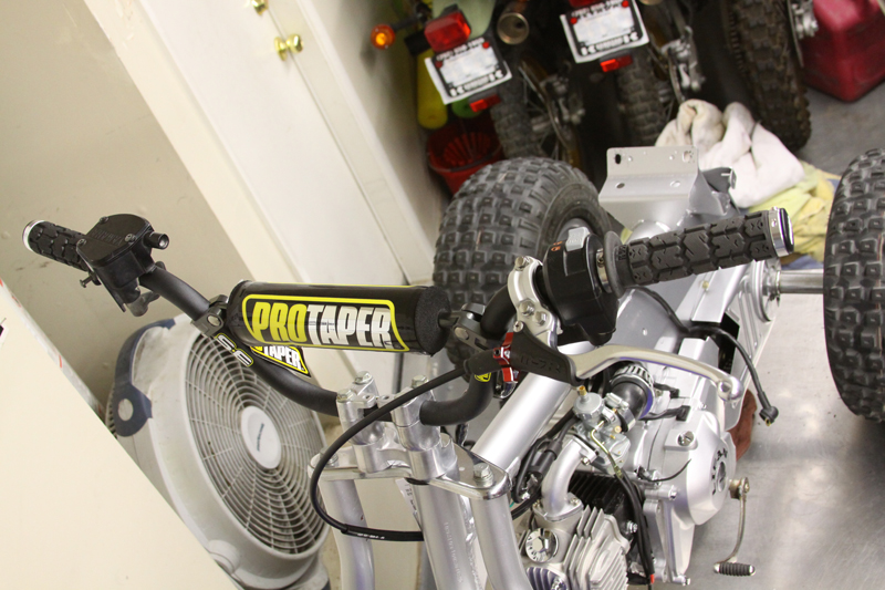

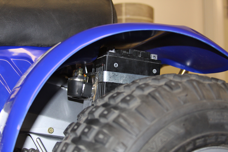

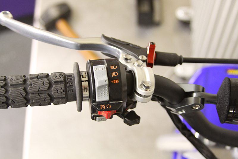

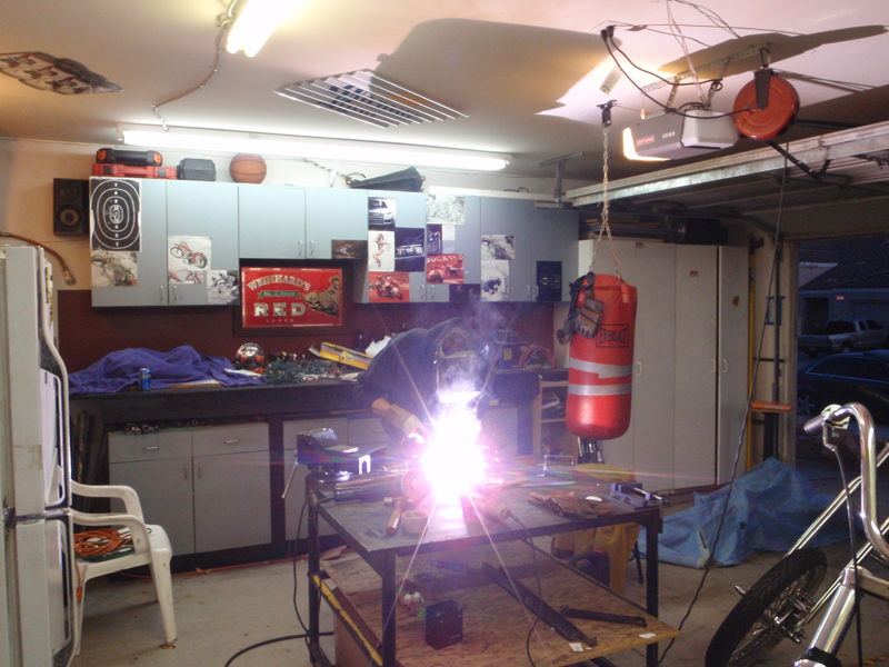

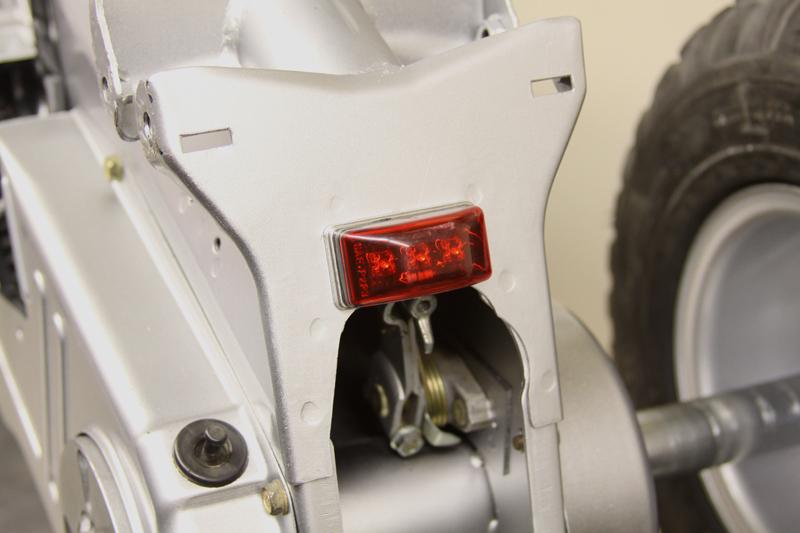

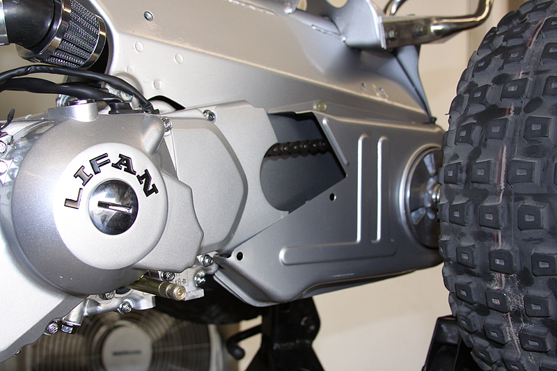

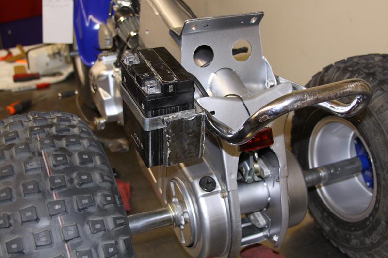

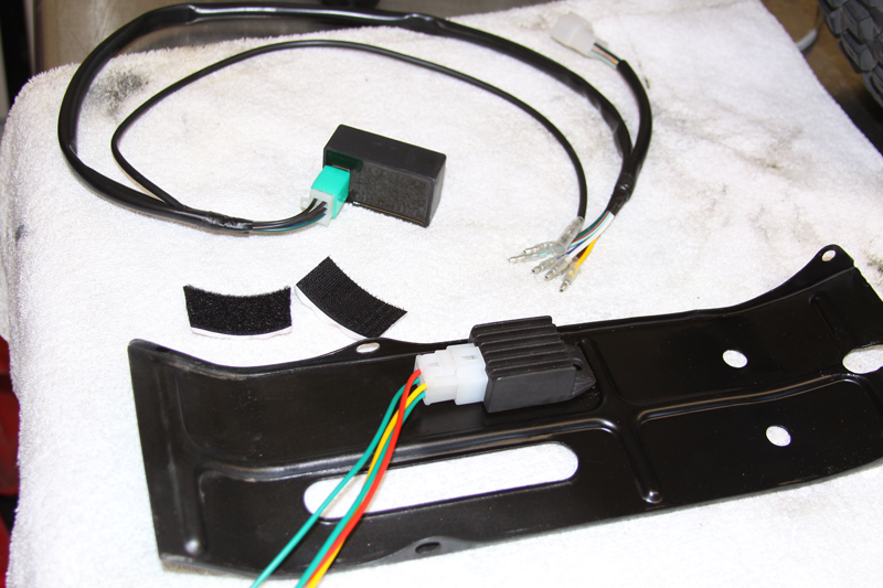

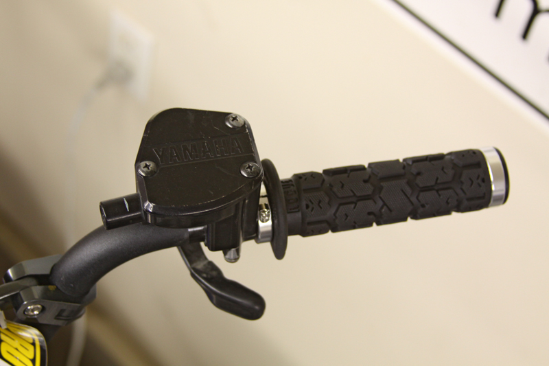

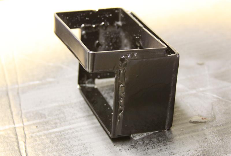

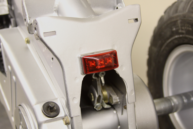

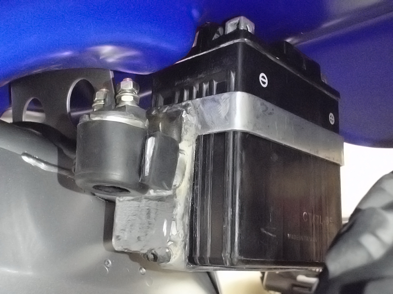

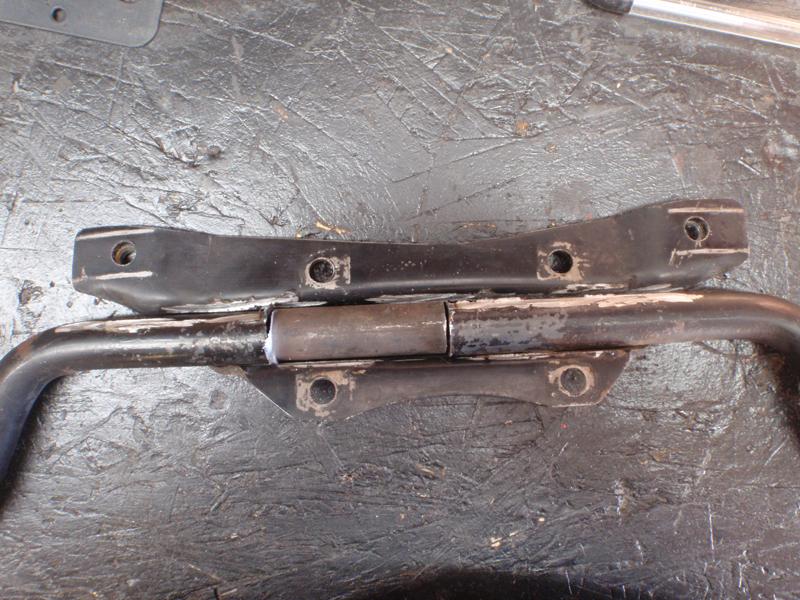

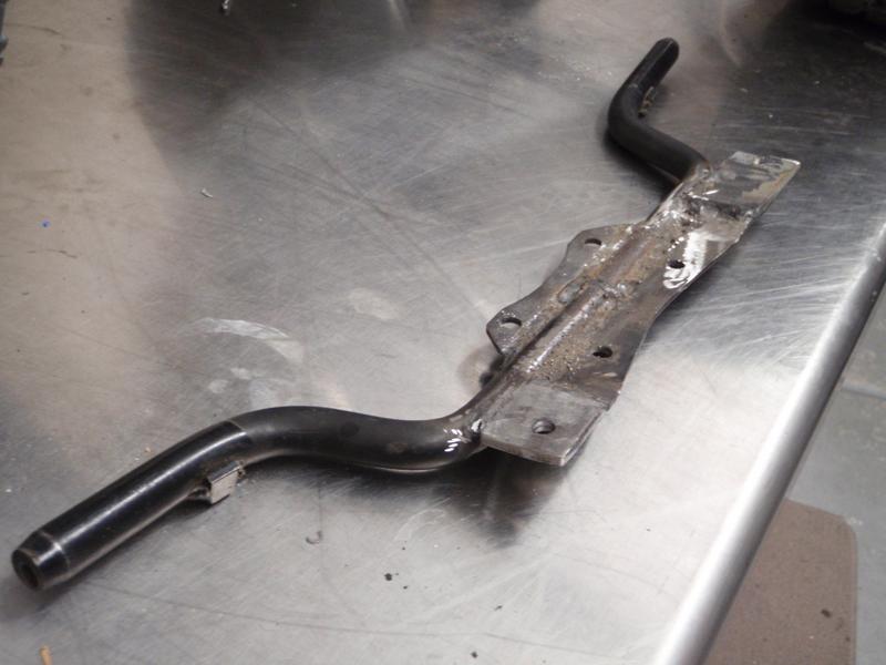

dunefreak Posted January 11, 2010 Author Share Posted January 11, 2010 progress progress progress New chain and sprockets installed... I started mounting the electronics on the skid plate to go up in the frame... My buddy Tommy giving me a hand with some welding on my battery tray I fabbed up... My custom battery tray with starter relay mount. Here's where it will mount... I also widened the footpegs and made new tabs so I could still run the factory heel gaurds. Badass Rouge grips on Pro Tapers. I am running all Yamaha stuff like Raptor thumb throttle and Raptor headlight/ starter/ kill switch for the electric start. And then drilled a hole so I could hide the wire for the LED tail light Quote Link to comment Share on other sites More sharing options...

dunefreak Posted January 12, 2010 Author Share Posted January 12, 2010 RAGDOLL MX said: that looks bad a$$ Pete, i cant wait to see it all together! glad tommy could get it welded up for ya! it looks great!!!! Thanks Cole! Yeah it was just easier to cruise down to Tommy's with some beer and hook it up. It's coming together pretty well now. I got my throttle cable and intake adapter today. I just have to run down to 50cal's and grab a pipe, then wire it up. That's pretty much about it. I'm gettin stoked. Quote Link to comment Share on other sites More sharing options...
2Extreme Posted January 12, 2010 Share Posted January 12, 2010 That's coming along quickly. I like the battery mount idea... better than the hidden mount on the skid plate that I've seen before. Quote Link to comment Share on other sites More sharing options...
dunefreak Posted January 12, 2010 Author Share Posted January 12, 2010 2Extreme said: That's coming along quickly. I like the battery mount idea... better than the hidden mount on the skid plate that I've seen before. Thanks. It seemed so much easier and more conveinant for battery access this way. I'm suprised I have never seen it mounted there before. You can't even really see it when the bike is on the ground. I have seen 6 pack rack mounts too but that looks like crap I think. Quote Link to comment Share on other sites More sharing options...

dunefreak Posted January 14, 2010 Author Share Posted January 14, 2010 Richard Cheese said: lookin badass Pete!!! do you think those rogue grips would fit my DS handle bars? i noticed they were for bmx and not atvs? As long as they are 7/8" bars, hell yeah. Chad has them on his Raptor. I'm getting another set for my Raptor as well. Their badass. I never heard of them for bmx and not atv. wingnut said: They come in diff. lengths. make sure you buy the longest ones they sell and you'll be fine. They do? I bought mine from Rocky Mountain and only saw one size. Then again, I think I might have input or selected Raptor machine when it asked. Quote Link to comment Share on other sites More sharing options...
