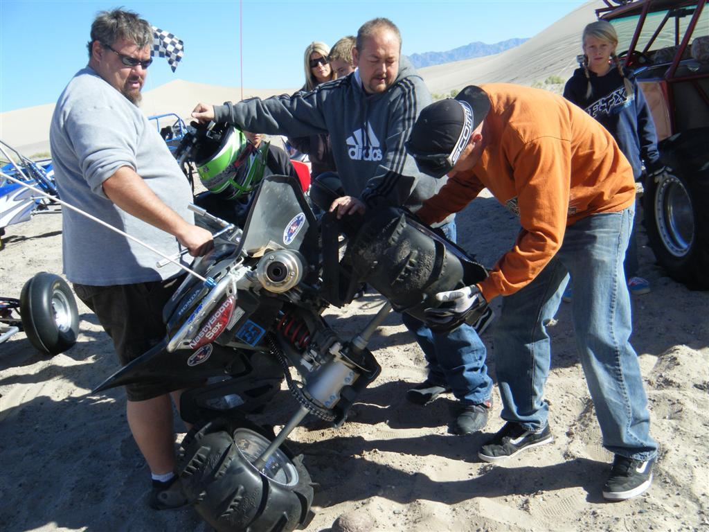

Foxysandchick Posted December 16, 2009 Share Posted December 16, 2009 (edited) I think you're talking about my post...Dunelover was riding a Raptor 700 with the ITP Sandstar set-up and having a hard time, we put Skat Trak Extremes 21x12x8 (I think, can't check right now) 8 paddles on Douglas Blue Label 8" rims and she was able to go everywhere. She said one of the biggest differences was how the rear end didn't get squirrelly on her when side hilling and she didn't slide around so much or feel like she had to fight with the bike. I suggest 21" Extremes on 8" rims with 8 paddles. But I don't think you would see a significant difference in the Haulers or Extremes if you found a good deal on one or the other then go for it. I'm sure others will chime in with more 'technical' info, but for overall duning and improvement on your ride quality look for some Skat Trak straight paddles used and don't be overly concerned with haulers or extremes, 8/9/10" rims, etc. I was going to suggest you check out the Yamaha and Raptor forums, but saw that you already are . Good deal here> http://lasvegas.craigslist.org/mcy/1496723349.html Edited December 16, 2009 by Foxysandchick Quote Link to comment Share on other sites More sharing options...

Sand_YFZ Posted December 16, 2009 Share Posted December 16, 2009 I think you're talking about my post...Dunelover was riding a Raptor 700 with the ITP Sandstar set-up and having a hard time, we put Skat Trak Extremes 21x12x8 (I think, can't check right now) 8 paddles on Douglas Blue Label 8" rims and she was able to go everywhere. She said one of the biggest differences was how the rear end didn't get squirrelly on her when side hilling and she didn't slide around so much or feel like she had to fight with the bike. I suggest 21" Extremes on 8" rims with 8 paddles. But I don't think you would see a significant difference in the Haulers or Extremes if you found a good deal on one or the other then go for it. I'm sure others will chime in with more 'technical' info, but for overall duning and improvement on your ride quality look for some Skat Trak straight paddles used and don't be overly concerned with haulers or extremes, 8/9/10" rims, etc. I was going to suggest you check out the Yamaha and Raptor forums, but saw that you already are . Good deal here> http://lasvegas.craigslist.org/mcy/1496723349.html Those are 20x10x10's pictured Quote Link to comment Share on other sites More sharing options...
