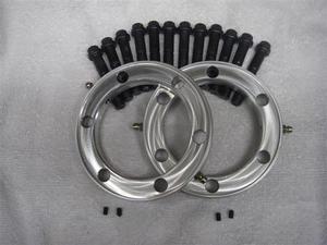

Just Mike Posted February 10, 2010 Share Posted February 10, 2010 I decided to take a look at my CV's today since they were making a bit of noise. I figured they had to have plenty of grease since I just serviced them at the beginning of the season. I was very surprised to find out that they were almost dry. I am very impressed that the KAR TEK CV's held up so well being that dry. Any way I have been wanting to get some of these greasing spacers for a while but just didn't have the extra cash to do it. After I saw what I did today I went ahead and ordered them. They look like they should work well. Quote Link to comment Share on other sites More sharing options...

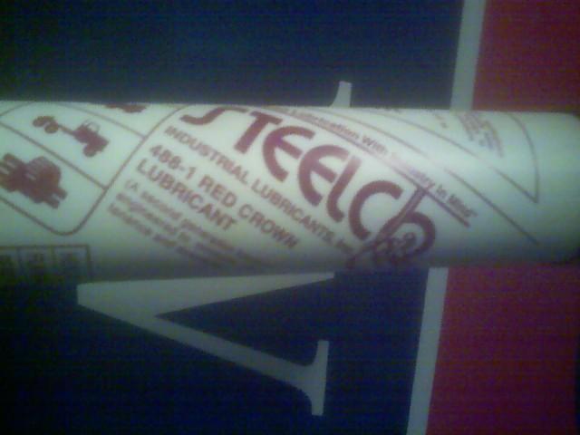

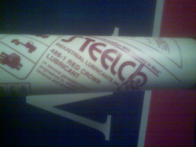

dunefreak Posted February 10, 2010 Share Posted February 10, 2010 Your biggest investment would be STEELCO grease. It's that really thick stringy red chit. We use it at the dealership on stuff like slip yokes. That chit doesn't break down and holds up under more abuse that our cars could ever put it through. Never used those grease and go spacers, but I guess they make sense if you run the cheaper grease. lol Quote Link to comment Share on other sites More sharing options...

SAND~~SNAKE Posted February 10, 2010 Share Posted February 10, 2010 I had to do some polishing to my cages and I can honestly say it was hard as hell to get it out of my cv's! Its the sh*t! Quote Link to comment Share on other sites More sharing options...

sanddunesaddict Posted February 10, 2010 Share Posted February 10, 2010 I have been preaching this stuff for a very long time. Its far superior to any other grease out there...It is overkill for CV applications and thats why its bitchen!!!! Quote Link to comment Share on other sites More sharing options...

dunefreak Posted February 10, 2010 Share Posted February 10, 2010 2 tubes of the STEELCO should be more than enough for 4 CV's. You don't needd that much in each CV and you don't pack the boots like some people think you have to. Quote Link to comment Share on other sites More sharing options...
Just Mike Posted February 10, 2010 Author Share Posted February 10, 2010 2 tubes of the STEELCO should be more than enough for 4 CV's. You don't needd that much in each CV and you don't pack the boots like some people think you have to. I don't pack the boots but I do like to pack the cups. Quote Link to comment Share on other sites More sharing options...
SAND~~SNAKE Posted February 10, 2010 Share Posted February 10, 2010 (edited) 2 tubes of the STEELCO should be more than enough for 4 CV's. You don't needd that much in each CV and you don't pack the boots like some people think you have to. ^^^^^^^^^^^^ What he said...I used a grease needle and had enough for all 4 cv's...if your thrifty w/ it... We do have a couple of tubes at work if anyone is interested...? I got the parts manager to order this stuff and told him once the sandrail guys of vegas find out its there it will be gone fast and he said no problem...will just order some more... Edited February 10, 2010 by SAND~~SNAKE Quote Link to comment Share on other sites More sharing options...
Just Mike Posted February 10, 2010 Author Share Posted February 10, 2010 ^^^^^^^^^^^^ What he said...I used a grease needle and had enough for all 4 cv's...if your thrifty w/ it... We do have a couple of tubes at work if anyone is interested...? I got the parts manager to order this stuff and told him once the sandrail guys of vegas find out its there it will be gone fast and he said no problem...will just order some more... So you used 2 tubes on 930's? Quote Link to comment Share on other sites More sharing options...
SAND~~SNAKE Posted February 10, 2010 Share Posted February 10, 2010 So you used 2 tubes on 930's? I used 1 full tube and 1/4 of the second and I think i wasted some.... Quote Link to comment Share on other sites More sharing options...
Just Mike Posted February 10, 2010 Author Share Posted February 10, 2010 I used 1 full tube and 1/4 of the second and I think i wasted some.... OK I guess 2 should be ok for the 934's then Quote Link to comment Share on other sites More sharing options...
SAND~~SNAKE Posted February 11, 2010 Share Posted February 11, 2010 OK I guess 2 should be ok for the 934's then I think that would cover it.. Quote Link to comment Share on other sites More sharing options...
