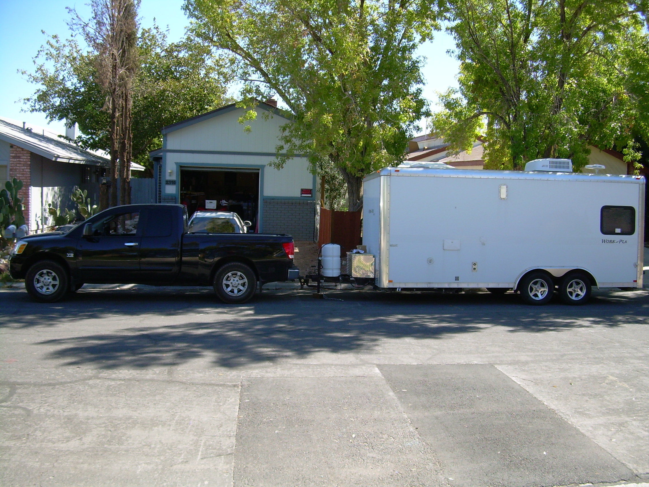

ricepow Posted February 17, 2010 Share Posted February 17, 2010 So I'm looking to buy a used toy hauler and hoping all the knowledge and experience you guys have can help me make the right decision. Basically my budget and needs are causing me to look towards the Weekend Warrior FS2300. I have a 2009 Nissan Titan with the tow package and intend to have a 4 seater long travel Rhino in the trailer. Not looking to get a different vehicle, so this is the vehicle I am working with. My budget is putting me in the area of the 2005 FS2300, as I am looking to pay cash and do not want a payment. If I found a stellar deal or saved a bit more I may be able to snag a 2006. Apparently there are some differences between the 2005 and 2006, one of which is a larger generator, Onan 2800 vs Onan 4000. Not sure if there may also be a larger AC or heater making the larger generator necessary, or they just decided to put a bigger one in, maybe somebody here knows. I guess my major question is, will the 2005 serve the purpose or are there changes that were made in 2006 that make it worth going for. And of course any other information you guys can give me would be great. Thanks. Quote Link to comment Share on other sites More sharing options...
Richard Cheese Posted February 17, 2010 Share Posted February 17, 2010 (edited) I am more concerned about your truck holding up over a few duning seasons towing the fs23 from the research i got, it showed your truck has a tow cap of 9300, while the fs2300 dry is around 5k empty, and maxs out at a gvwr of 9k i would be worried about the wear and tear on your truck...not that i wouldnt worry about the wear and tear of any 1/2 ton towing a toy hauler I first started towing with my wife's tahoe, my attitude fk 19 there were times i was completely worried about breaking down because of the strain and stress towing the hauler put on the power train. however, if you are dead set on this, just drive very easy, and avoid big hills if you can BTW...go wit the 2006 and the 4k genny you cannot run a microwave with the 2800 you also need to think about things like the number of people you plan on taking with you, as well as the size of the bathroom, water capacities, etc with my two kids , my wife and myself, we easily rip through 150 gallons of fresh water in a weekend...as we are not the best conservers I think the hauler you are looking at has a capacity of around 60 to 80 gal of fresh water? Edited February 17, 2010 by Richard Cheese Quote Link to comment Share on other sites More sharing options...

vegas style Posted February 17, 2010 Share Posted February 17, 2010 i tow a small hauler with my 04 nissan titan 4x4. it has enough power but you WILL need overload springs or airbags. the weak point on my truck is the brakes and rear end. think your 09 shouldnt have those problems. by the way im shopping for a duramax right now because i work the titan to hard! Quote Link to comment Share on other sites More sharing options...

ricepow Posted February 17, 2010 Author Share Posted February 17, 2010 Richard Cheese said: I am more concerned about your truck holding up over a few duning seasons towing the fs23 from the research i got, it showed your truck has a tow cap of 9300, while the fs2300 dry is around 5k empty, and maxs out at a gvwr of 9k i would be worried about the wear and tear on your truck...not that i wouldnt worry about the wear and tear of any 1/2 ton towing a toy hauler I first started towing with my wife's tahoe, my attitude fk 19 there were times i was completely worried about breaking down because of the strain and stress towing the hauler put on the power train. however, if you are dead set on this, just drive very easy, and avoid big hills if you can BTW...go wit the 2006 and the 4k genny you cannot run a microwave with the 2800 you also need to think about things like the number of people you plan on taking with you, as well as the size of the bathroom, water capacities, etc with my two kids , my wife and myself, we easily rip through 150 gallons of fresh water in a weekend...as we are not the best conservers I think the hauler you are looking at has a capacity of around 60 to 80 gal of fresh water? Hey, thanks for the response. Like you I am somewhat concerned that I will be close to my max tow rating. I have spoken with other people who have this identical setup and they seem to feel it does ok with the use of a proper hitch/weight distribution setup, as well as some are using airbags. Obviously these do nothing for the power of the truck, but they feel its manageable. I dont intend on trying to break any speed records (manual advises to tow at speeds no greater than 60) and would be cautious, and to be totally honest, I really dont get out as much as I would like, so the truck will not see heavy amounts of use towing the trailer. Not trying to convince you to support the idea, lol. Maybe sometime in the far future I would consider a diesel, but this truck only has about 10k miles on it so I plan to keep it for a while, and if something happens.....well I guess its covered under warranty as long as i dont exceed its advertised tow specs. The main reason I am looking at this trailer, is that it is the lightest, front sleeper I can find and afford, as well as having the amount of cargo space needed for the Rhino. I just really like the idea of the front sleeper and it seems like other trailers that are smaller weigh close to the same, so why not just get the larger trailer. I appreciate the input on the generator, I am pretty ignorant about these things right now. As far as the fresh water, they come with a 100 or 105 gallon tank, so I think Ill be ok with that. Just have to not go crazy. Any other info you guys have I really appreciate it. Quote Link to comment Share on other sites More sharing options...

EY3BA11 Posted February 17, 2010 Share Posted February 17, 2010 if your going to tow with the titan get the Deep trans pan that is offered.. it will be worth it. There are a few people with titans towing similar and have done fine over the years.. Also i would suggest getting the trailer weighed they are pigs and no where near their listed weight. Im willing to lay odds a decently loaded trailer empty will be around 7k plus water gear and rhino you will probably be exceeding your truck and trailers GVWR.. I would find a nice short front bath model something smaller and lighter if it were me. Quote Link to comment Share on other sites More sharing options...
ricepow Posted February 17, 2010 Author Share Posted February 17, 2010 (edited) ISBB said: if your going to tow with the titan get the Deep trans pan that is offered.. it will be worth it. There are a few people with titans towing similar and have done fine over the years.. Also i would suggest getting the trailer weighed they are pigs and no where near their listed weight. Im willing to lay odds a decently loaded trailer empty will be around 7k plus water gear and rhino you will probably be exceeding your truck and trailers GVWR.. I would find a nice short front bath model something smaller and lighter if it were me. I started looking at some of the smaller Eclipse Attitude trailers and Extreme MegaLite trailers. Did some reading on another forum and sounds like WW had some significant frame and tongue issues I'd prefer not to deal with, so maybe I should look at some other brands. I know there is another post very similiar to this where somebody is asking for suggestions on a 1/2 ton towable TH, but can you guys maybe give some suggestions based on the information provided as to what you feel would be good. Not really interested in the Carson based on them not having the on-board generators and I really dont want to be crammed in a 16ft trailer. Id rather have to slow poke it on the way there than be miserable once I got there, but at the same time I dont want to jeopordize my families safety. Edited February 17, 2010 by ricepow Quote Link to comment Share on other sites More sharing options...
