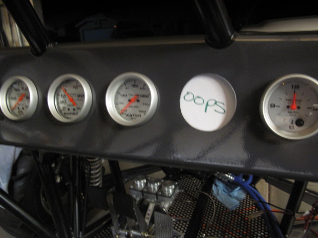

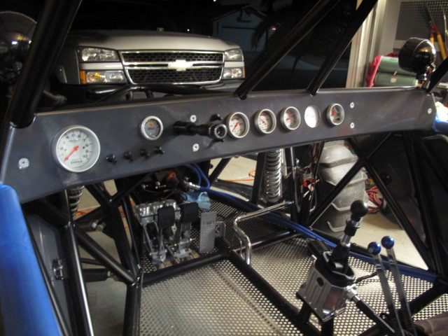

sanddunesaddict Posted October 5, 2010 Author Share Posted October 5, 2010 Ok well I and a couple friends have been burning the midnight oil. So sorry there has been no update.Im just trying to get her done asap. Power steering system filled and bled. Fuel lines all made and mounted up. Picked up a few Axial Alloys clamp systems at the SSSS.These are very nice pieces and work very well. Got rid of those ugly a$$ fabricated polished aluminum valve covers and picked up some very clean looking Buick logo ones with a Turbo 6 emblem on the other side. Car also has plenty of WHOA!!! now I just need some GO!!!! Finished bleeding the brakes tonight.Got some of the smoked cover brake lines.They look sharp. Installed a Jamar park lock and a brake switch. We got rid of all the crap we do not need out of the engine harness.As soon as I get the balls to mount my guages because I am an idiot and didnt cut the holes before powder we can start stringing wires. Also got my new steering tires mounted and installed on the car!!!! I think they look great. Quote Link to comment Share on other sites More sharing options...

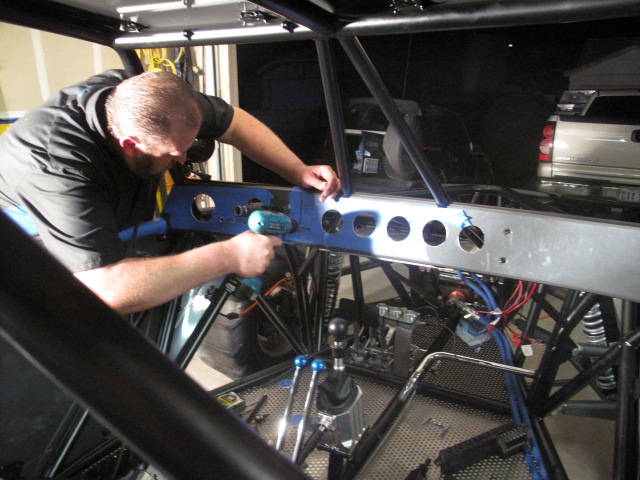

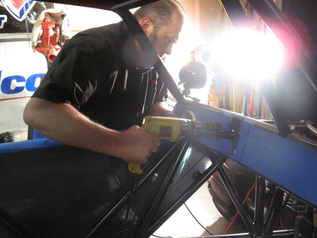

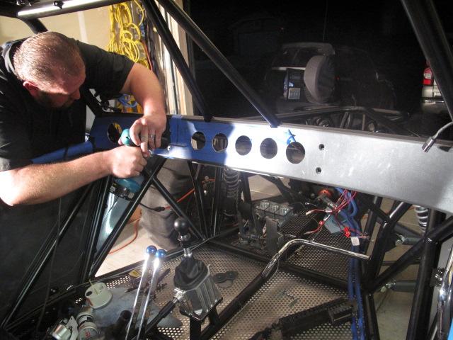

barefoot bob Posted October 5, 2010 Share Posted October 5, 2010 and now for the obvious questions, why are your paddles on the front?? why didnt you turn your gauges over and trace the circle. or is that a new style gauge ?? im not knockin babert . the car looks good just en ya Quote Link to comment Share on other sites More sharing options...
sanddunesaddict Posted October 5, 2010 Author Share Posted October 5, 2010 those are Jims paddles.I took the from tires off so I can get the beadlcok rings powder coated and I dont have any desert tires yet.LOL I can trace the guages but then the hole would be too big as the bezel is larger than the guage.I am just scared of screwing up the powder coat.I am going to do it tonight though. Quote Link to comment Share on other sites More sharing options...

EY3BA11 Posted October 5, 2010 Share Posted October 5, 2010 lots of painters tape and patience.. Make sure you have everything exactly marked and where you want it and that the holes are the proper size You can always cut em smaller but too big and yer fk'd Quote Link to comment Share on other sites More sharing options...

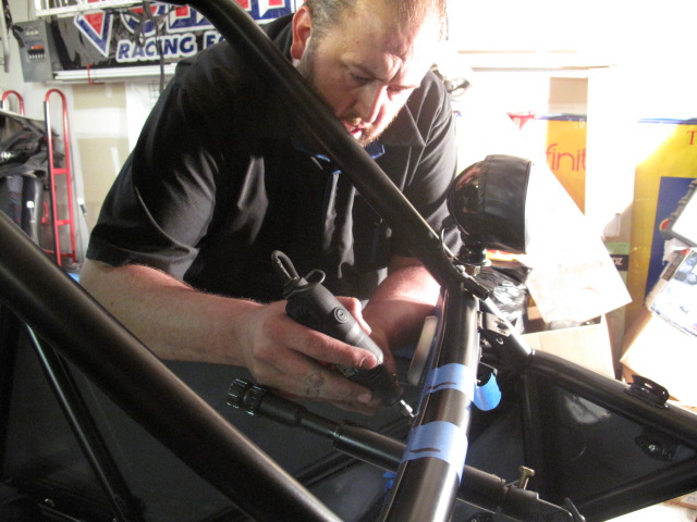

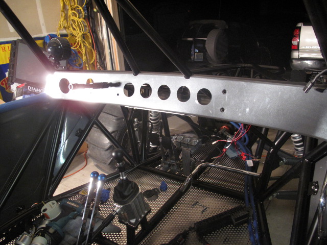

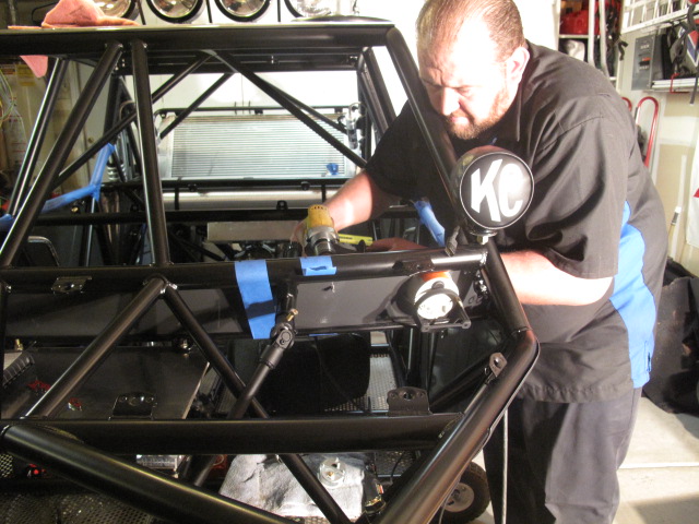

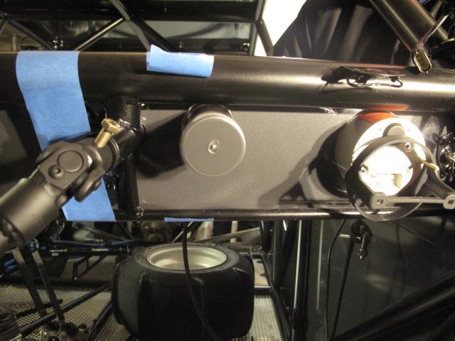

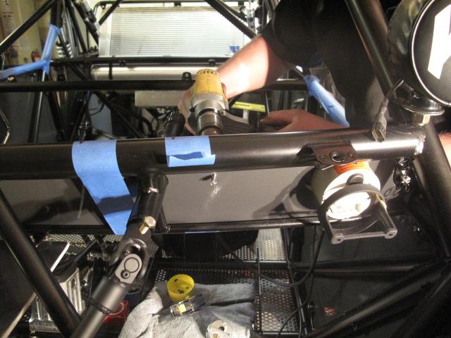

sanddunesaddict Posted October 6, 2010 Author Share Posted October 6, 2010 I think i need to start drinking after doing those guages. It came out awesome though. Thanks for the pics Jim. Quote Link to comment Share on other sites More sharing options...
