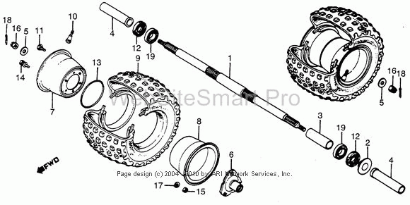

jorgeloco Posted March 31, 2010 Share Posted March 31, 2010 Okay guys I need some one to tell me how to take apart the rear axle, the brake hub and the chain sprocket on my 70. I am at a lost, so any help will be appreciated Quote Link to comment Share on other sites More sharing options...
Jakster884 Posted March 31, 2010 Share Posted March 31, 2010 Jorge, Everything you need is here in the Honda 70 Section. Look on the top section and click on the shop Manual. It gives detailed information on how to remove the rear axel and basically the complete :atc: Good luck. Quote Link to comment Share on other sites More sharing options...
tmas Posted March 31, 2010 Share Posted March 31, 2010 Take off the axle nuts and everything should slide apart. The drum will likely be seized on the axle shaft so if it is remove it attached to the axle on that side of the trike.Check attachment. tmas Quote Link to comment Share on other sites More sharing options...
jorgeloco Posted March 31, 2010 Author Share Posted March 31, 2010 yup I got all those parts out I just need to take the sprocket out and the brake hub out. I did see any set screws that hold those two things together to the shaft I'll take another lookie at the manual again thanks guys Quote Link to comment Share on other sites More sharing options...
tmas Posted March 31, 2010 Share Posted March 31, 2010 What year? There are no screws the brake drum and sprocket hub slide onto the splines of the axle shaft.They could be rusted onto the shaft. tmas Quote Link to comment Share on other sites More sharing options...
jorgeloco Posted March 31, 2010 Author Share Posted March 31, 2010 What year? There are no screws the brake drum and sprocket hub slide onto the splines of the axle shaft.They could be rusted onto the shaft. tmas yeah I figuered out I need to get a gear puller thanks man Quote Link to comment Share on other sites More sharing options...
tmas Posted April 1, 2010 Share Posted April 1, 2010 The sprocket hub should come off the axle shaft, if it does take the shaft out with the drum attached through the drum side..... and use lots of penetrating oil. tmas Quote Link to comment Share on other sites More sharing options...
jorgeloco Posted April 1, 2010 Author Share Posted April 1, 2010 The sprocket hub should come off the axle shaft, if it does take the shaft out with the drum attached through the drum side..... and use lots of penetrating oil. tmas I got it out thanks for the tips tmas and jack Quote Link to comment Share on other sites More sharing options...
