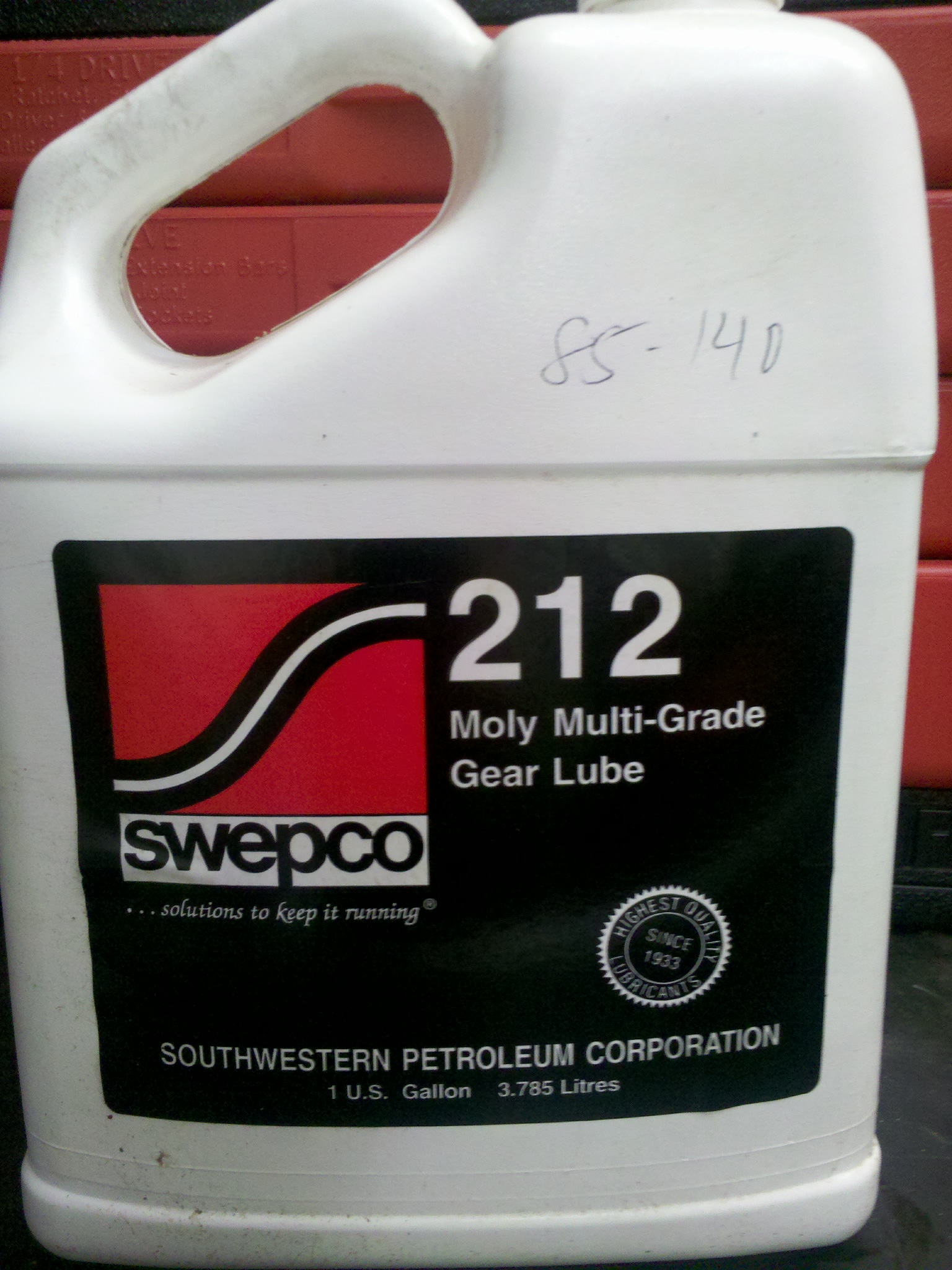

Swepco 212, 4 qts, Change it at least once a season.
5 QTs is too much for a MD4S-2D. Mendeola recommends 4qts.

Is this a synthetic?
