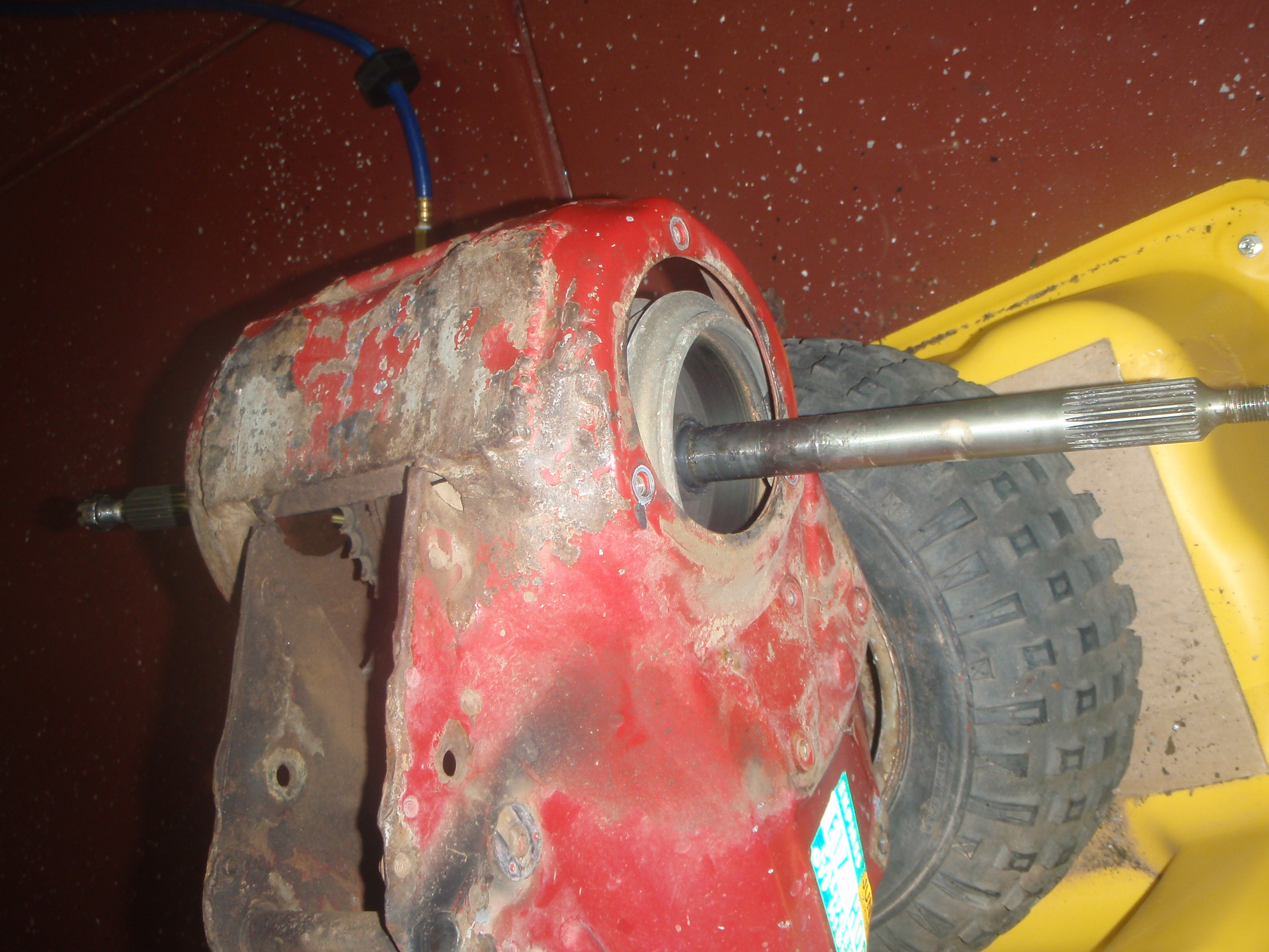

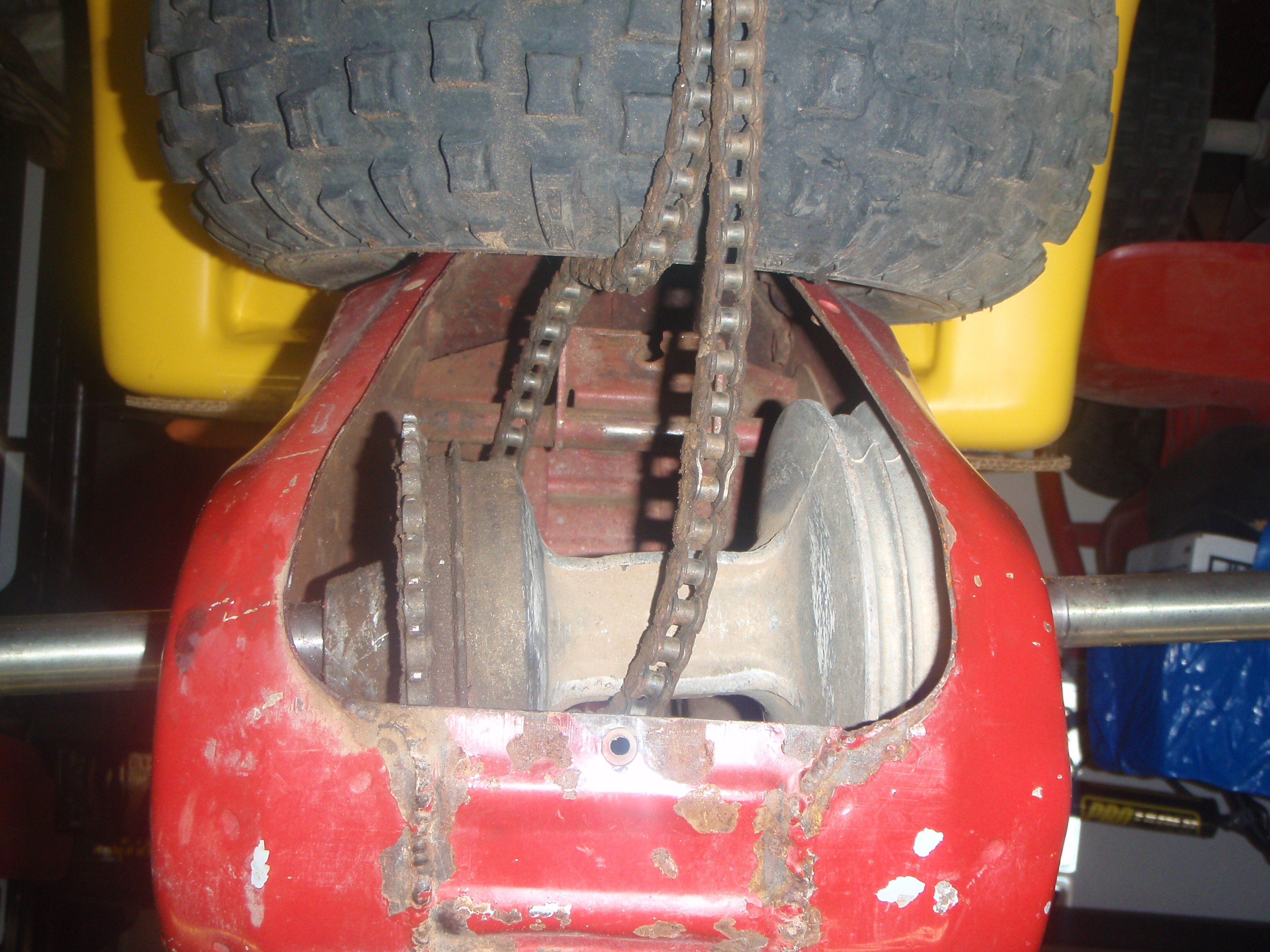

dune_rat Posted November 29, 2011 Share Posted November 29, 2011 (edited) I've removed everything from the frame but the axle. I also removed a snap ring on the rear sprocket side. Am I missing anything? or do I just need to pound the crap out of it? Any help is appreciated before I screw something up. Edited November 29, 2011 by dune_rat Quote Link to comment Share on other sites More sharing options...
White Rhino Posted November 29, 2011 Share Posted November 29, 2011 http://www.sterdyproducts.com/manuals/atc70.pdf go to page 17 to start Quote Link to comment Share on other sites More sharing options...
rushjunkie Posted November 29, 2011 Share Posted November 29, 2011 Put a nut on the end and a 2x4 to protect the threads, then go to town with a hammer. Took me A LOT of wd40 and pounding before it budged. Quote Link to comment Share on other sites More sharing options...
dune_rat Posted December 1, 2011 Author Share Posted December 1, 2011 Thanks for the replies. I sprayed PB Blaster on it a couple times a day for 2 days and when I came home from work today the axle had already fallen out. I didn't have to bang on it at all. That stuff is pretty awsome. Quote Link to comment Share on other sites More sharing options...
