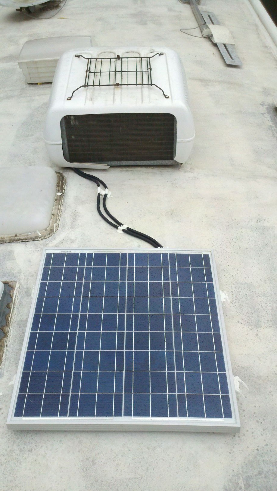

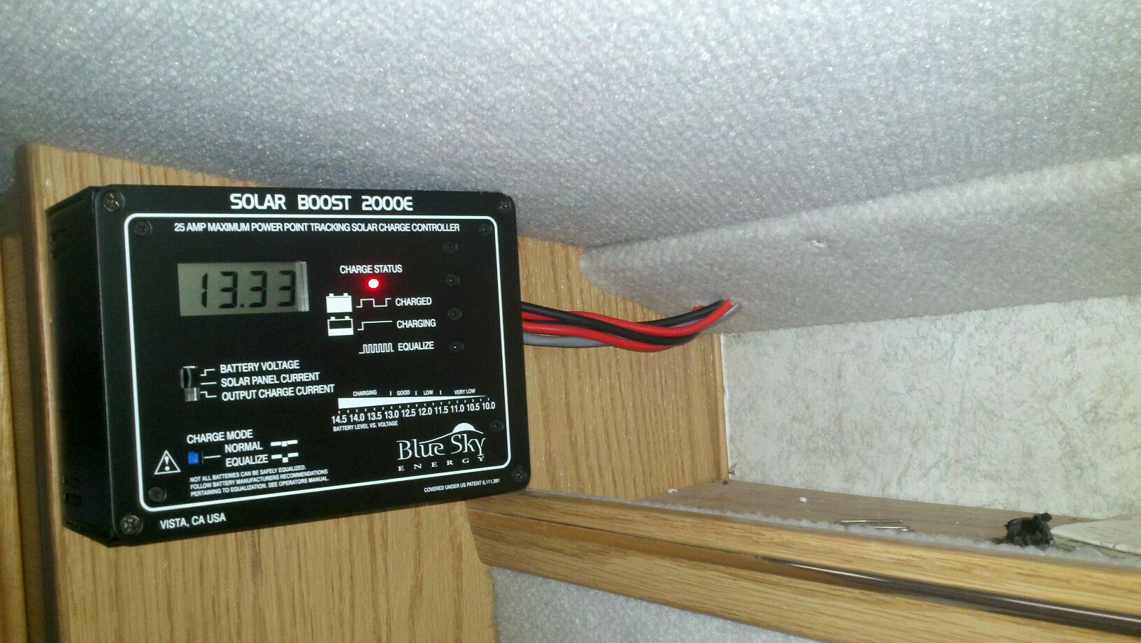

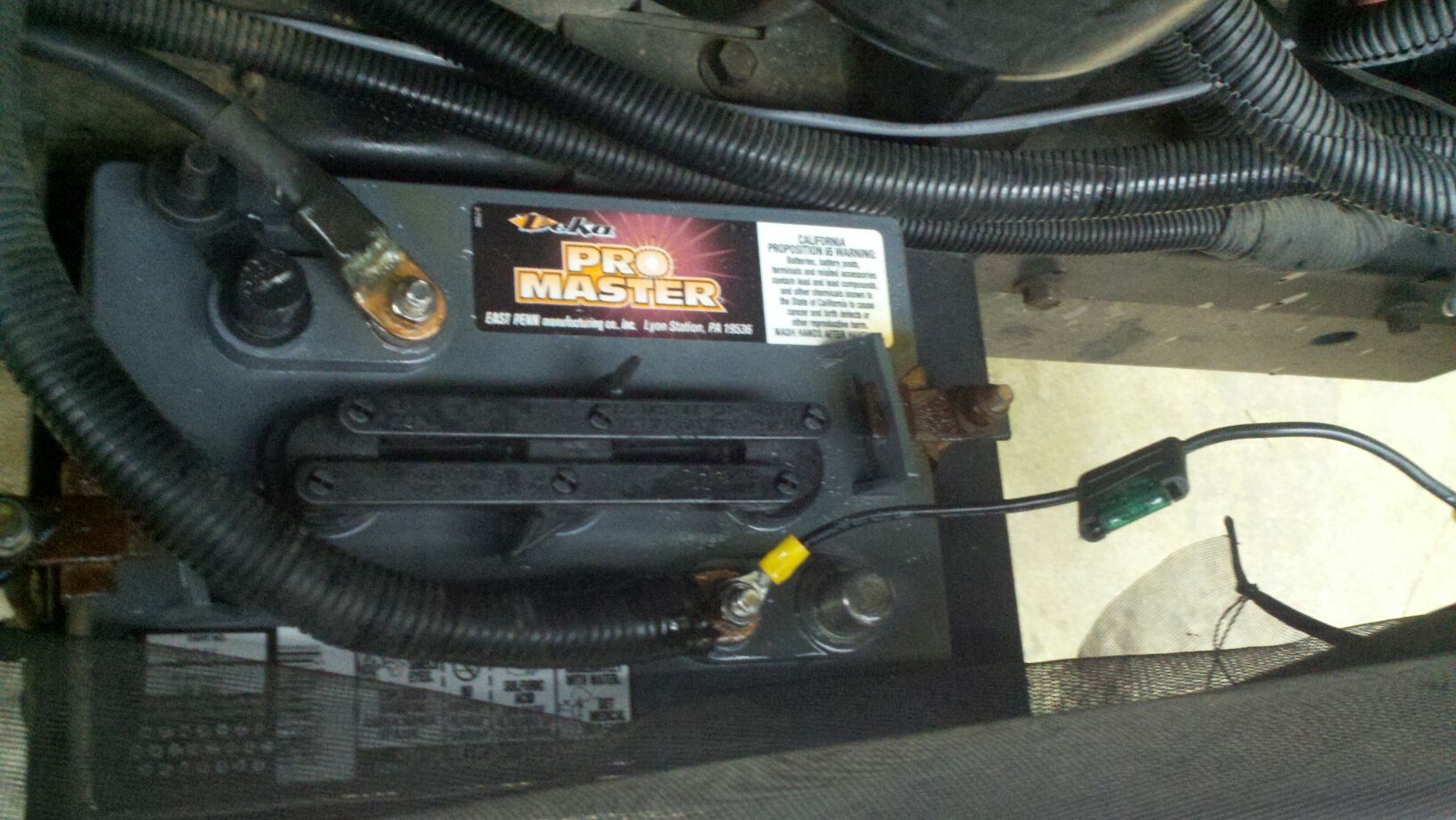

bp-guy Posted February 16, 2012 Author Share Posted February 16, 2012 (edited) Ok heres how I ran my solar panel- Heres the panel. I got it from www.Solarblvd.com I ran it down my A/C vent since it was easier to get the wire on the drivers side of the motorhome to run it forward to the batteries. (tip) cover the wires in a loom to help keep the UV rays from breaking down the wiring. Alot cheaper and easier to replace that plastic loom from radio shack ($5) Here is the controller I bought. Its way overkill for my application but I got it on ebay for $90. They list for $250. But now I can add an invertor and run the TV off the solar and not run the generator. The wires were ran behind that panel from the kitchen to the box which is above the drivers seat. I used 10 gauge wire on the entire run. From the box it goes back into that carpeted panel and to the windshield and down to the front of my motorhome where the batteries are. From here I just added a 30 amp inline fuse and connected them to the new deep cycle 6 volt batteries and thats it! I did alot of reading on charge controllers and it seems for RV's it is suggested that the controller be a MPPT (Maximun Power Point Tracking) type. It always is checking the voltage and regulating the charge it sends to the battery. I can adjust it internally and put out more voltage if I need it or turn it down. Here are the LED lights I have been putting in the motorhome as well. I am trying to do all I can to save battery power at night. The one on the right is your standard 1156 lightbulb. The one on the left is the new LED 1156. Here is the difference in using the two side by side. The LED is alot whiter in the light it puts out. But the energy they use is so minimal its a no brainer for me to put them in. These light bulbs can be found on EBAY. Just do a search for "1156 LED" and you will find them. There are many types to choose from as far as how many LED's you want in the bulb. Just pick the one that fits your needs. There you go, Solar 101! I learned alot doing this and hopefully it pays off this weekend in the desert. On a scale of 1 to 10 for difficulty it was a 3. Anyone could do this. Just plan ahead for the wires and where they are going to go, make sure you have enough and have fun. And the technical support at Blue Sky is top notch. I called him with some technical stuff on the controller and he helped me out even though I didn't but it from them firsthand. Edited February 16, 2012 by bp-guy Quote Link to comment Share on other sites More sharing options...

bp-guy Posted February 16, 2012 Author Share Posted February 16, 2012 It was very easy Pete. If I had all the stuff ready to go, It could be done in 4-5 hours easily. The hardest part was removing the panels to run the wires. Taking out all the pots and pans to get at that access panel! Here 's a breakdown on the prices- Solar Panel $89 Charge Controller $90 Wiring $40 Batteries $210 LED Lights- $28 ( alot of bulbs) Dicor Sealant and misc stuff $20 Happy Timmy in a warm motorhome- PRICELESS! Quote Link to comment Share on other sites More sharing options...
bp-guy Posted February 22, 2012 Author Share Posted February 22, 2012 Motorhome was NICE!!! Had fully charged batteries by mid-day. Can't believe I waited so long to do this! Quote Link to comment Share on other sites More sharing options...

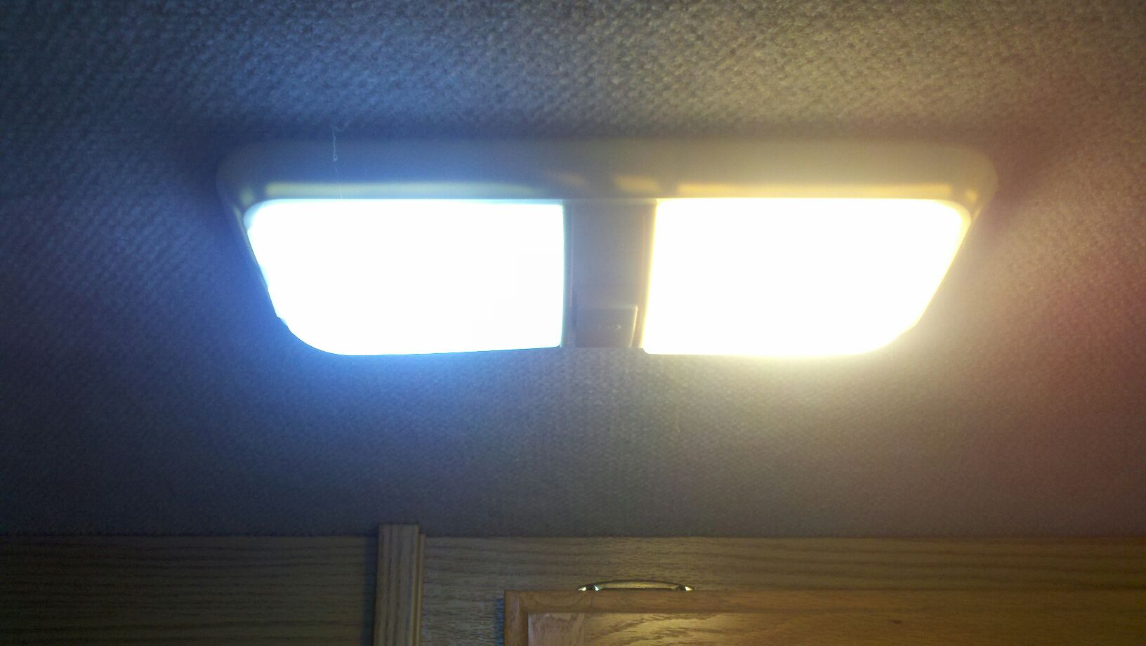

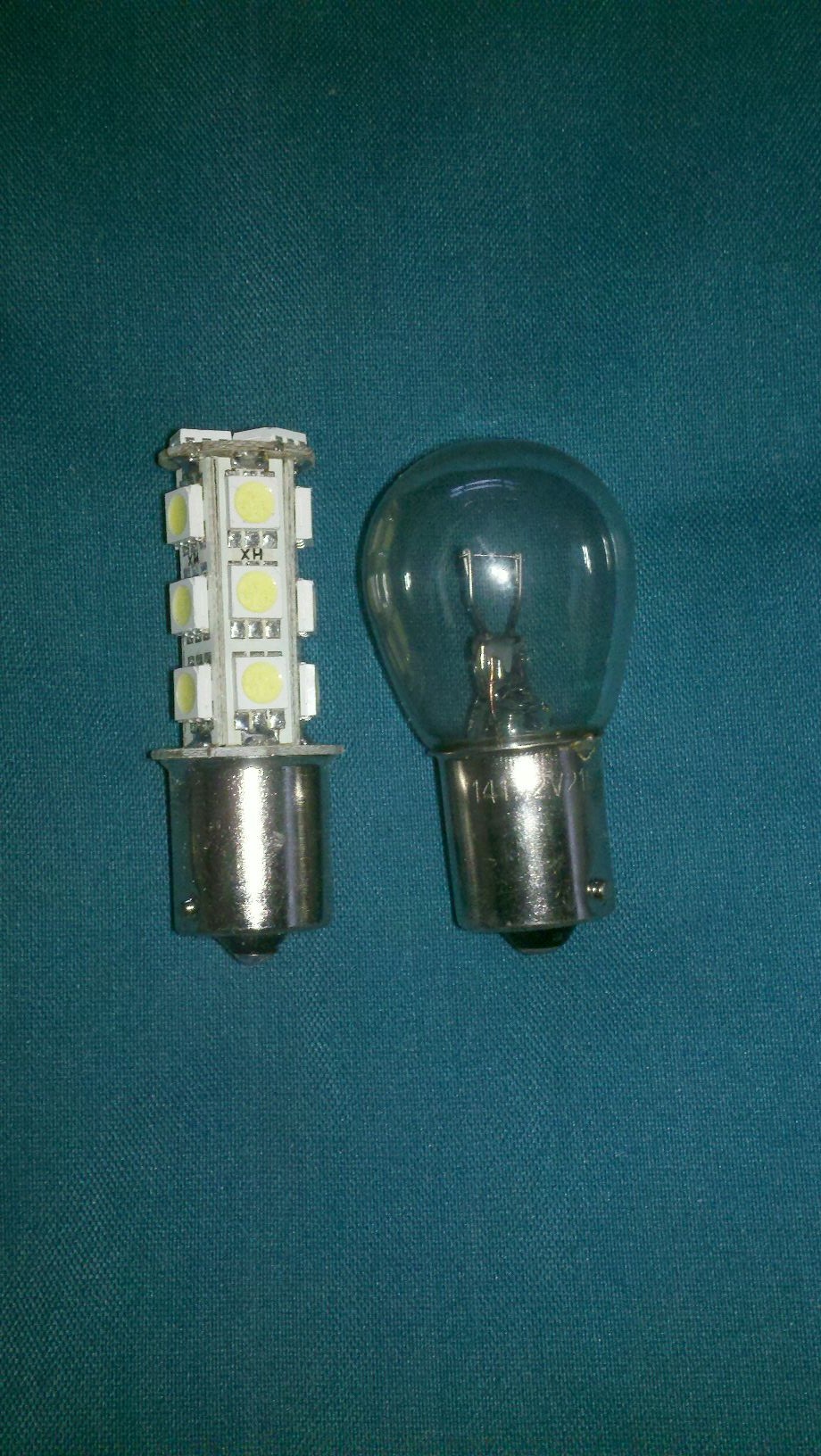

FE135 Posted February 22, 2012 Share Posted February 22, 2012 Do you have a link to the led bulb vendor you used? I was amazed at the varying amounts the same bulb costs from different vendors. Quote Link to comment Share on other sites More sharing options...
bp-guy Posted February 22, 2012 Author Share Posted February 22, 2012 (edited) On 2/22/2012 at 4:06 AM, FE135 said: Do you have a link to the led bulb vendor you used? I was amazed at the varying amounts the same bulb costs from different vendors. My bulbs came from Hong Kong,The vendor was "vstore999e" But most that come from overseas are about the same price and have free shipping as well. The thing that changes the price is the amount of LED's on each bulb.I think my bulbs have 17 leds on each of them. This is more than enough light. I had one light on and it lit the entire motorhome with no need to use any others. The hard part is getting use to the "white" light as opposed to the yellow light the standard bulbs put out. Edited February 22, 2012 by bp-guy Quote Link to comment Share on other sites More sharing options...
