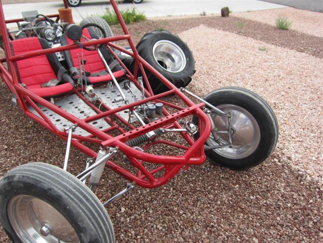

Squirrel702 Posted July 7, 2012 Share Posted July 7, 2012 I just got this Mazzone sandrail for 4000 real nice came with a 1776 duel dellatros 40mm and he said there was a cam in there but he did not remember which one. Here is my ? I am looking for new seats something with a high back and some sort of cushion but the seat that is in there now is just over 17 inches wide and everything I find is 19. I would like to get suspension seats or something more comfortable. Does anybody have a idea where I can find something. Also these damn carbs are a pain in the a$$ there where set up for a 2180 and I have a flat spot. I know about the sync and I have done that. My ideal is at 28 degrees and my venturies are 36 ideal jets .56 (was.70) air jets 190 was 180. I need help with these things. Would it be best to sell them and buy Empi carbs. Also what is the big deal about Dellartos over weber or Empi? I am also thinking about putting in a Subaru motor if it will fit with out any major mods or even just a turbo on this VW any help would be awesome in this department, I was told there would not be any problems. Hell I would be happy at 130 to 150 Hp right now. Is there any place where I can go like a one stop shop for info and parts. Thank you guys. The car was being sold on here b4 I bought it. Be gentle guys I am new to this. I was raised in the dirt and father had a NICE rail that I drove all the time. I have been wanting to get back into the sand so I bought this, my first rail. Quote Link to comment Share on other sites More sharing options...

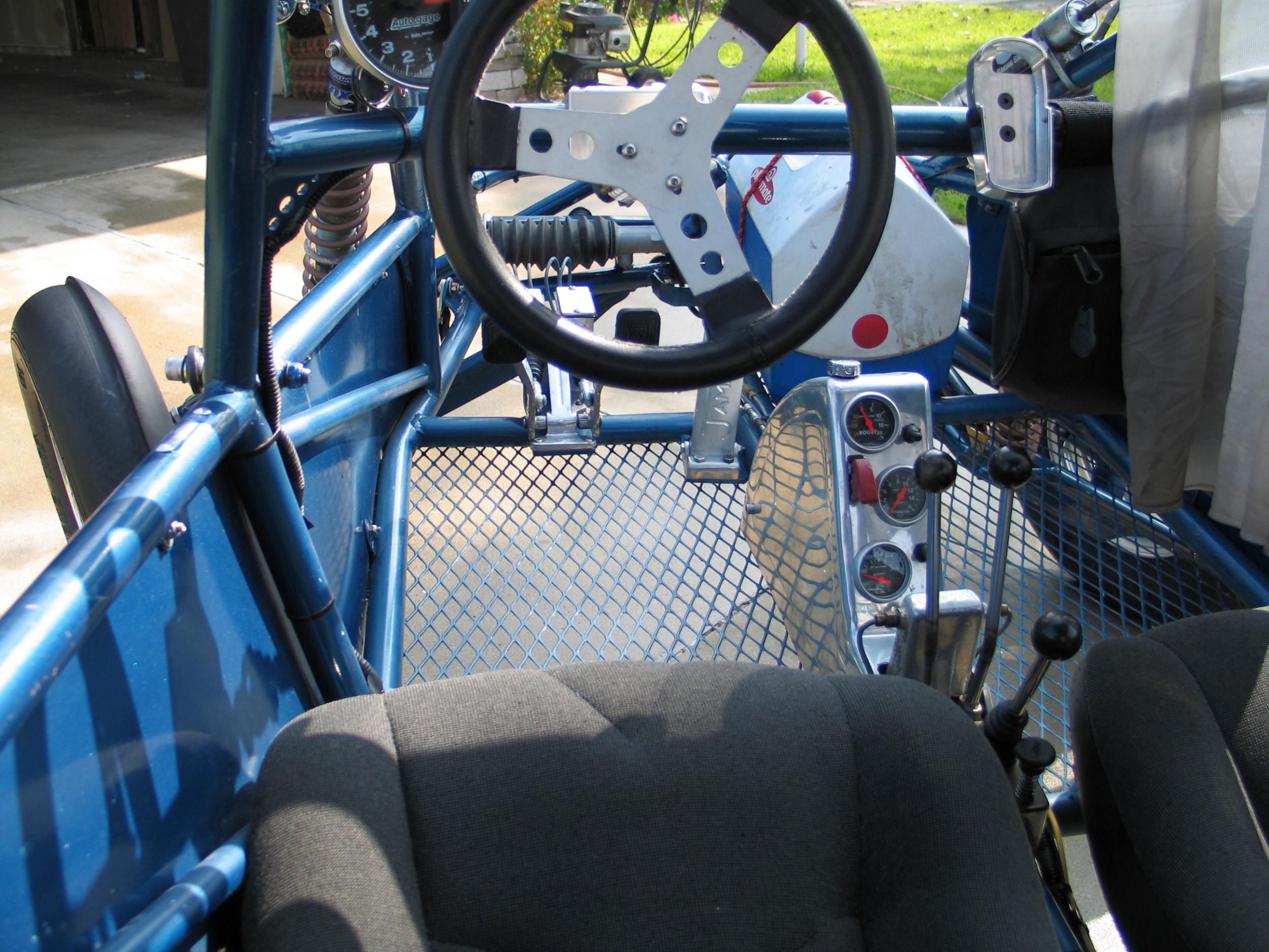

andydew Posted July 7, 2012 Share Posted July 7, 2012 I had a set of lil' sportster suspension seats in my first rail. From what I remember, they are the narrowest suspension seats made. Don't know if the pic helps, but they were awesome! I also found this link for you: http://www.redart.com/index.php?option=com_virtuemart&page=shop.browse&category_id=203&Itemid=21 I think they are 19" as well, so seats may not be an option without a little fabbing on your frame. Quote Link to comment Share on other sites More sharing options...
