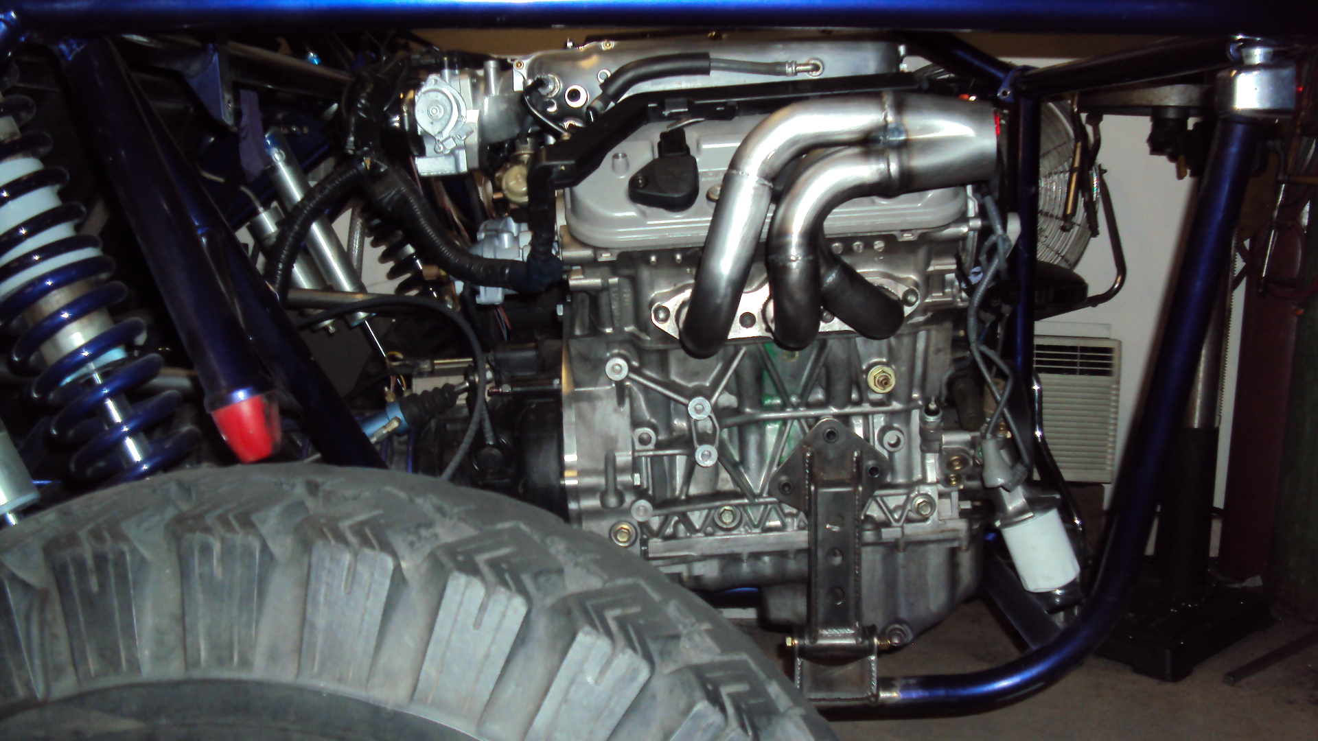

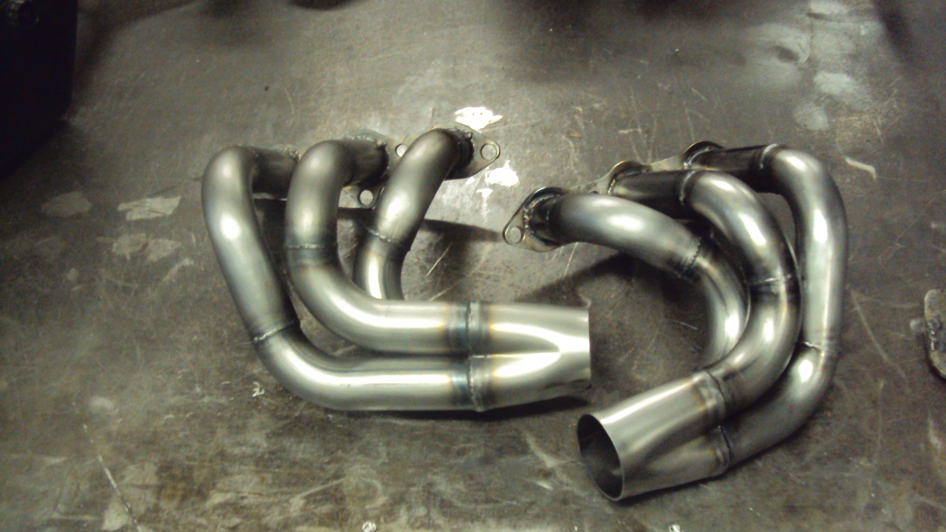

ynot Posted January 9, 2013 Share Posted January 9, 2013 I contacted Carl @ Vtech Perf. He offers 2 parts needed to be able to run stock ecu with turbo but was witholding what two parts included. I understand he in business to make money and why tell me what they are just to have myself hunt the parts down myself. Im pretty sure it is a FMU (fuel management unit) but unaware of the other part. If you dont mind what are you running to be able to run stock ecu with turbo max 8psi. FMU? etc.... Thank You. Also hears acouple pics of the headers I finished welding last night. Doing a turbo behind the motor arrangement. Why would you not buy the parts from him if he has the knowledge and means to make it happen? Just saying that free advice is one thing and being in business is another. If he can help you, give the man your business and you have a person who you can call on for help anytime through the process. Can't imigine his price on the equiptment would be that much than you spending your time and error on it? Terry 1 Quote Link to comment Share on other sites More sharing options...
chris&hol Posted January 9, 2013 Author Share Posted January 9, 2013 Thats my plan. I just didnt understand what he was offering me. He said it was the two parts needed to do what I want with motor. I was just confused as to what he was using, I amagine thats everyone first search for something there getting into ( assume the parts myself and struggle for a month trying figure out, or buy parts slightly higher in cost and slap together and move on) Im goinig to order parts as we speak. I let ya know what comes in box? Quote Link to comment Share on other sites More sharing options...
Randog Posted January 9, 2013 Share Posted January 9, 2013 (edited) Yes, an FMU is required to increase fuel pressure under boost by cutting off the fuel return line flow. Also you'll need a "missing link". it goes under the map sensor. it's basically a check valve. Not totally sure what exactally Carl was taking about, but I know those two are needed for the system. I agree with what Terry said about business and knowledge. Our group has bought quite a bit of stuff from Carl. He's helpped us many times. Carl has a great deal of knowledge and is a great asset to your team. Keep him happy and he'll help keep you runnin'.... R- BTW: Those headders look sweet! great job. Edited January 9, 2013 by Randog Quote Link to comment Share on other sites More sharing options...
chris&hol Posted February 21, 2013 Author Share Posted February 21, 2013 Ok, so Engine is running Normal Aspiration right now so i can get some trips in on the season pass I purchased. Fired engine up for first time earlier last week and right away had weird miss at idle only. I assumed first off it was a o2 sensor that I foolishly forgot to weld in to the exhaust but after fixing that still crappy missing idle. So i borrowed a buddy of mines OBD code reader and it showed P1519 Idle Air Control Vavle Circuit Failure. So after hours of research trying to find out where it was located on the throttle body and why i was not seeing it, I shockingly realized it bolts right to the bottom of the TB right where the engine builder (Doomsday Motorsports , Phoenix AZ) had welded in a block off plate??? Ive had numerous calls into them with non-supriseingly failure to return calls. First Question, any of you 3.2- 3.5 guys running IAC Valve under Throttle bodie? Sencondlly Would like to save anyone the frustration of dealing with these guys as I have. They Have multiple ads on craigslist (shoot myself for going that route) I guess when the deal sounds to good , IT IS!! Thanks for any feedback. Quote Link to comment Share on other sites More sharing options...
