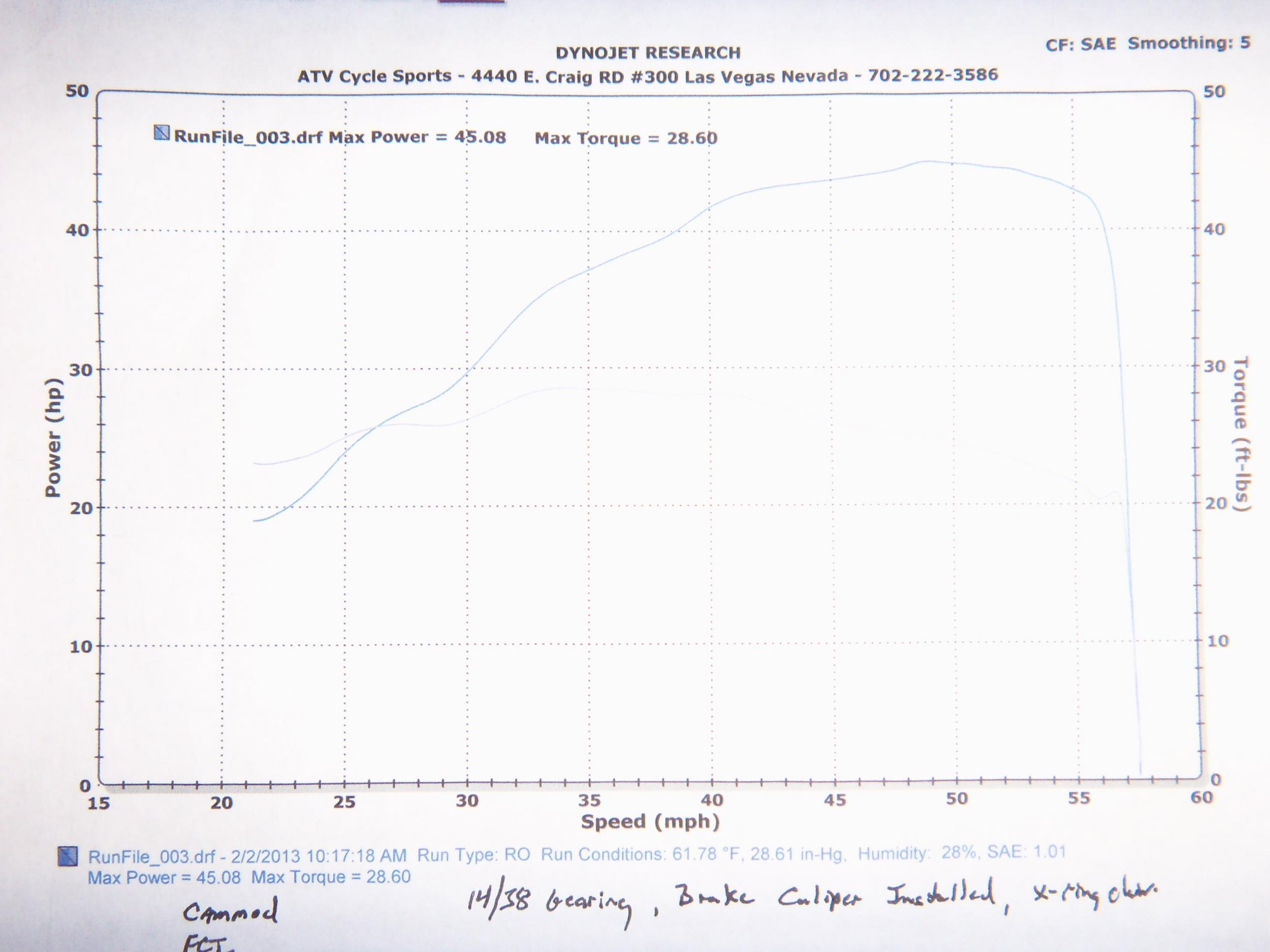

flavtfan Posted February 2, 2013 Author Share Posted February 2, 2013 (edited) Well once Steve got there they let me go back there....disregard previous post. This was a run with stock gearing x-ring chain, rear brake caliper installed, FCI, Cammod, Full Jardine RT99 Edited February 2, 2013 by flavtfan Quote Link to comment Share on other sites More sharing options...
sandawg Posted February 3, 2013 Share Posted February 3, 2013 Is ist normal to have that torque compared to power ? Isn't torque what moves you as apposed to power? Just asing since I don't know about quads. Quote Link to comment Share on other sites More sharing options...
flavtfan Posted February 3, 2013 Author Share Posted February 3, 2013 (edited) torque is normally in that range for non worked yfz 450 motors i believe. I thought it was a tad low but i'm getting my motor/carb work done and it should be somewhere in the neighborhood of 52hp and 33 on torque so we'll see. my head is getting ported and the carb is being bored out to 42.5 and i'm going up to 13:75:1 compression stock stroke stock bore. EDIT: will stick with 12:75:1 piston, hp expected in the low 50's Edited February 21, 2013 by flavtfan Quote Link to comment Share on other sites More sharing options...
Adam @ GTP Off Road Posted February 3, 2013 Share Posted February 3, 2013 I really doubt the brake caliper and the chain make much of a difference, why did they put that on there? Quote Link to comment Share on other sites More sharing options...
flavtfan Posted February 3, 2013 Author Share Posted February 3, 2013 Its extra drag depending if your calipers are depressed or not so the brake doesnt drag and some people will use a different chain to make their numbers look good. I want it just like I ride it. For the most part anyway. Some care some dont. I put that on there Quote Link to comment Share on other sites More sharing options...
