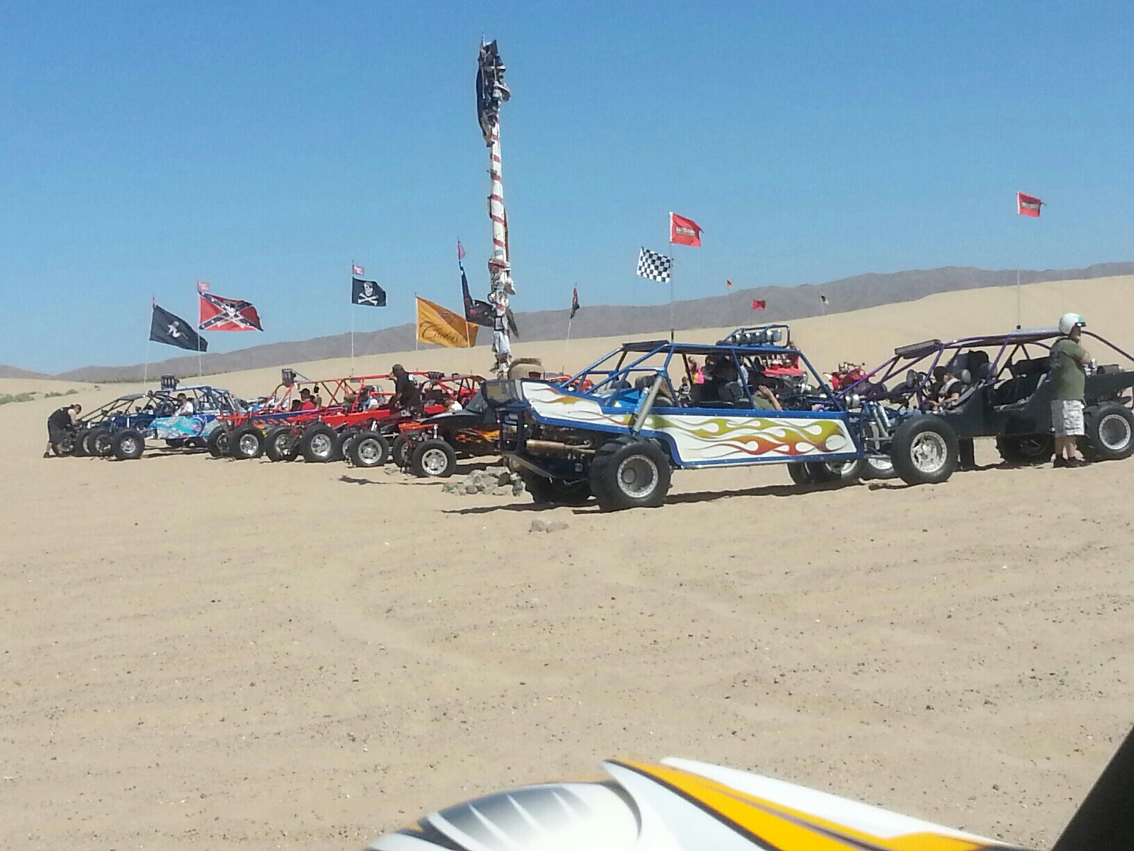

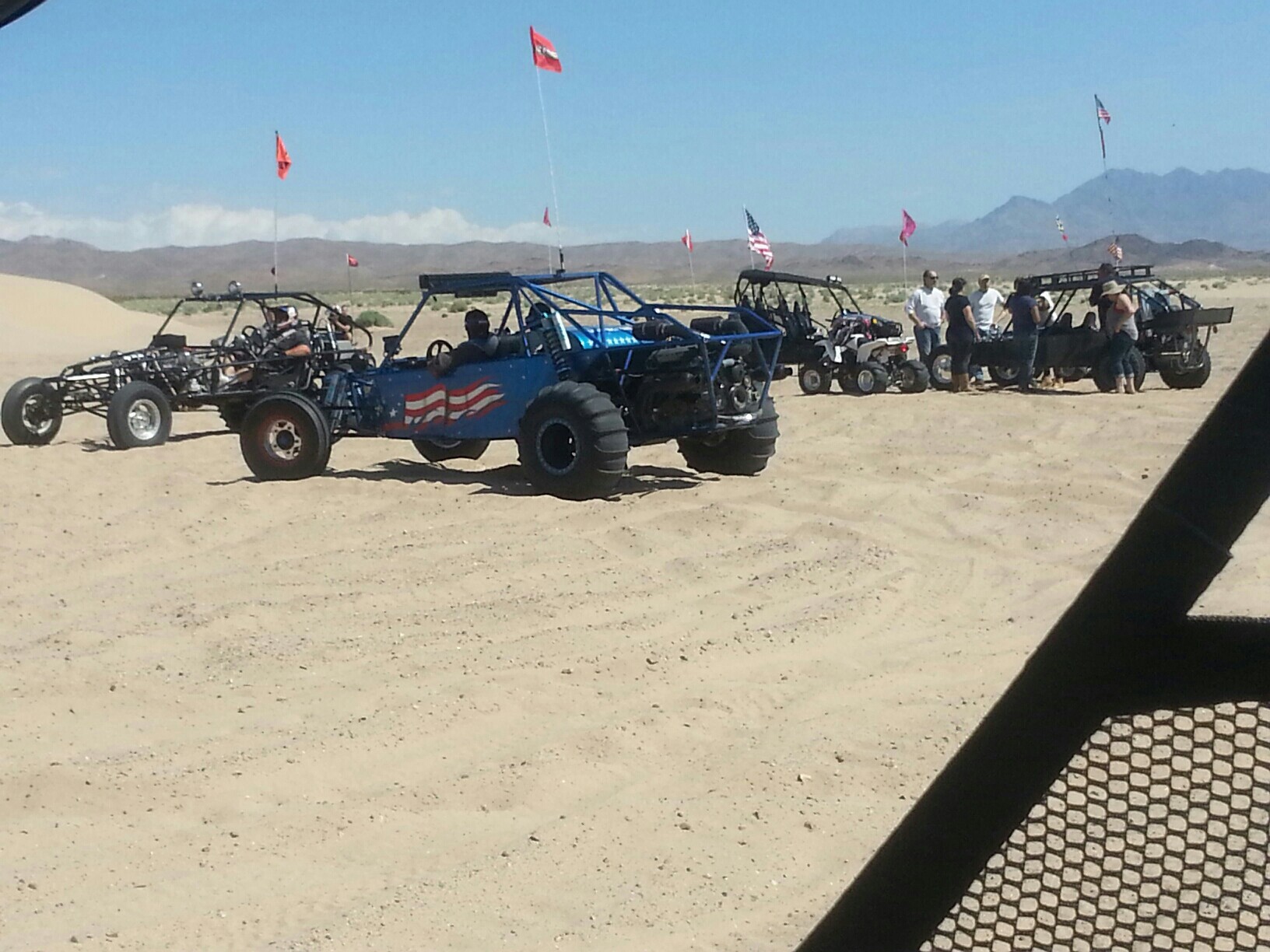

dunefreak Posted March 22, 2014 Share Posted March 22, 2014 Couple pics sent from the north pole. There's a ton of people out there this weekend. Quote Link to comment Share on other sites More sharing options...

flavtfan Posted March 23, 2014 Share Posted March 23, 2014 Couple pics sent from the north pole. There's a ton of people out there this weekend. 20140322_120254.jpeg 20140322_120258.jpeg neat...I was right behind this group....it was HOT haha. that was after one of our longest runs of the day..... Quote Link to comment Share on other sites More sharing options...
