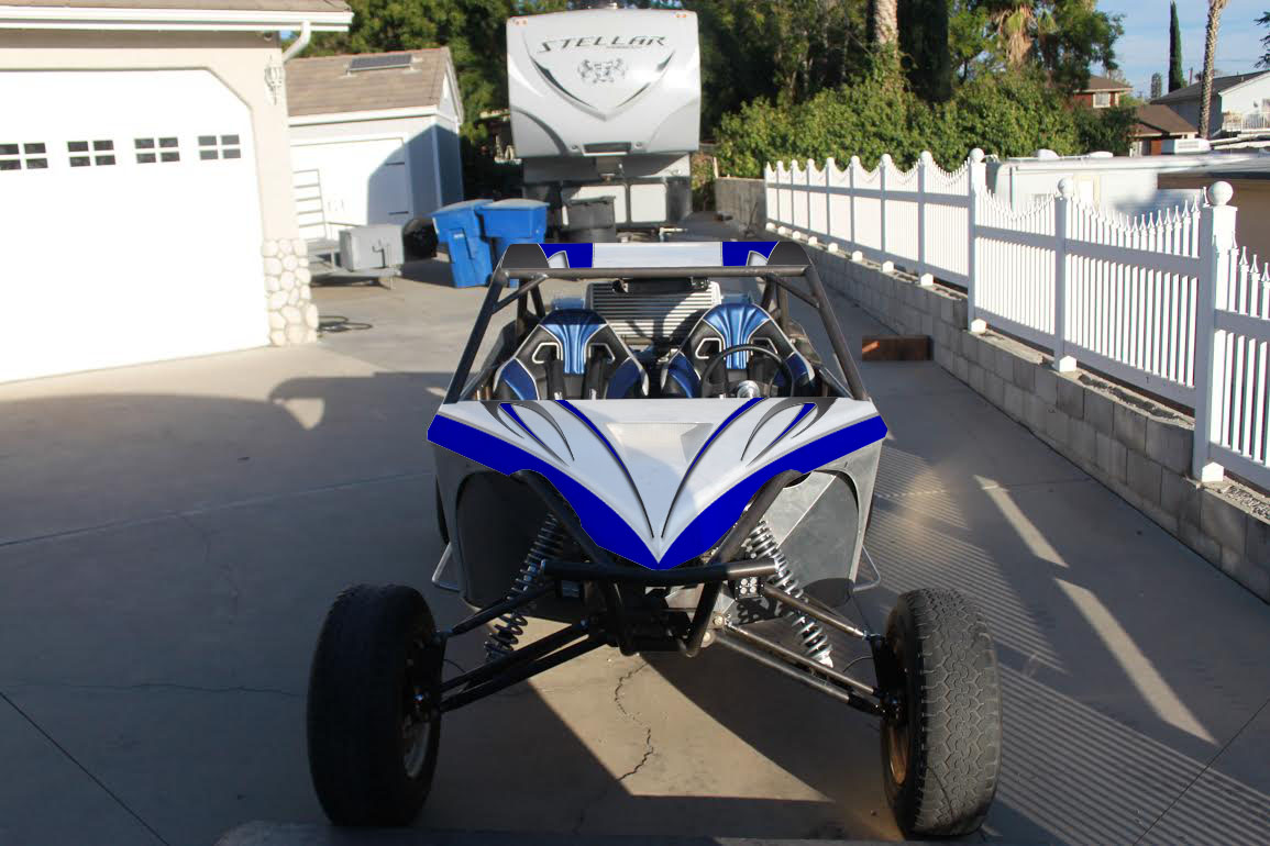

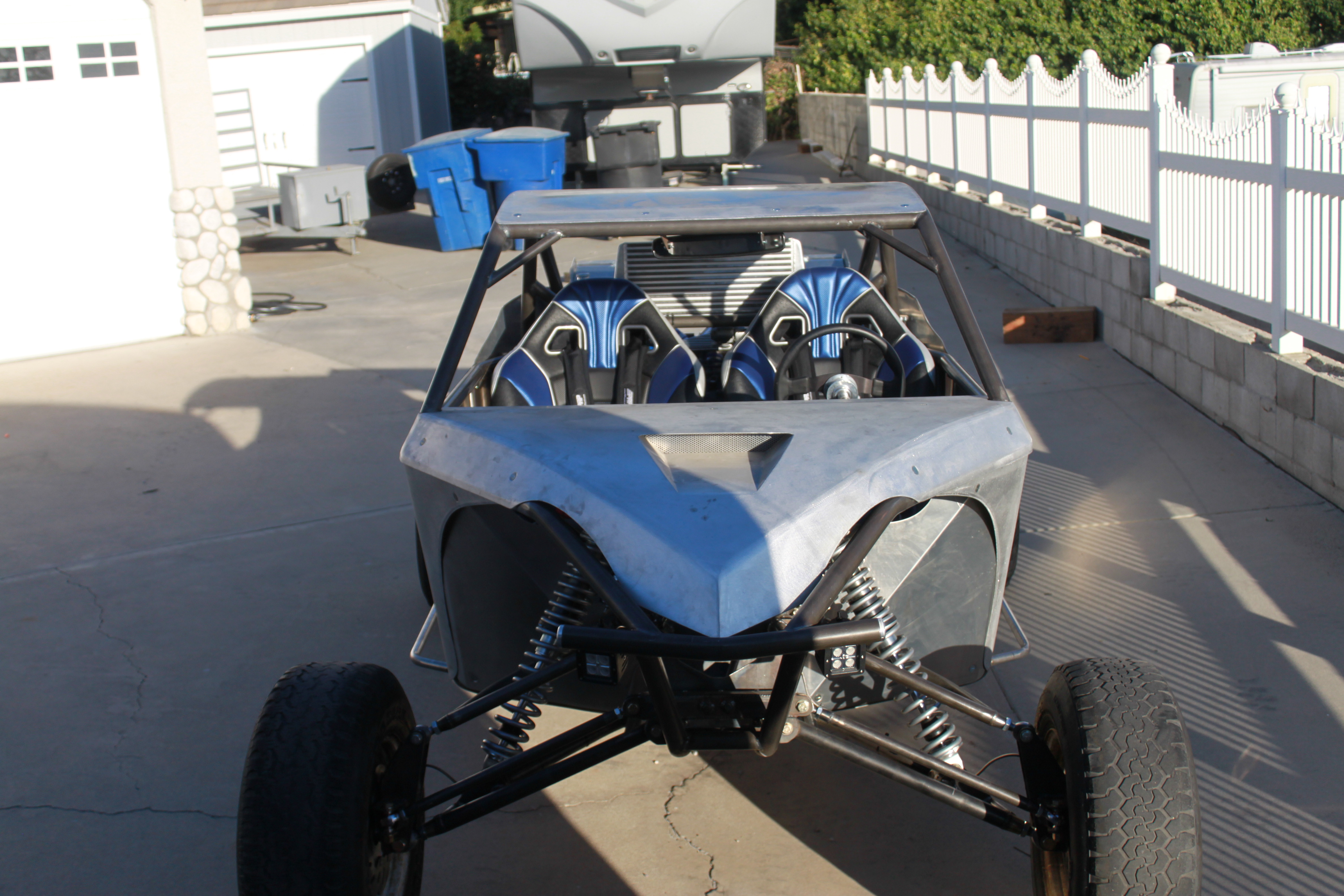

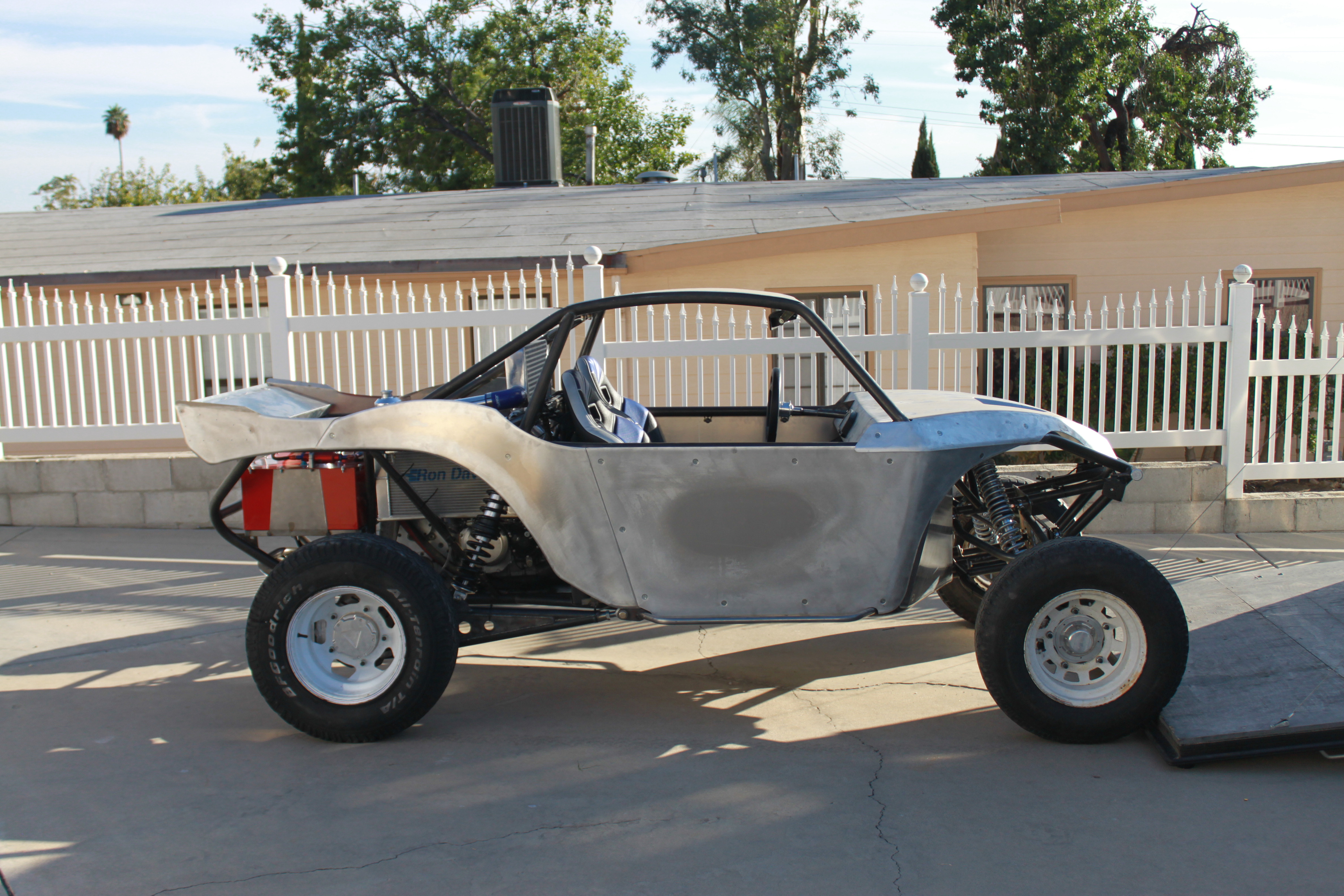

DirtBikeGuy Posted September 16, 2014 Author Share Posted September 16, 2014 Its getting there, had a discussion with our fab guy yesterday and told him it has to be ready for Halloween. Quote Link to comment Share on other sites More sharing options...

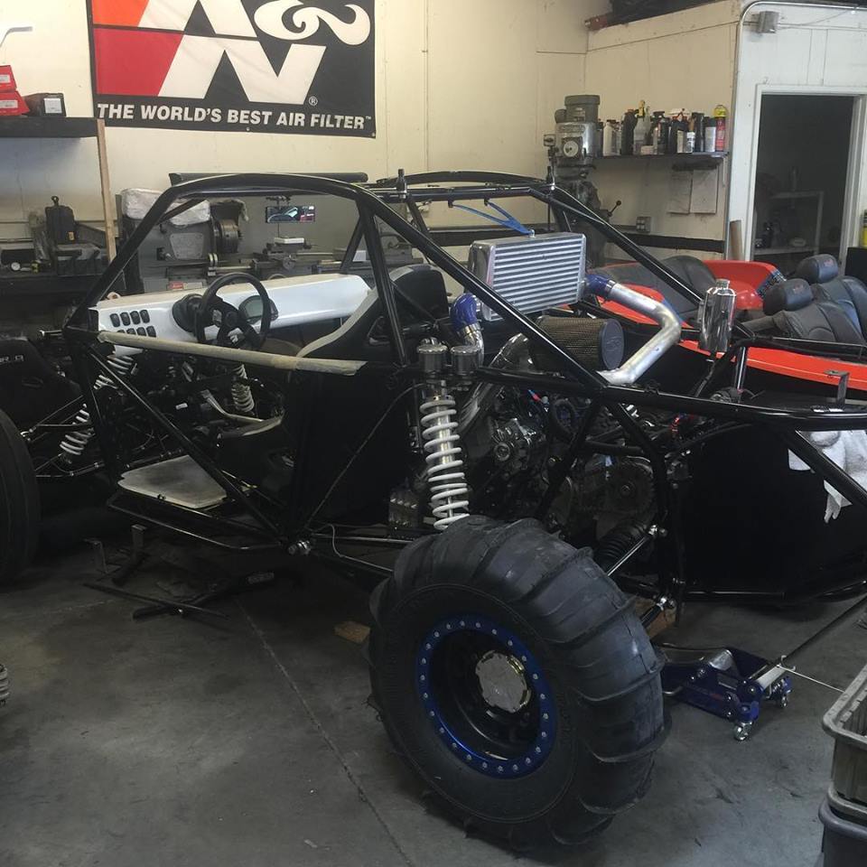

DirtBikeGuy Posted October 27, 2014 Author Share Posted October 27, 2014 So the car is now together and running. Its off to heads up performance for a new tune and to have the wire harness extended in order to mount all the electronics in the rear wing. Once we get the dyno work done then its off to test run the car to make sure everything is in the right place and move anything that needs to be moved before going off to powder coat. Hoping its will be done before T-day if everything works out. Quote Link to comment Share on other sites More sharing options...

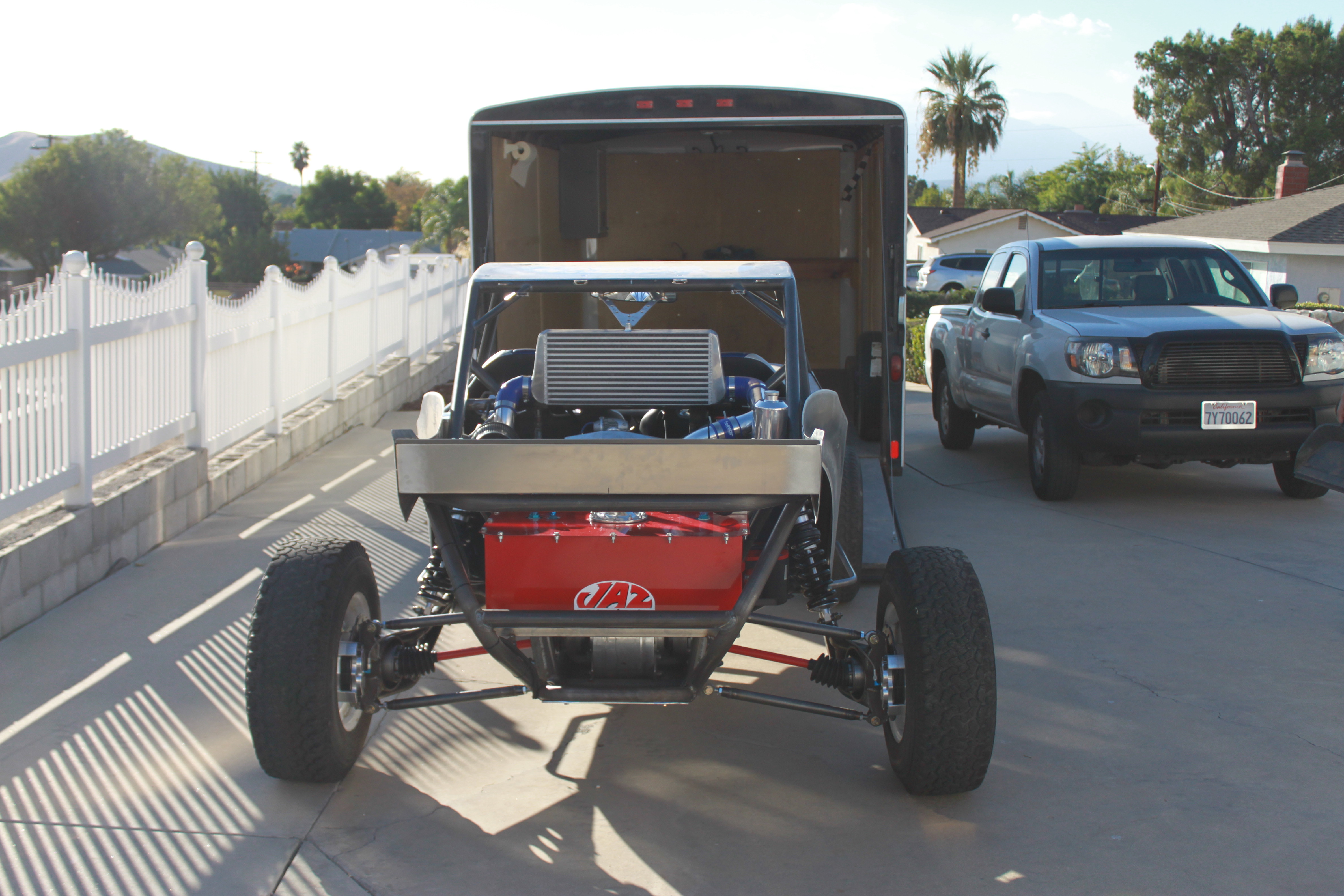

raspadoo Posted October 29, 2014 Share Posted October 29, 2014 My first dog is buried right under where it is parked in those pics Quote Link to comment Share on other sites More sharing options...
FireKracker Posted October 29, 2014 Share Posted October 29, 2014 My first dog is buried right under where it is parked in those pics Did anyone else wonder what this means? Quote Link to comment Share on other sites More sharing options...
DirtBikeGuy Posted October 29, 2014 Author Share Posted October 29, 2014 My first dog is buried right under where it is parked in those pics There used to be a ditch there so you must have worked extra hard as a kid to dig that deep of a hole... Did anyone else wonder what this means? My parents built on his families land. Quote Link to comment Share on other sites More sharing options...

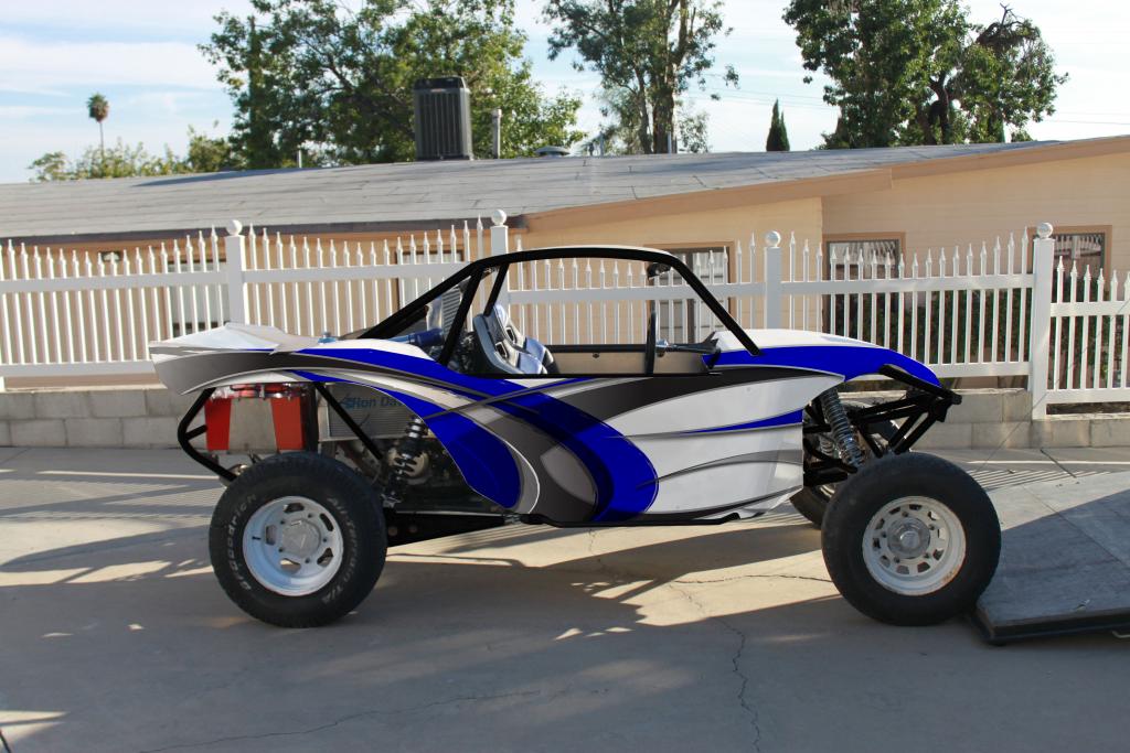

DirtBikeGuy Posted November 17, 2014 Author Share Posted November 17, 2014 We have been working on some graphic and paint designs. Should come out pretty sweet when its done... Quote Link to comment Share on other sites More sharing options...

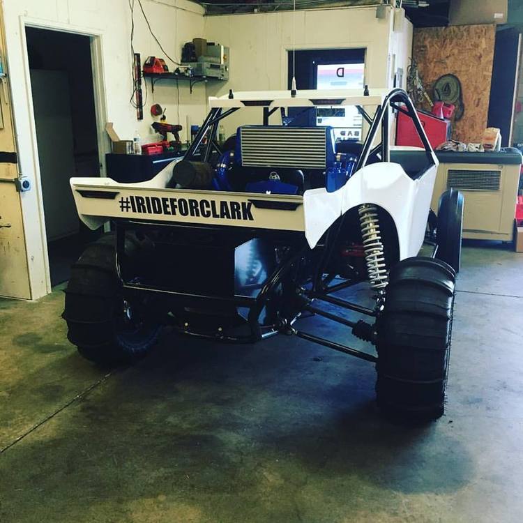

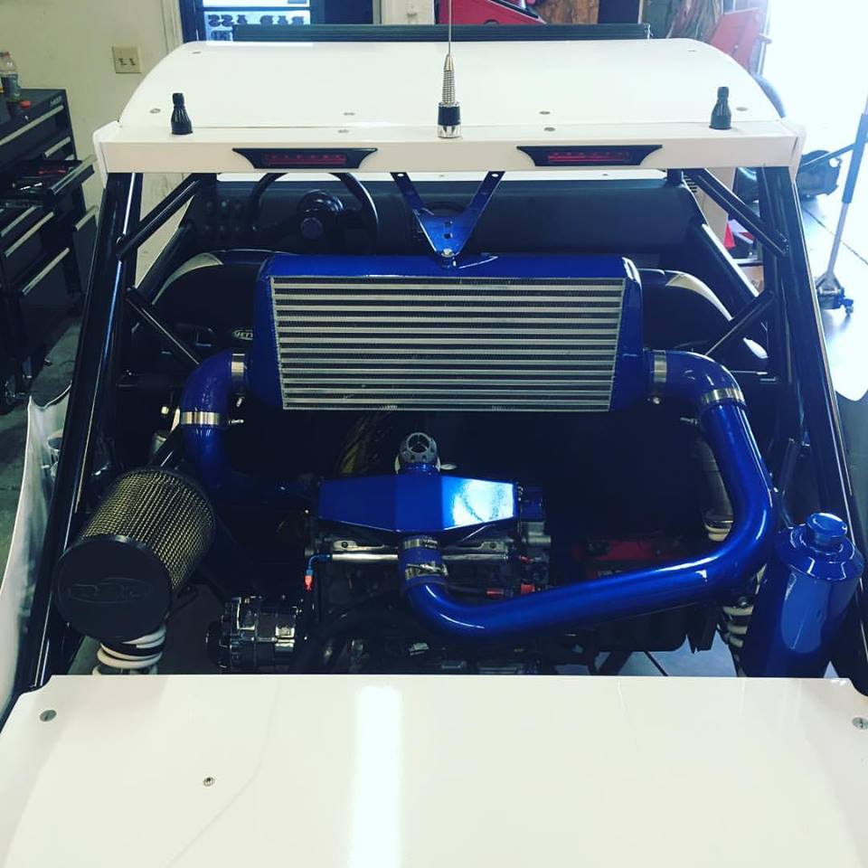

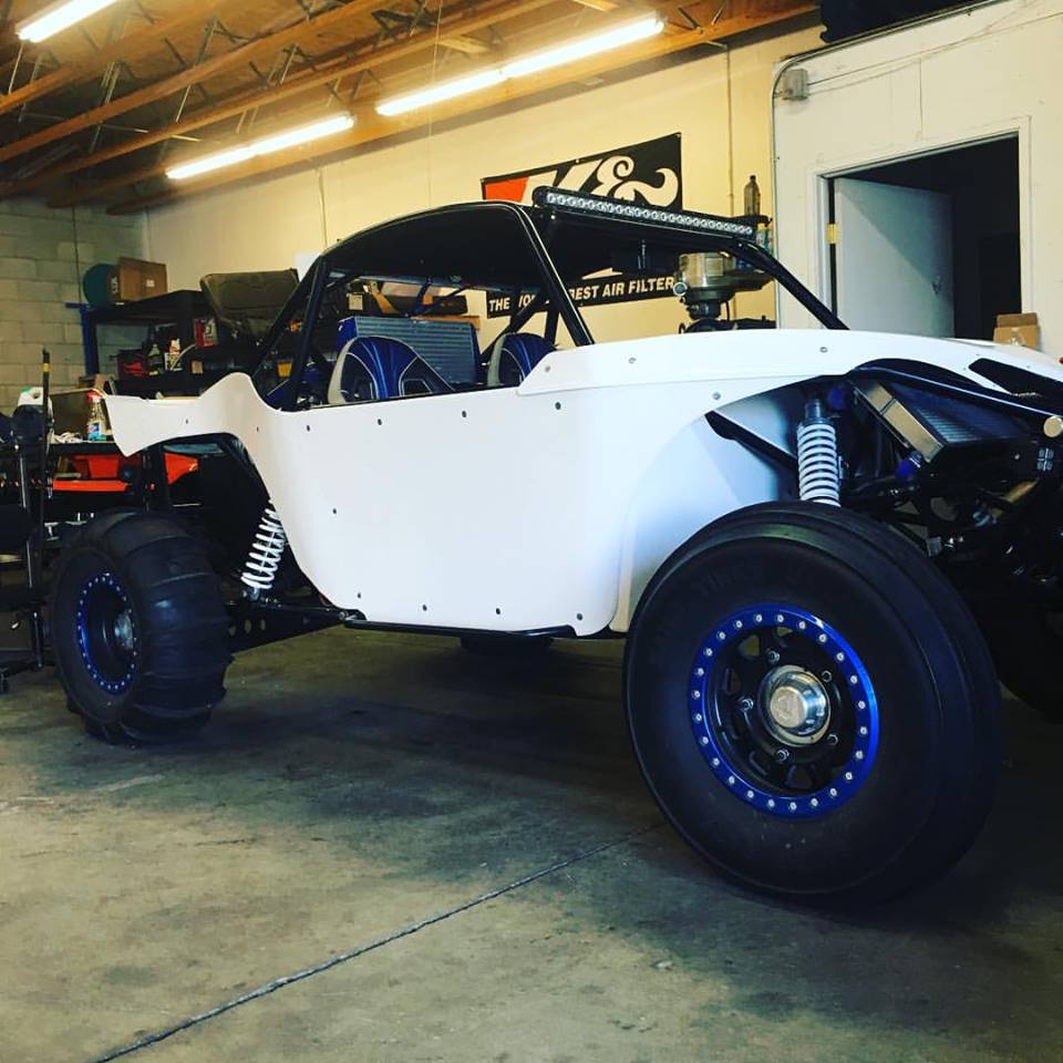

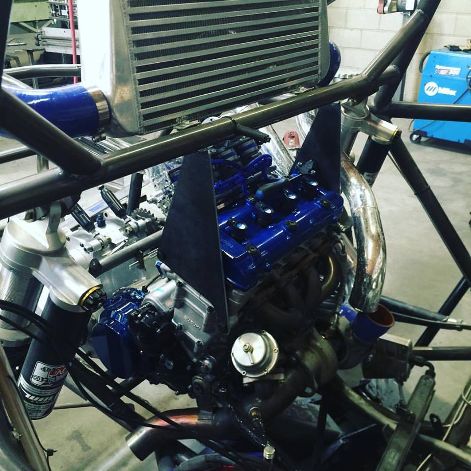

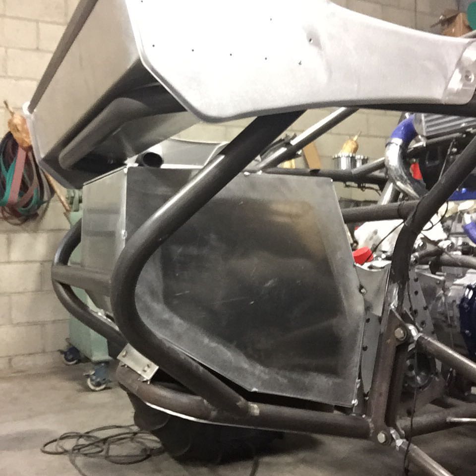

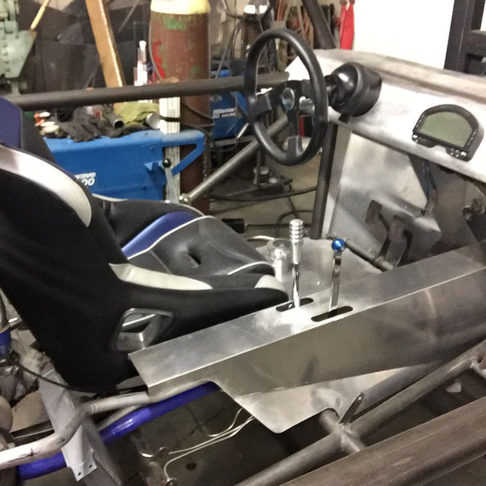

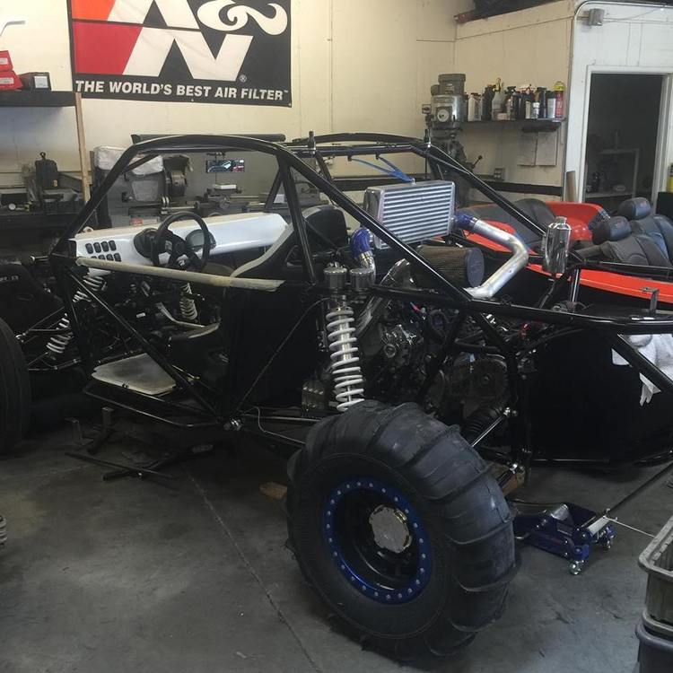

DirtBikeGuy Posted October 6, 2016 Author Share Posted October 6, 2016 Figured I would give this thread a little update... Here is a list of a few of the things we changed up/added: -Custom fuel tank to allow for more room for the rear diff box -more sturdy motor mounts -power steering and tilt wheel -moved radiator up front for better cooling -added oil cooler -raised shift handle -added tom pro alternator As of now just fixing up a few voltage issues and then off to CHP for a vin tag and hopefully be out at G for Halloween... Quote Link to comment Share on other sites More sharing options...

DirtBikeGuy Posted December 1, 2016 Author Share Posted December 1, 2016 (edited) 1 hour ago, dunefreak said: Have you taken it out for a shakedown yet? How did it go? Took it out to Glamis for Halloween and blew out the jeffco diff box. Got that all fixed up and took it back out for Vets day and dropped a valve in the motor and put a rod through the bottom of the case.. So had to order a complete crate motor and going to build it back from there... Still debating on scraping the busa set up, for a subi and 2d, but its tough to come to terms with dropping another 15-20 grand on a drive train. Edited December 1, 2016 by DirtBikeGuy Quote Link to comment Share on other sites More sharing options...
