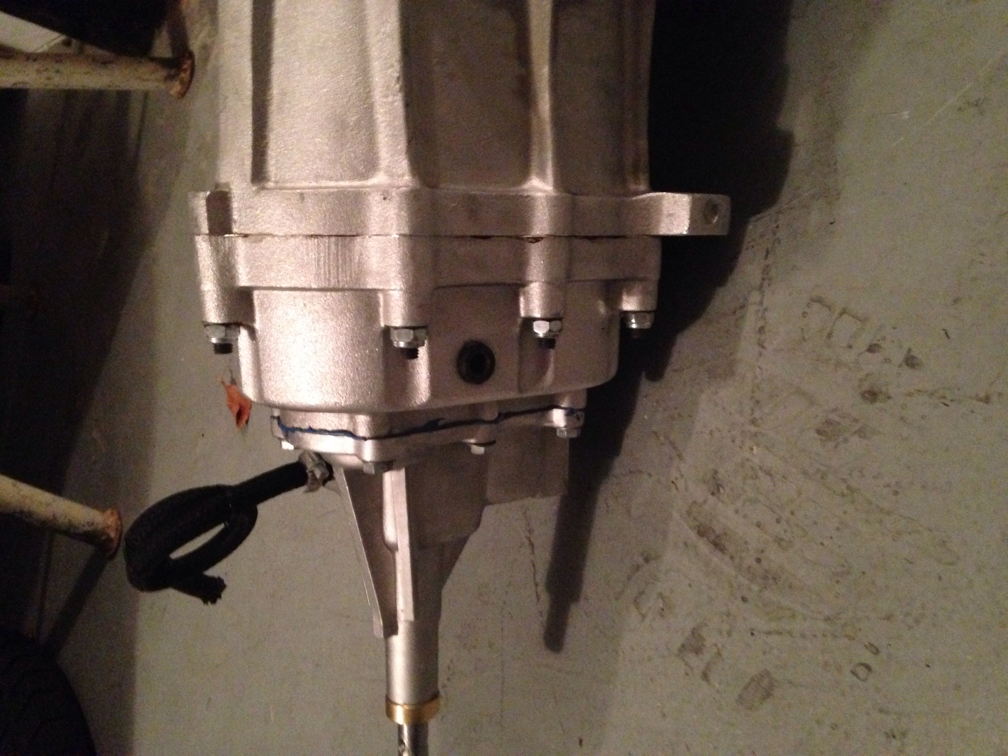

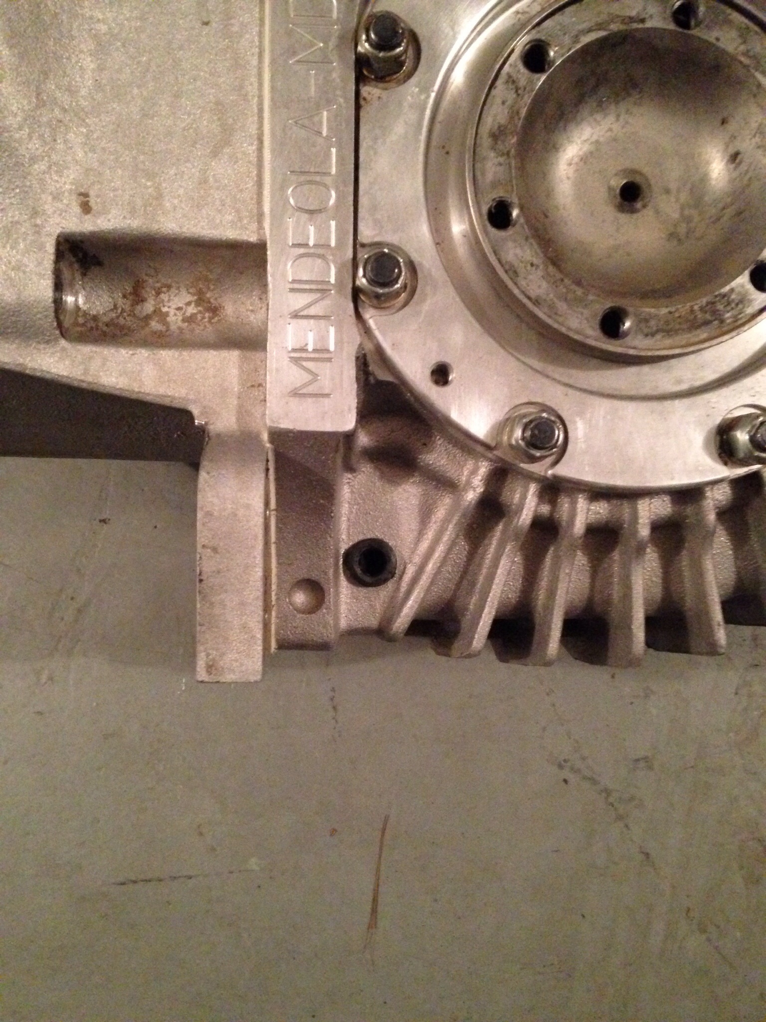

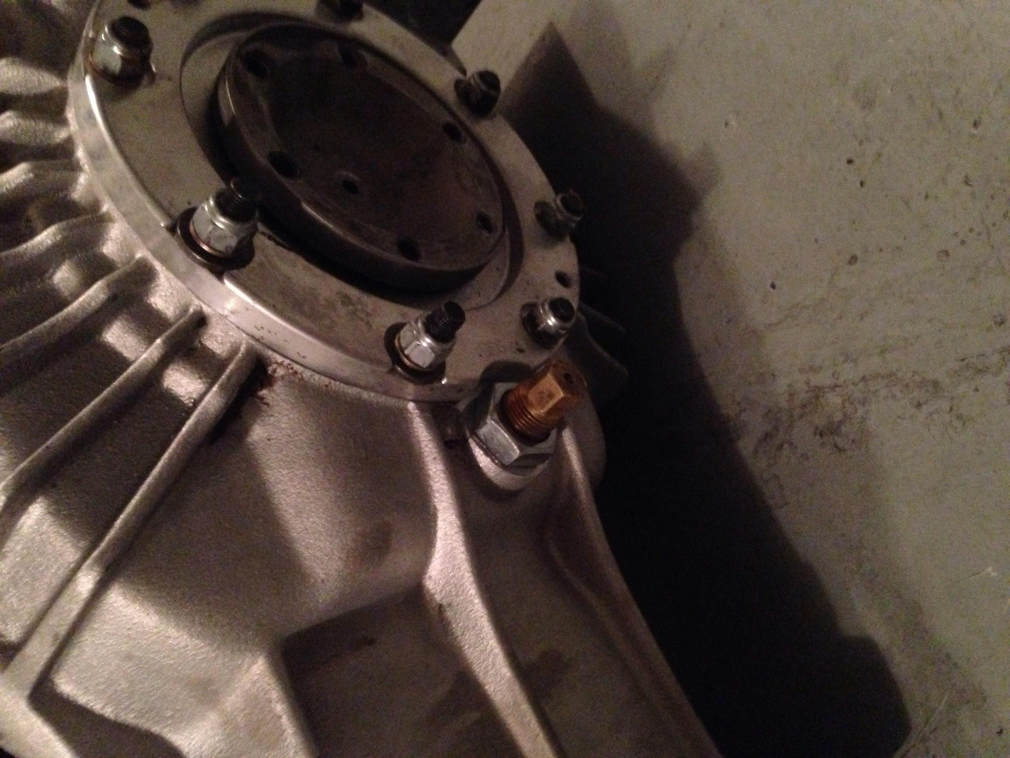

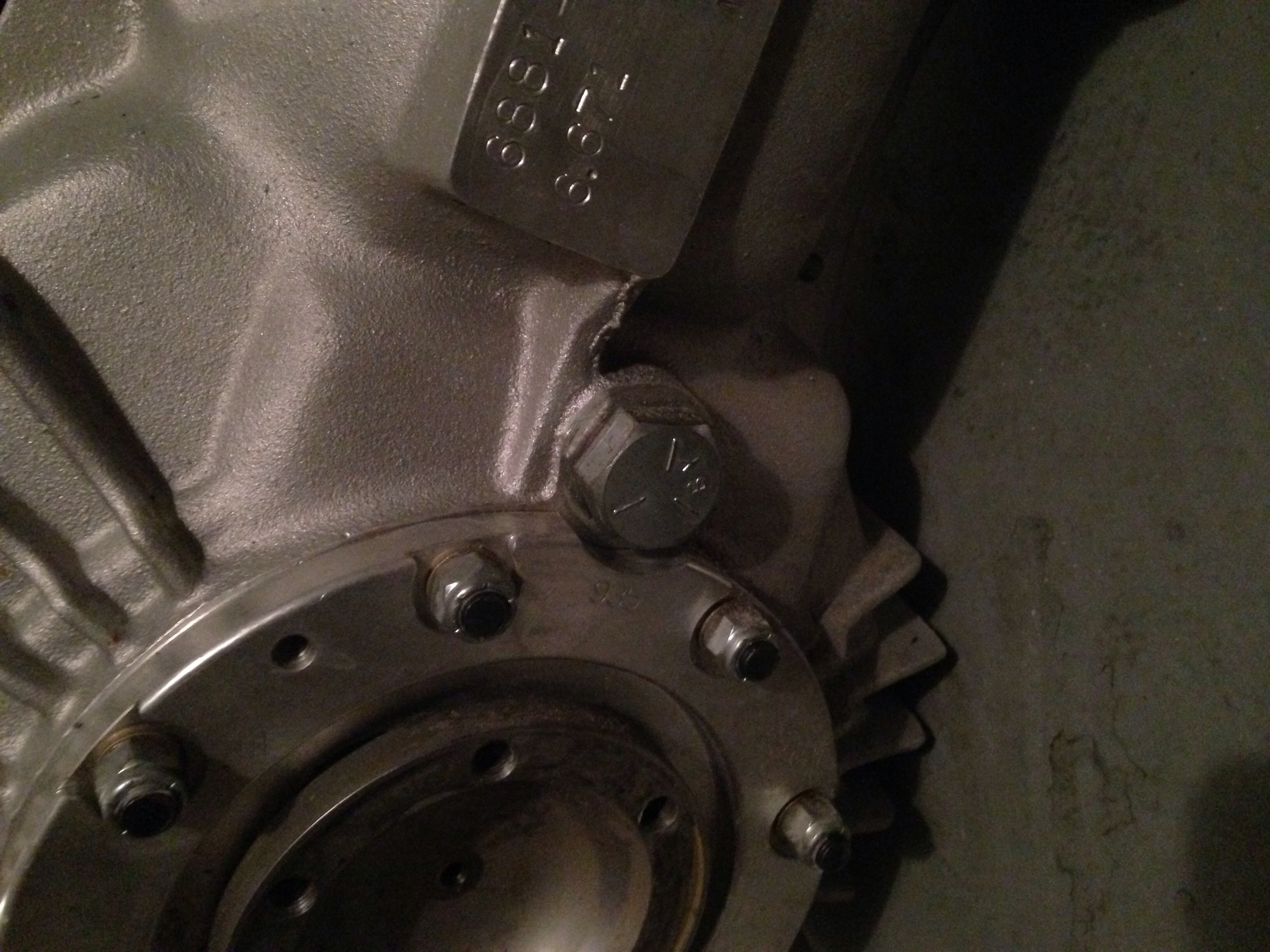

nwtdiesel Posted September 7, 2014 Share Posted September 7, 2014 (edited) Here ya go Chad. This is for our trans/engine set up with engine in rear and trans in front. Mendeola E box or 2D, I'm not sure about any other type of Mendeola as I only been researching these two models. The Allen plug in picture 3 almost directly below the "M" in the word Mendeola would be where you pull fluid from. The Allen plug in picture 4 or closest to the shift linkage/nose cone is where you would feed the fluid into. The big 1 1/8" bolt in picture 1 is the fill plug. On the bottom of the trans is a 17mm Allen drain plug (no picture) the bolt with the set nut in picture 2 is for the ring gear so don't mess with it. Hope this helps. Don't know why but pictures rotated when uploading from my phone and won't upload in order. When I install my set up I'll do a write up and post better pics and do it from a desk top. Edited September 7, 2014 by nwtdiesel Quote Link to comment Share on other sites More sharing options...
