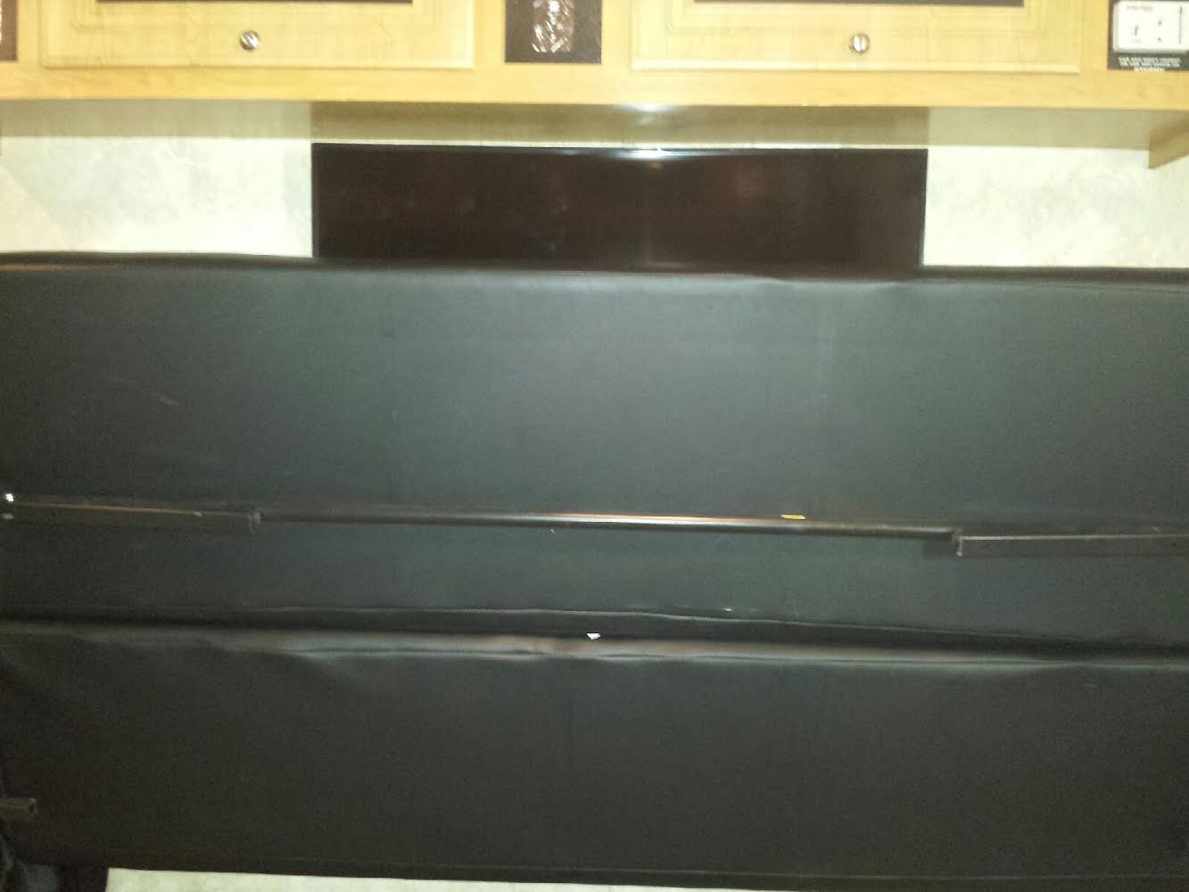

I think I've seen someone install the mount on the ramp and just take the tv off and place on a bed during transport or loading/unloading. Don't know if there's enough room with most drop down beds though

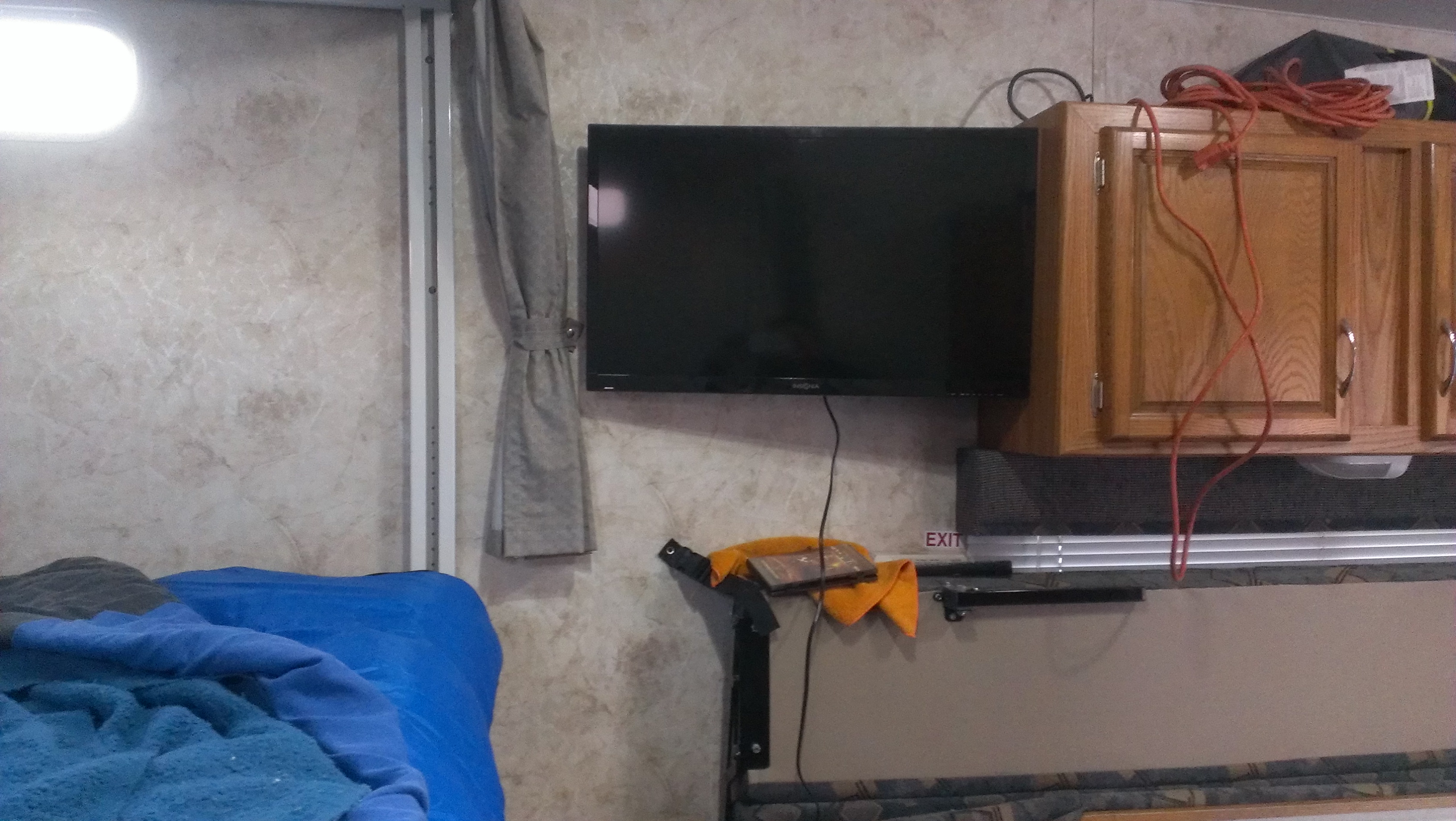

I mounted a 32" LED in my hauler. I remove it when driving and it's no real issue when parked.
the stud is just wood in there, and this TV is only a few pounds. I was considering using lag bolts and going all the way through the trailer but it wasn't needed for me. Mike has a HEAVY flat screen mounted to his wall and it's been fine for years. Also removed while driving.

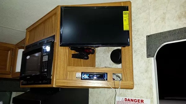

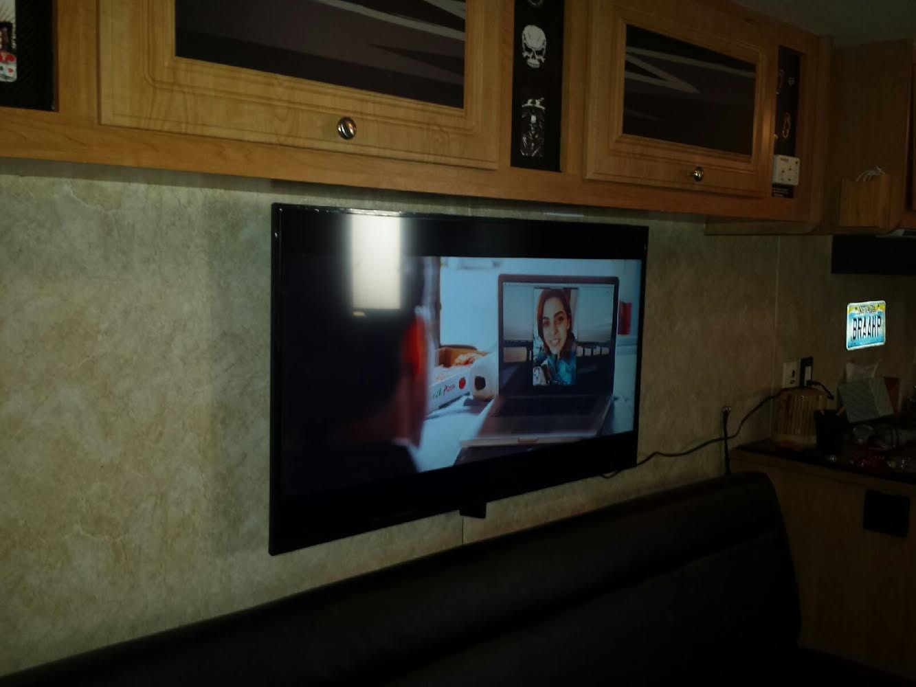

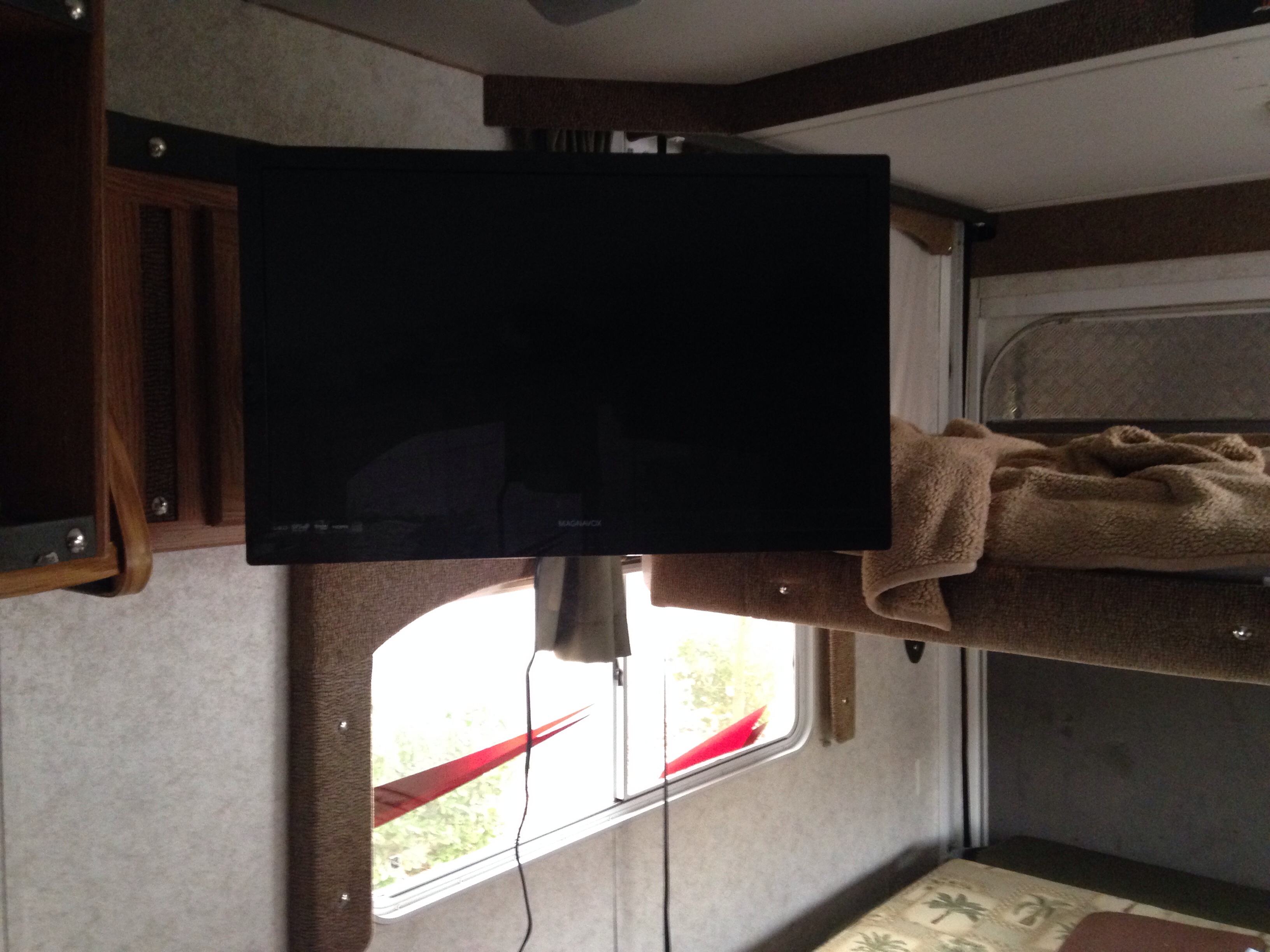

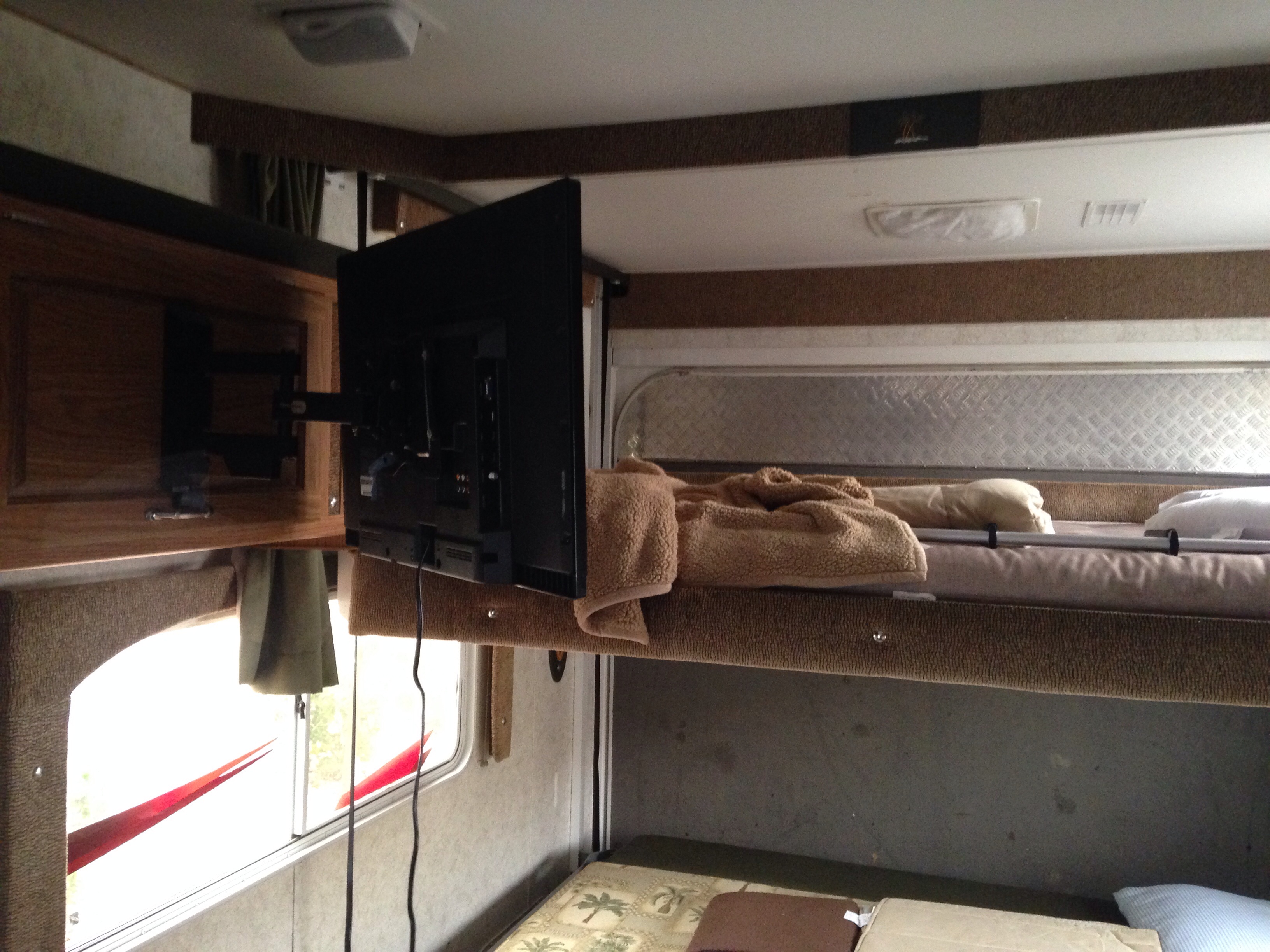

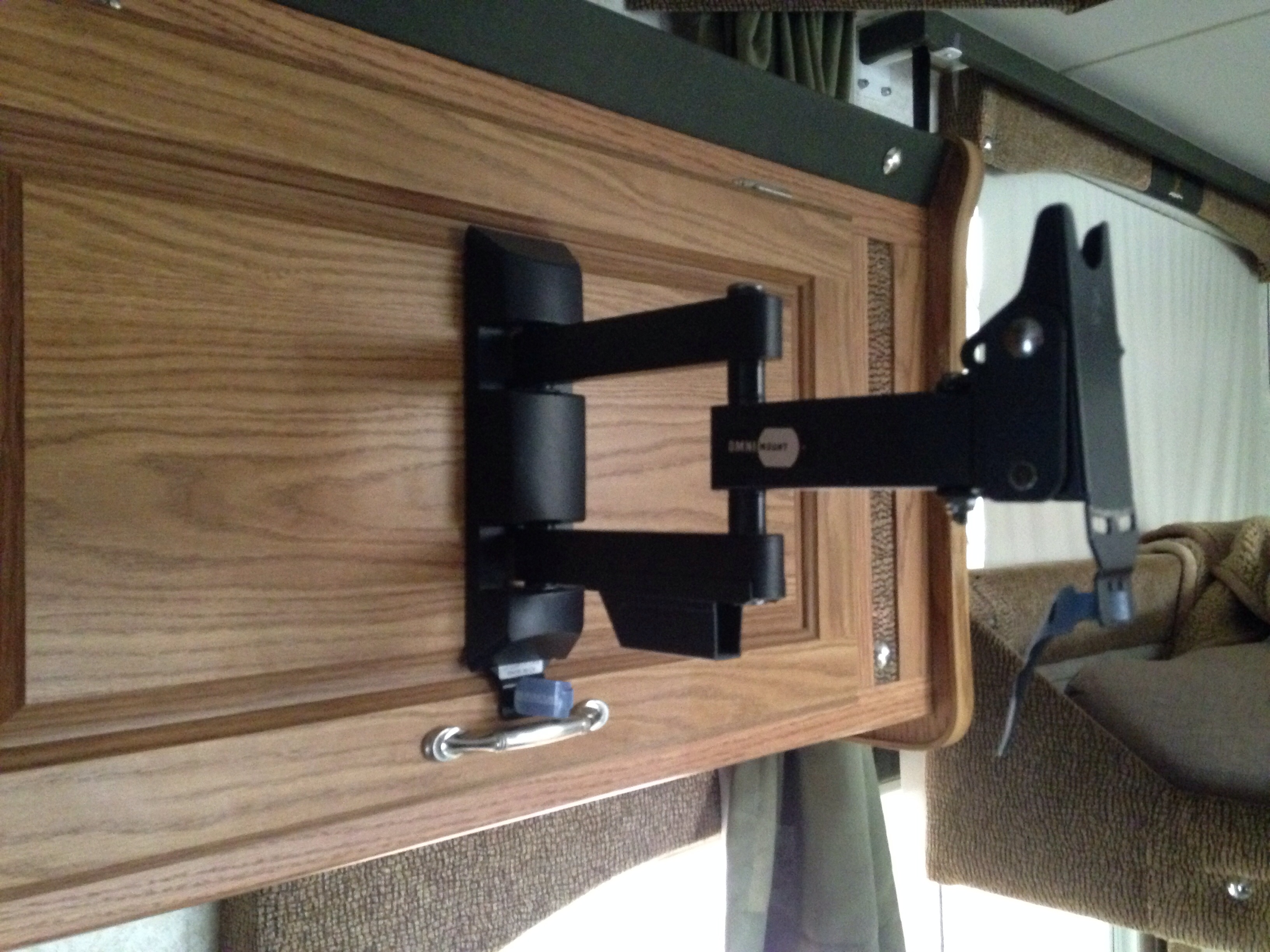

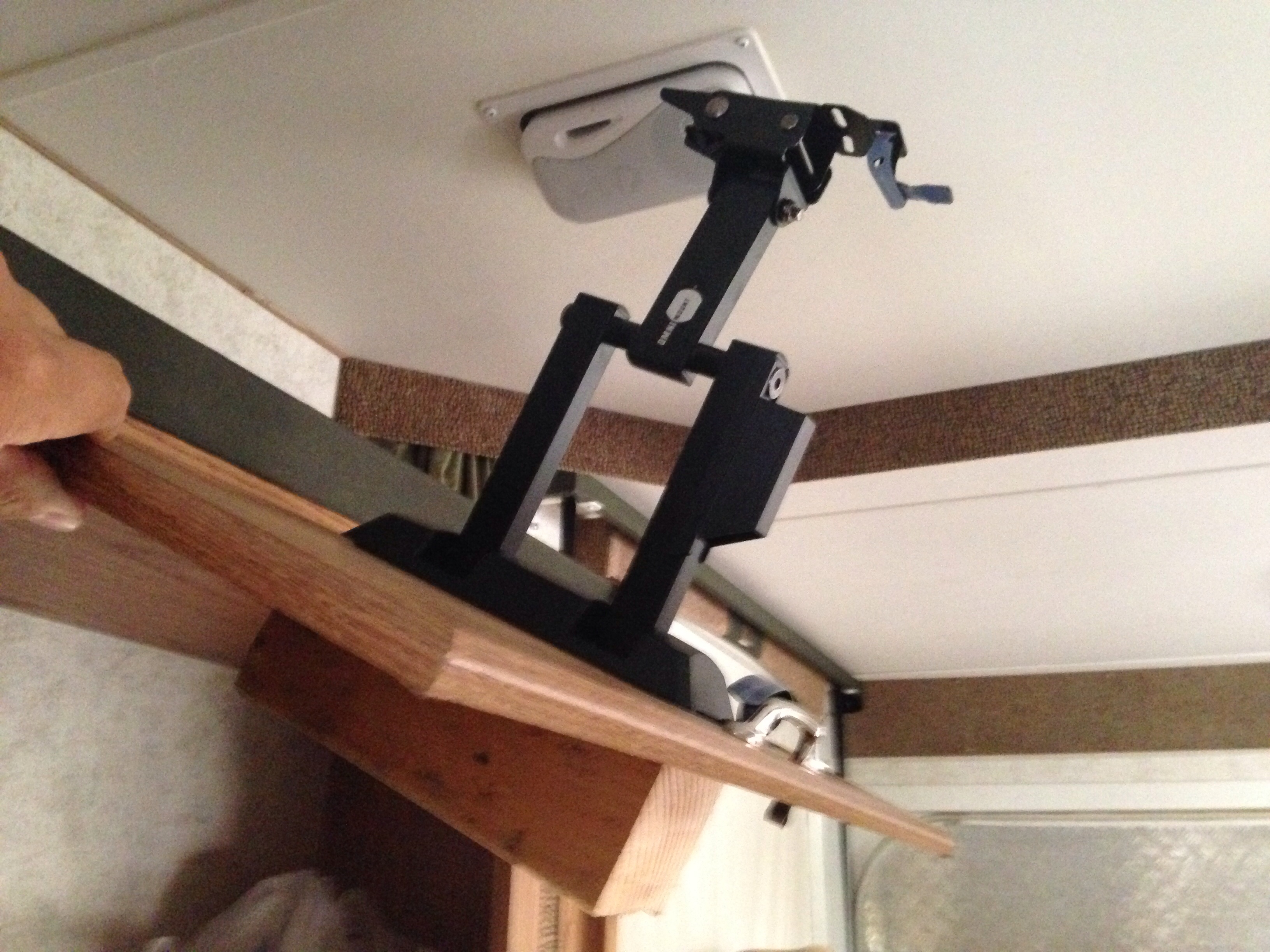

The most solid place I could find was one of the cupboard doors towards the rear by the double queens. I just screwed the mount to the door with some 2x4 pieces of plywood behind the cupboard door to add more strength. We can still use the cupboard if needed. I just hang the TV on the mount that's screwed to the cupboard door while camping then pull the TV down while traveling or while in storage. Mines a 40" I believe. Ill post pics tomorrow.
My cabinet doors come loose and fall off on their own. No way I'm bolting a big a$$ TV to it to help it out. LOL Looks like it works for your setup though. That TV looks pretty light, This 42" I have is pretty heavy.

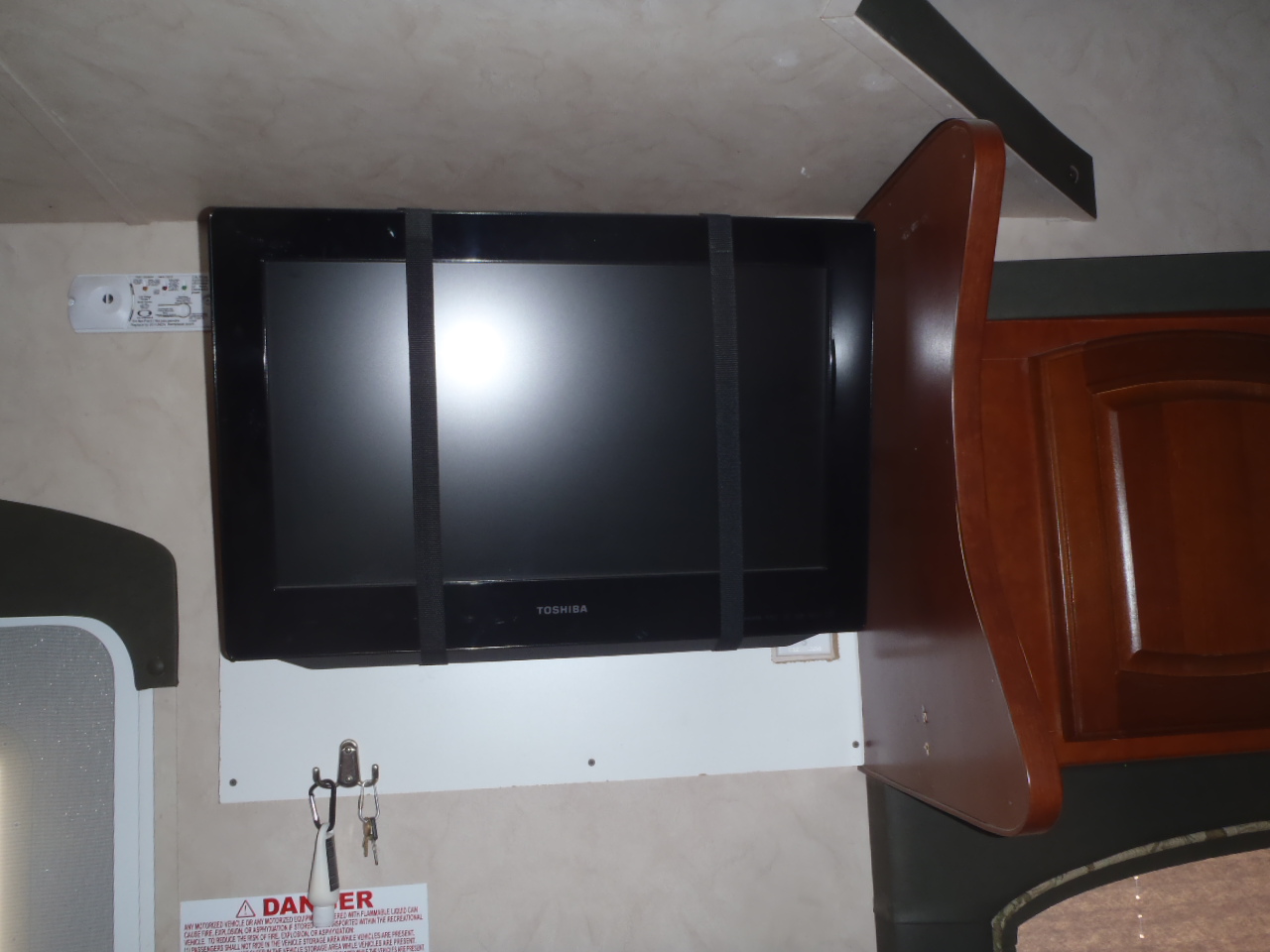

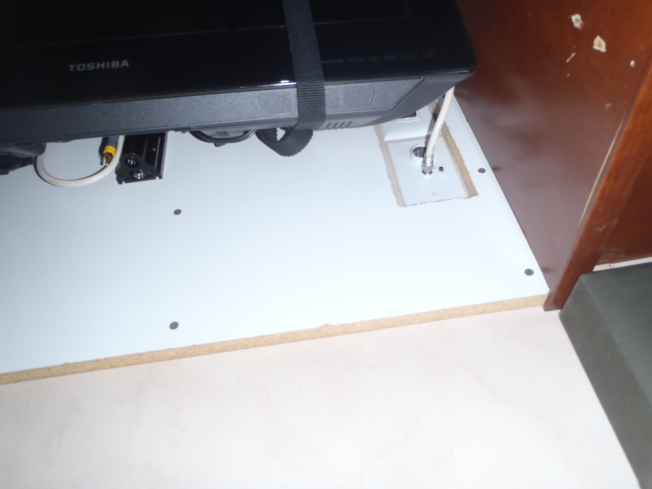

In our WW, I removed the tiny carousel and placed a backer on the wall this allowed a dual axis mount to be mounted while spreading the weight over 3 studs.
I'll post up some pictures in a day or so

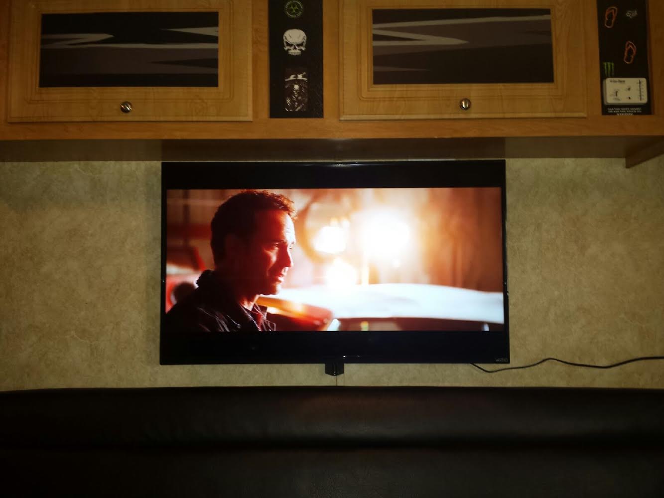

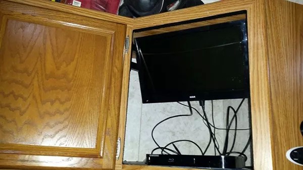

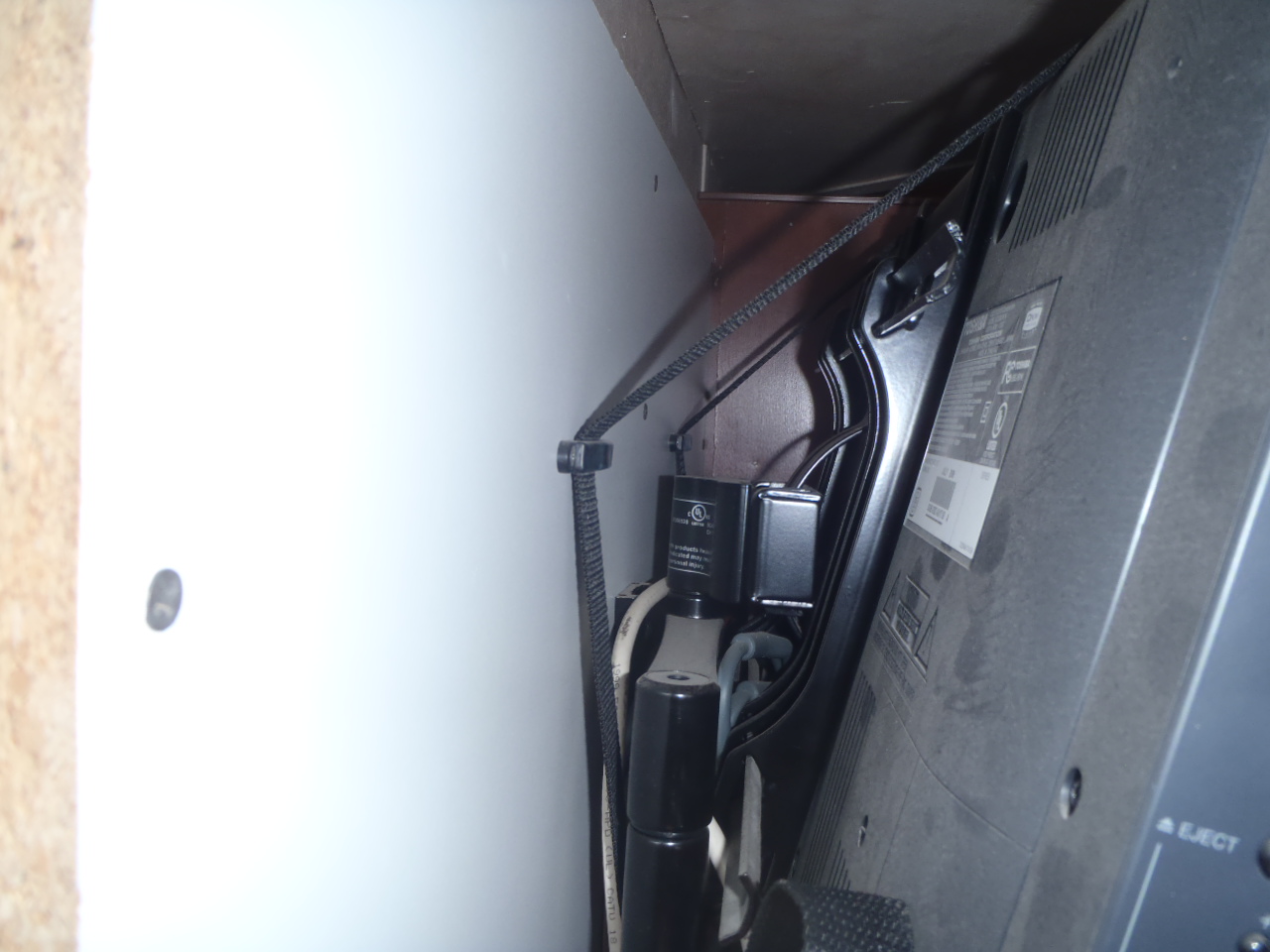

I mounted my 36/40ish size tv to the shelf that came with the TH where the old school big a$$ tv used to sit. I put the mount horizontal to the shelf and it folds down flat for the ride, then I just tilt it back up to watch tv.

Looks good, Craig. I might just have to go that route. Those new Vizios are great TVs and are super thin/ lightweight. I wish this extra TV I have weighed only 15 lbs. It's a bit heavier than that. Might just have to hang it in the garage instead. Thanks for the pics.
