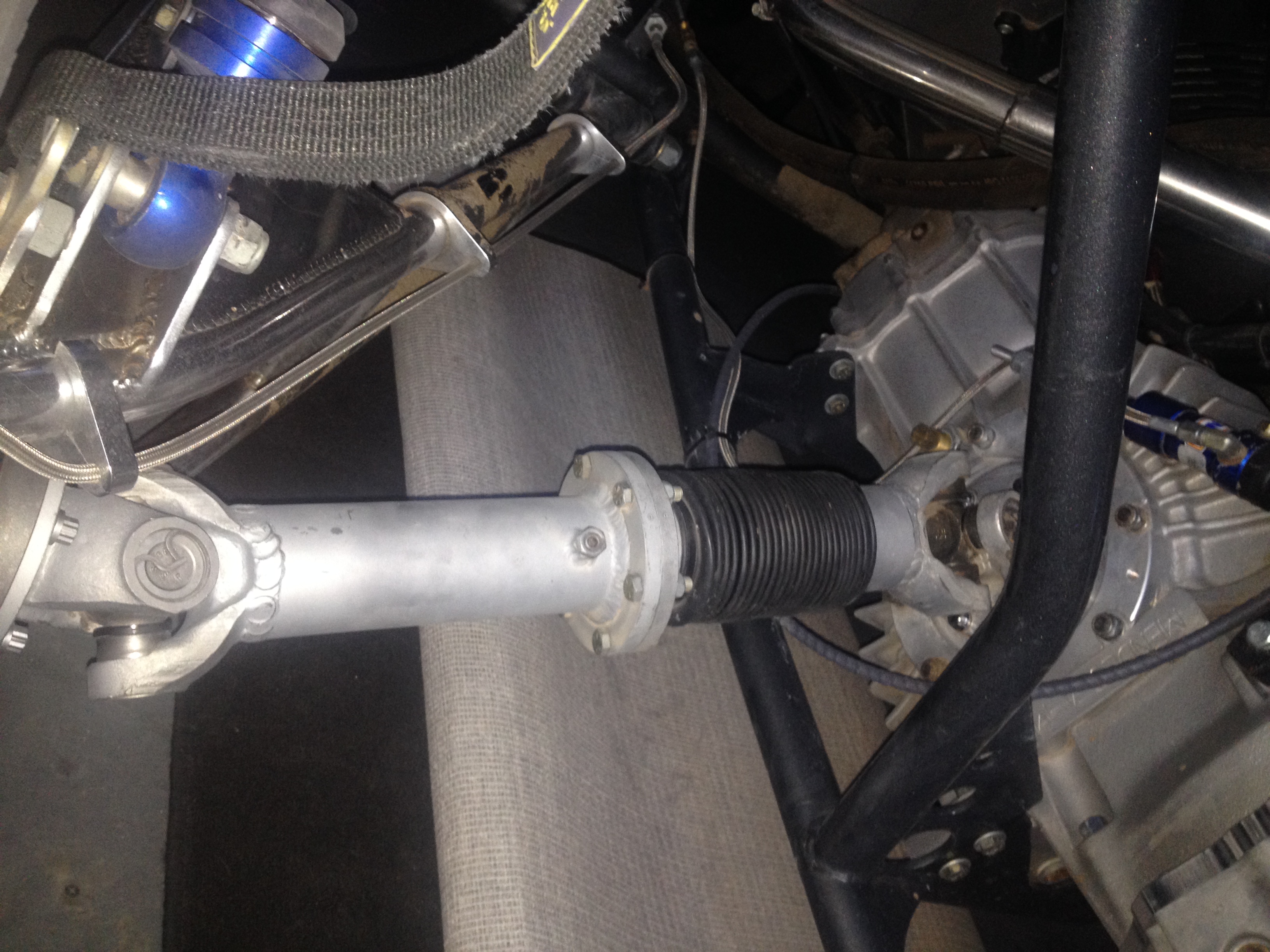

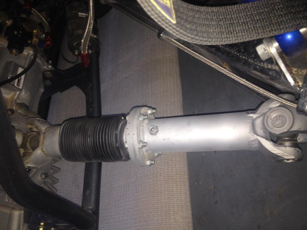

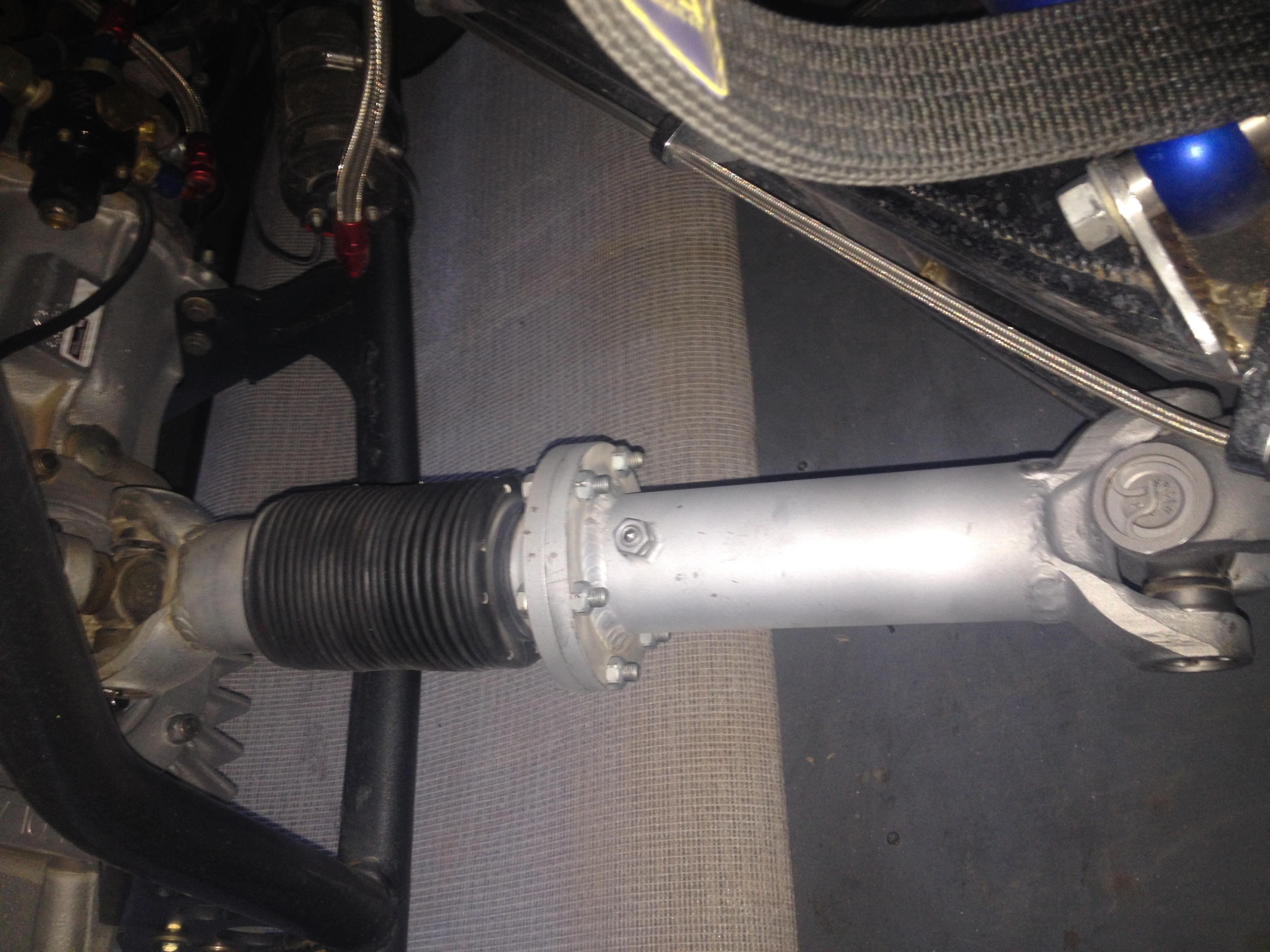

Just Mike Posted November 15, 2014 Share Posted November 15, 2014 The car I just got has extreme axles. I am getting a crazy vibration when I step on on the gas. It feels the car car is going to shake apart. I am just wondering if these axles wor cause this? I have always ran cv joints in my other cars Quote Link to comment Share on other sites More sharing options...
raspadoo Posted November 16, 2014 Share Posted November 16, 2014 I owned a car with them and a friend has had them in an extreme platinum for 7 years or so with no issues except shearing the sacrificial bolts a few times. Hows the angle on them? if the cars geometry left too much angle for cv's they may have tired these but angle may be too much for them as well. Also keep them greased and sliding freely, another company tried to make these (high angle drivelines) and took out a lot of trailing arms / transmission cases. Personally, I would check angles and switch back to cv's axles. Quote Link to comment Share on other sites More sharing options...
Just Mike Posted November 16, 2014 Author Share Posted November 16, 2014 There is nothing in the tires. I just checked them. I was hoping they were out of balance. I am stumped here. It was shaking so bad it made a motor mount bolt come out and the other one was on its way. Quote Link to comment Share on other sites More sharing options...
Sandemon Posted November 17, 2014 Share Posted November 17, 2014 Are the U-Joints in phase one spline off can do nasty things Quote Link to comment Share on other sites More sharing options...
Just Mike Posted November 17, 2014 Author Share Posted November 17, 2014 Are the U-Joints in phase one spline off can do nasty things They look right to me from what I have been told. I dont even see how you could get them one spline off. I would love for that to be the answer Quote Link to comment Share on other sites More sharing options...
raspadoo Posted November 17, 2014 Share Posted November 17, 2014 (edited) put it on jacks and get the drive train turning, see if you can isolate. any play anywhere (bearings etc) when on jacks? looks like the angle sweeping back may be pretty severe in the pics but hard to tell. What kind of chassis is that? Quicksand? Edited November 17, 2014 by raspadoo Quote Link to comment Share on other sites More sharing options...
Just Mike Posted November 17, 2014 Author Share Posted November 17, 2014 I will get it on jack stands tomorrow. It is a 2006 Ricochet. I put it up in the air at dumont and could not find anything. I have looked at all the obvious stuff. These axles are the only thing I have no experience with. That why i suspected them. Quote Link to comment Share on other sites More sharing options...
