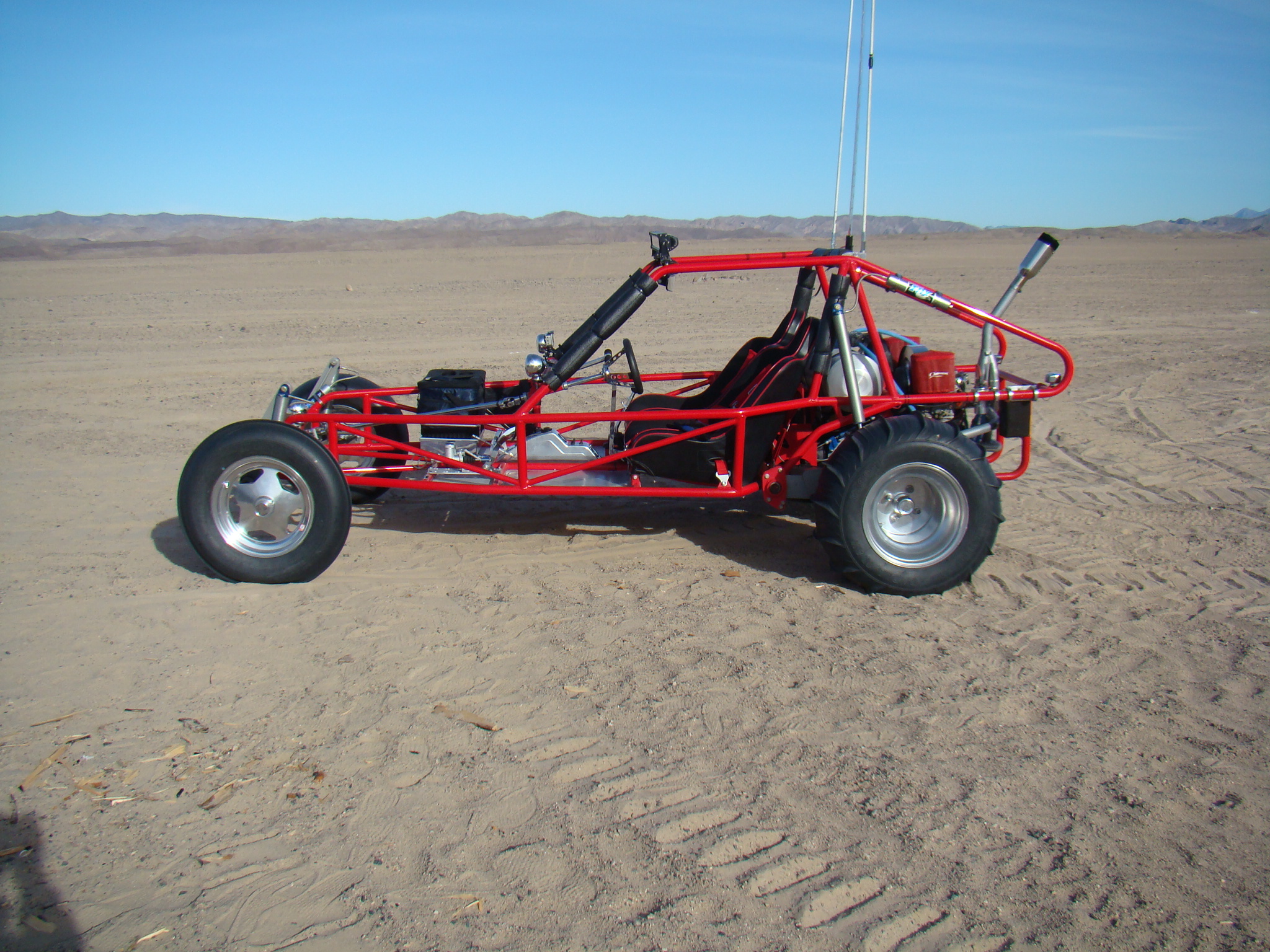

Mid-travel Sandrail fugitive frame with a New 2110 VW motor
New EMPI Auto Linea aluminum bubble top full flow engine cases, 8mm chromoly studs.
New 82 mm stroker crank with standard size bearings.
New H-beam rods 5.5 VW journals.
New straight cut Skat gears.
New Engle W-110 cam and bearings.
New 28mm lifters.
Mahle 92mm pistons and barrels.
CB performance heads.
Dual 44 DF webers, redline rebuilt kit, new jets.
MSD Digital 6AL ignition.
Compfire electronic ignition and high voltage coil.
EMPI high flow steel oil pump.
Engine was balanced.
type 1 swing axle newly rebuilt by RC trans of Las Vegas
4.86 super ring & piñon, 1st gear 3.78, 2nd gear 4.06, 3rd gear new weddle gear 1.70, 4th gear 1.73
New swat away chrome axles
3x3 boxed arms
CNC rear disc brakes with turning brakes, CNC peddle assembly
Fox shocks on all four corners.
Empi shifter, VDP oil and tach gauges.
New electric fuel pump.
PRP suspension seats with crow four point harnesses.
