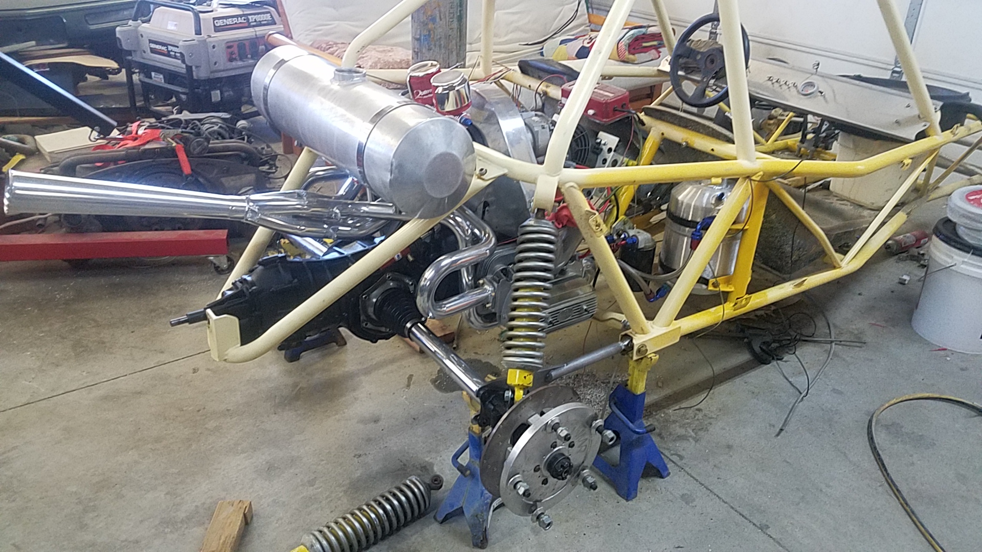

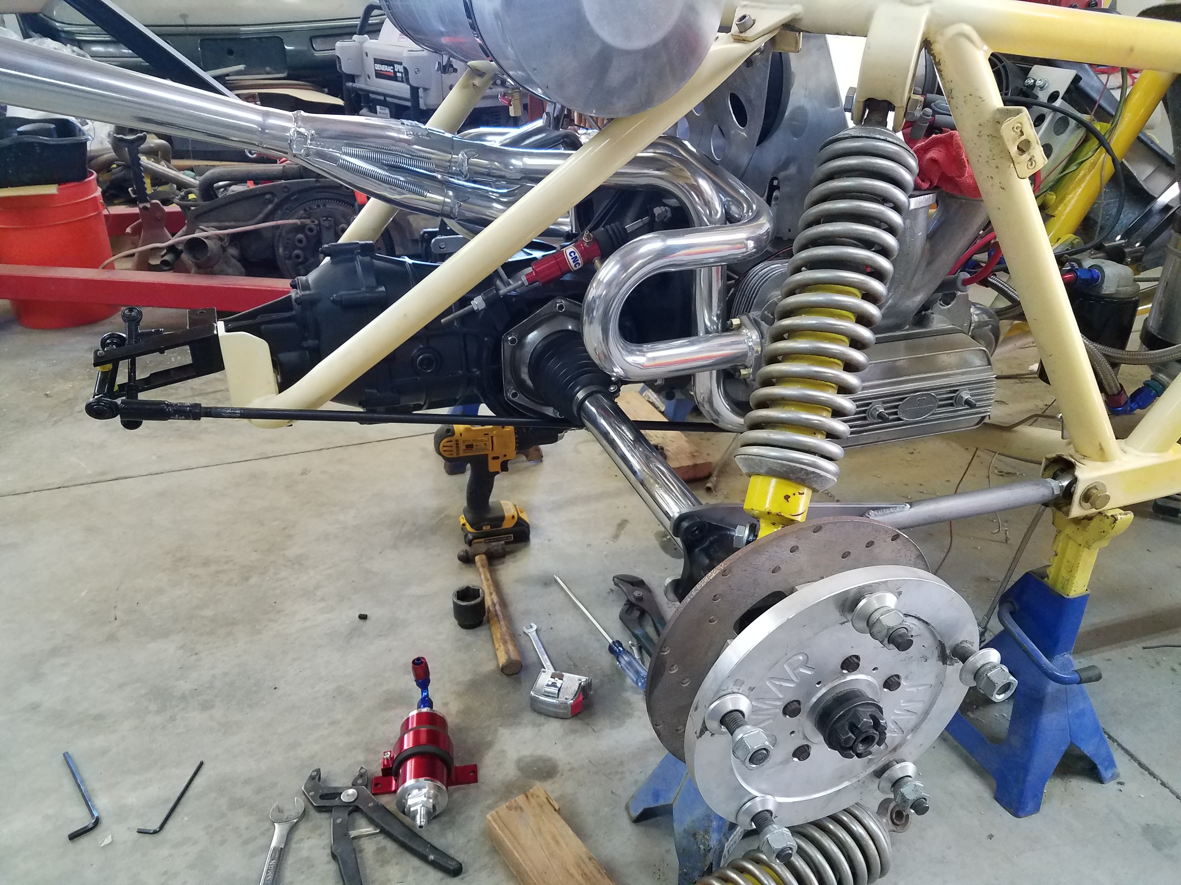

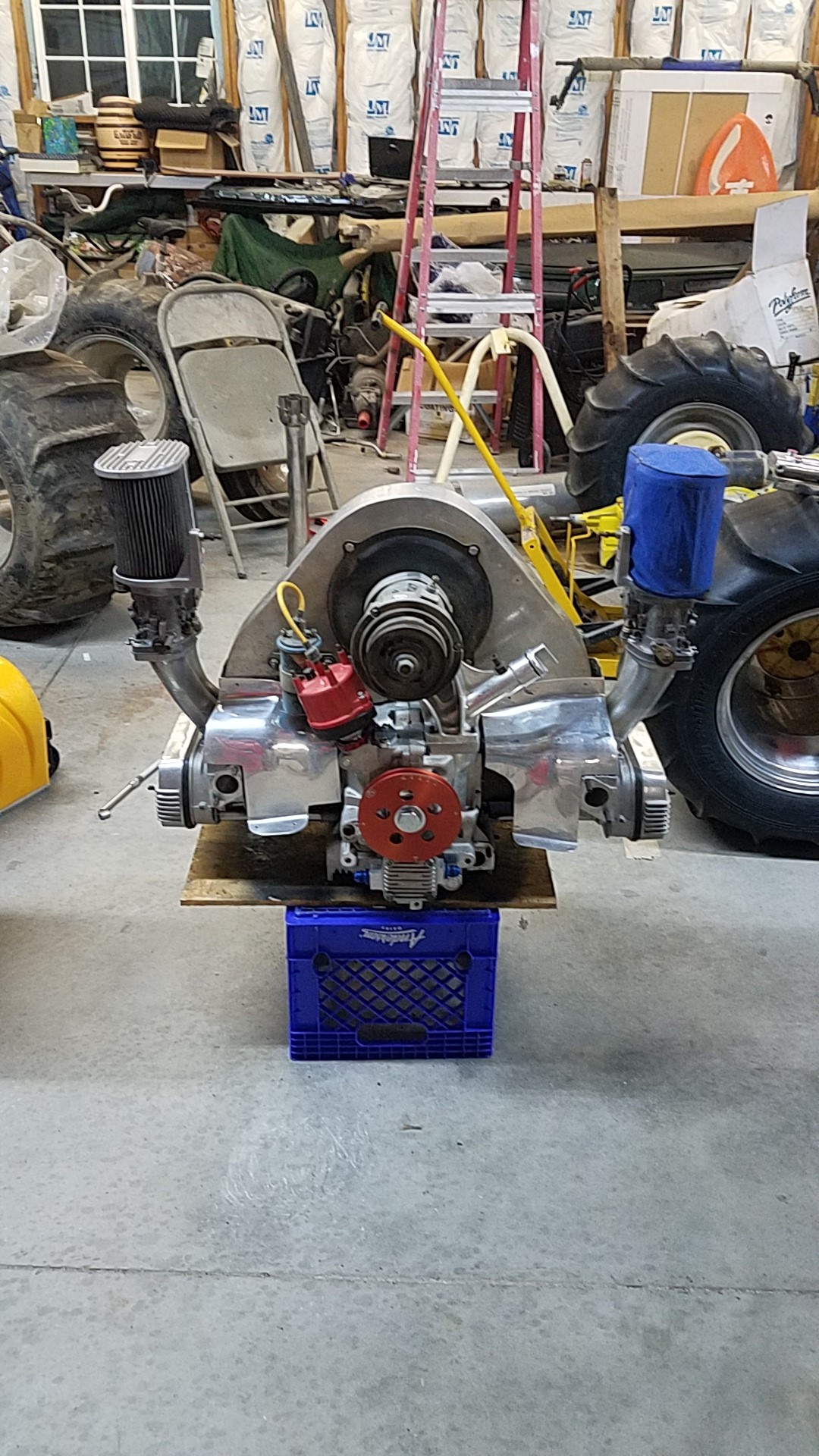

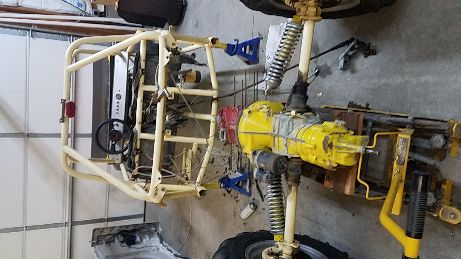

CrescentDuner Posted May 29, 2018 Share Posted May 29, 2018 (edited) I got a pretty good deal on a Sand Sprite IV buggy with body panels for Christmas. I have been working on it for the last 5 months trying to get it ready for this summer. So Far I have replaced everything... It had been sitting for best I can tell about 15 years. Built a new motor, 2332, with parts from CB. Added an oil cooler with fan and dry sump tank. Replaced all the wiring, it had THHN wire and Romex in it. New seats, switches and gauges. Replaced all the hydraulics for brakes and clutch including lines. Ended up replacing the hydraulic throttle with a control cable. Also change the drum brakes to JaMar 4 piston brakes. Replaced everything in the fuel system. Added a MSD 6AL. Have a fuel injection system for it also but going to try out the Webers to see if I was able to fix them first. New tires and wheels. It needed new or at least the original trailing arms. Was surprised to find Prowlers out of business. So I made new ones out of CM and heim joints. Trans too was bad. Think that is why it was parked, It lost a fulcrum plate and whipped out the diff and side gear. Still putting it together but looking for some help on the shifter. It came with a JaMar shifter that was seriously rusted. I was able to get it apart and revitalize it but when I took over the trans to Metal craft he made me a deal on a prowler shifter. I'm looking for any info on the darn thing. Pics of an installed shifter and tube would be cool. I have only seen one in person in the last 30 years. Would like to put it on for old time sake. I'm thinking that the JaMar will probably work but not sure about getting it all adjusted right will be fun. I also have a new AJ speed shifter for another project that I have been working on that I might use if I can't find any info on the Prowler one. Any help would be great. Google has been no help. Edited May 29, 2018 by CrescentDuner Quote Link to comment Share on other sites More sharing options...
sandawg Posted May 29, 2018 Share Posted May 29, 2018 How about posting some pictures. Would like to see what your doing as I had one with a 2110 Turbo in mine. Quote Link to comment Share on other sites More sharing options...

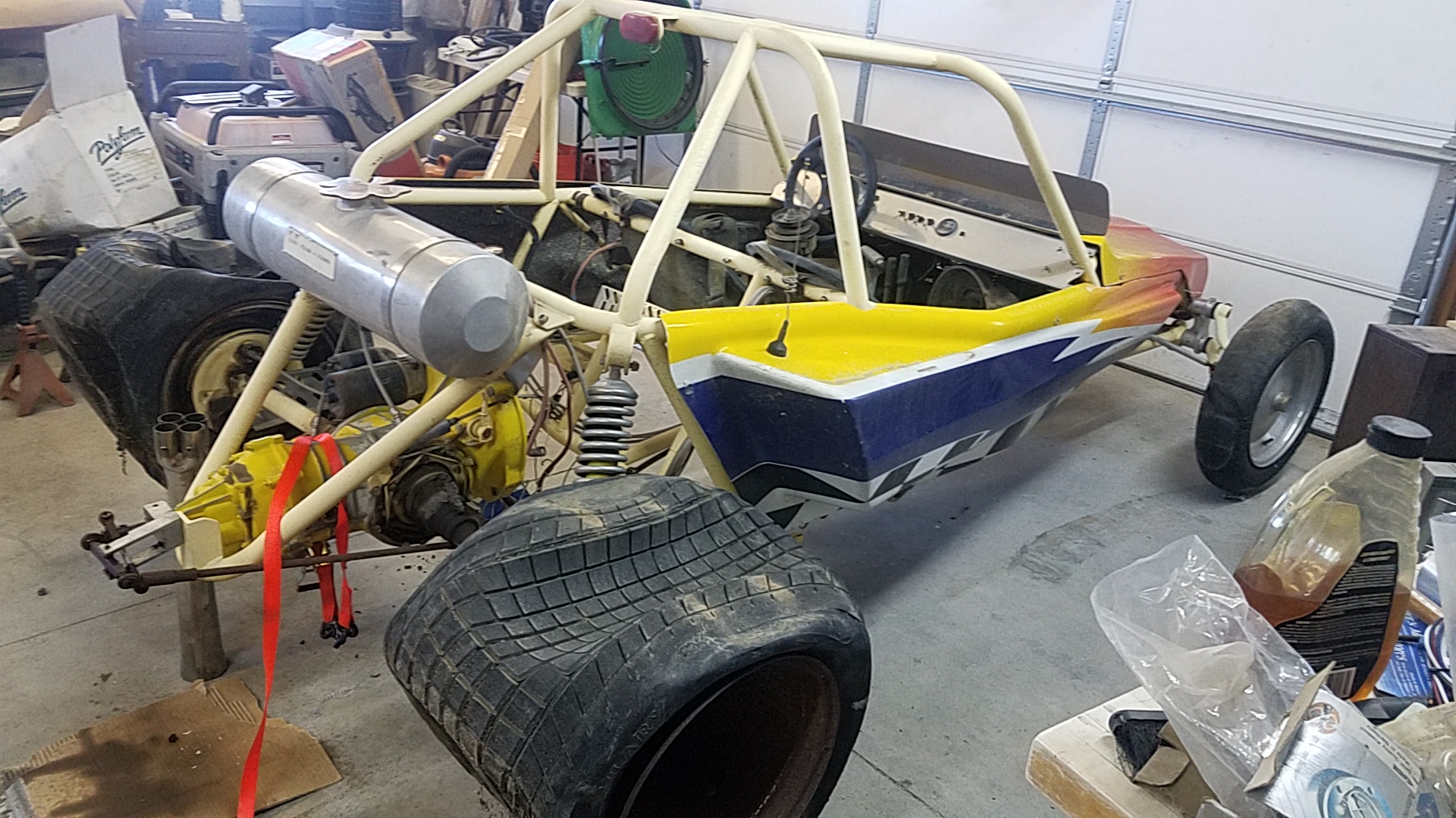

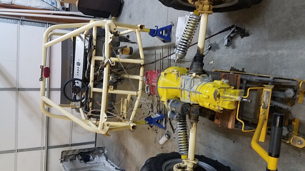

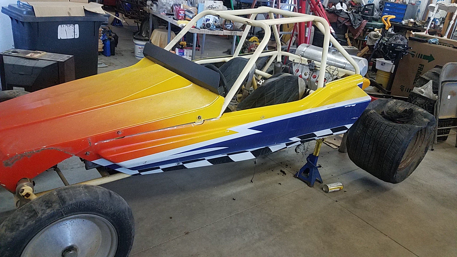

CrescentDuner Posted June 1, 2018 Author Share Posted June 1, 2018 This is what I started with. Taking it apart and the motor going in... Quote Link to comment Share on other sites More sharing options...
