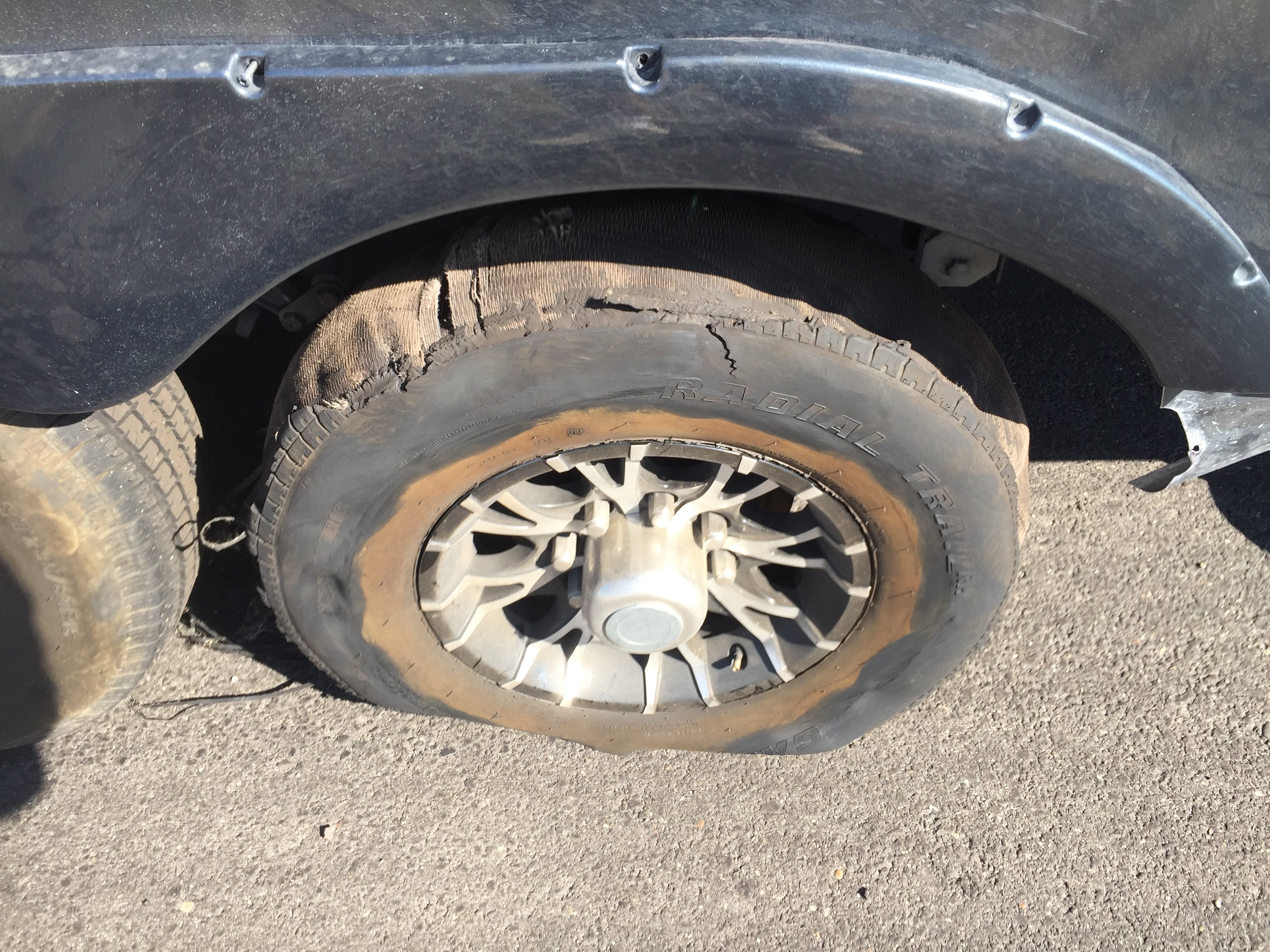

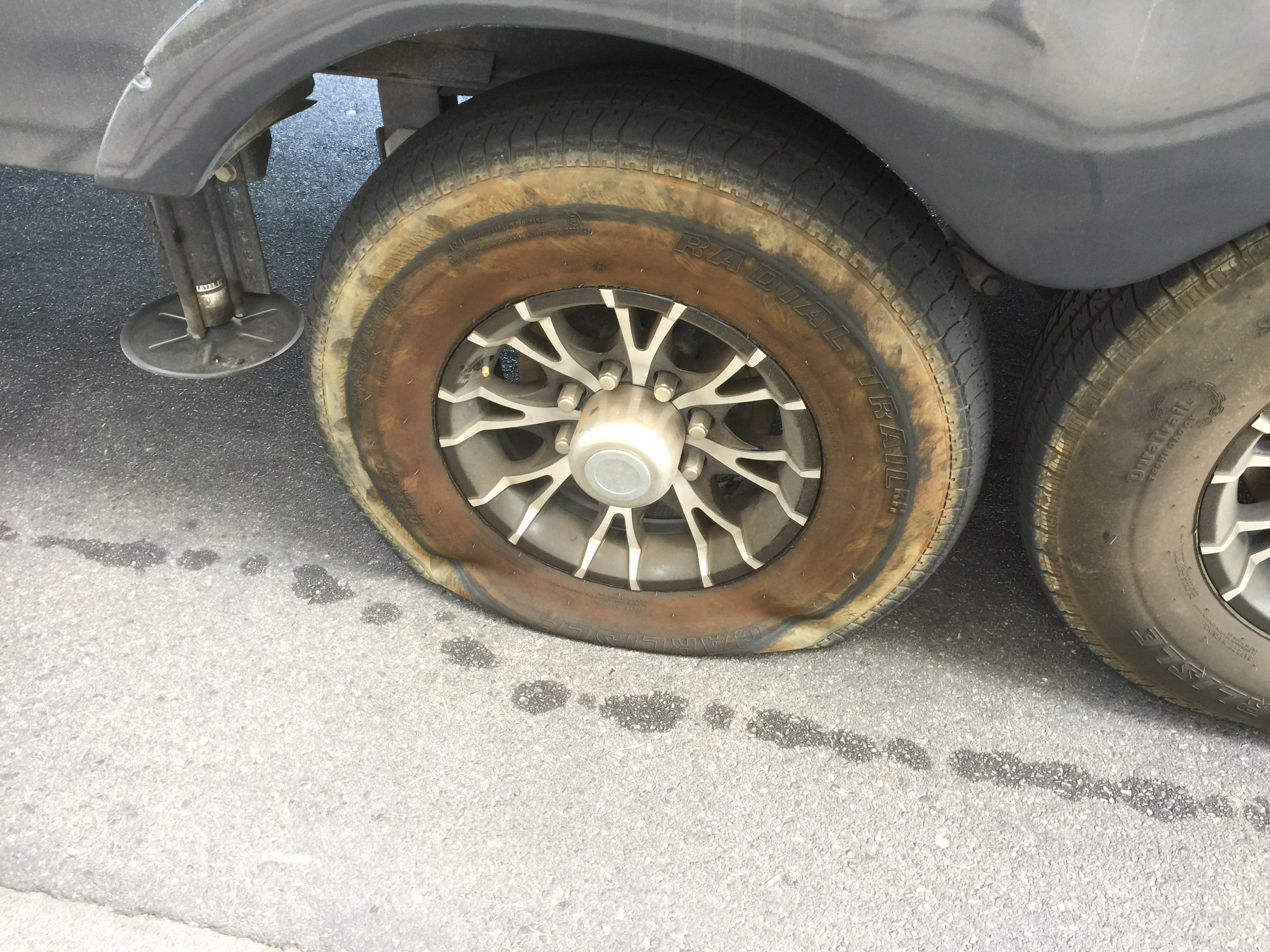

The tires that came on our Toy Hauler were showing signs of tread separation at 1100 miles so we went in for new.
I check tire pressure every leg of our trips it’s essential.
Americas / Discount talk us into Carlisle’s, “they are making them better” they told us.
The new and Improved Carlisle’s grenaded in about 240 miles. Same day I bought them:

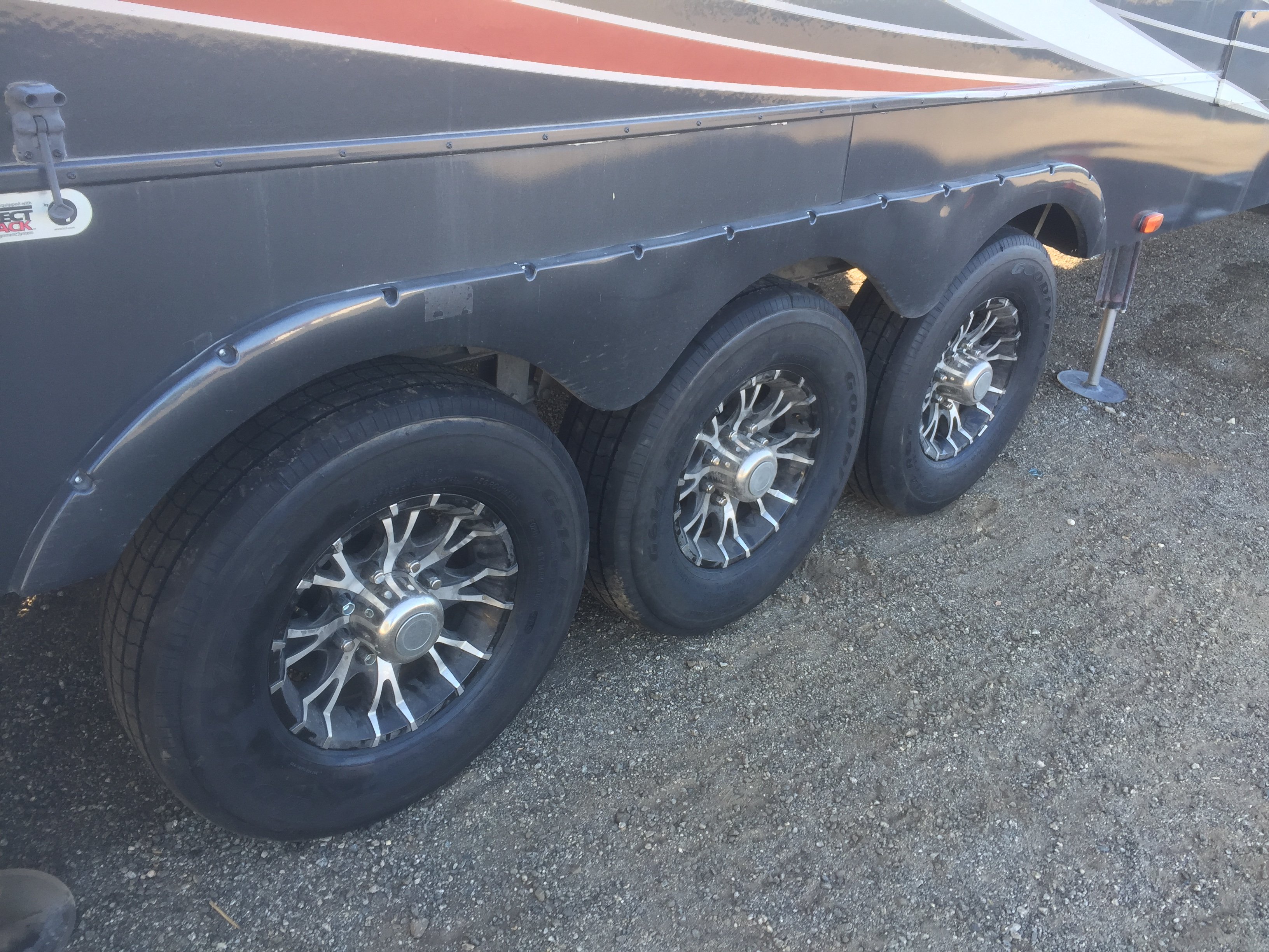

69CC1A1C-58D7-46C4-8FCE-C598E437B442.thumb.jpeg.7ff1acc0919e4b1e57cf024f4b213c60.jpeg4826F0F2-CCF7-46D0-95F3-8B1C9CC2D224.thumb.jpeg.cf8b3ea212abde90042df5ae16697e8b.jpegThis the first leg of a 40 day off roading trip . I found a truck tire shop and I put on 14 ply steel to save the trip and we moved on.
Friends with similar TH’s all have made the move to 14 ply.
China made was all the desert tire shop had in G rated 14 ply and they assured me they were good.
15000 miles later they are experiencing tread separation and took the trim with it.
So so today I moved up to American made GoodYear 14 ply Steel. Supposed to be the best I hear:

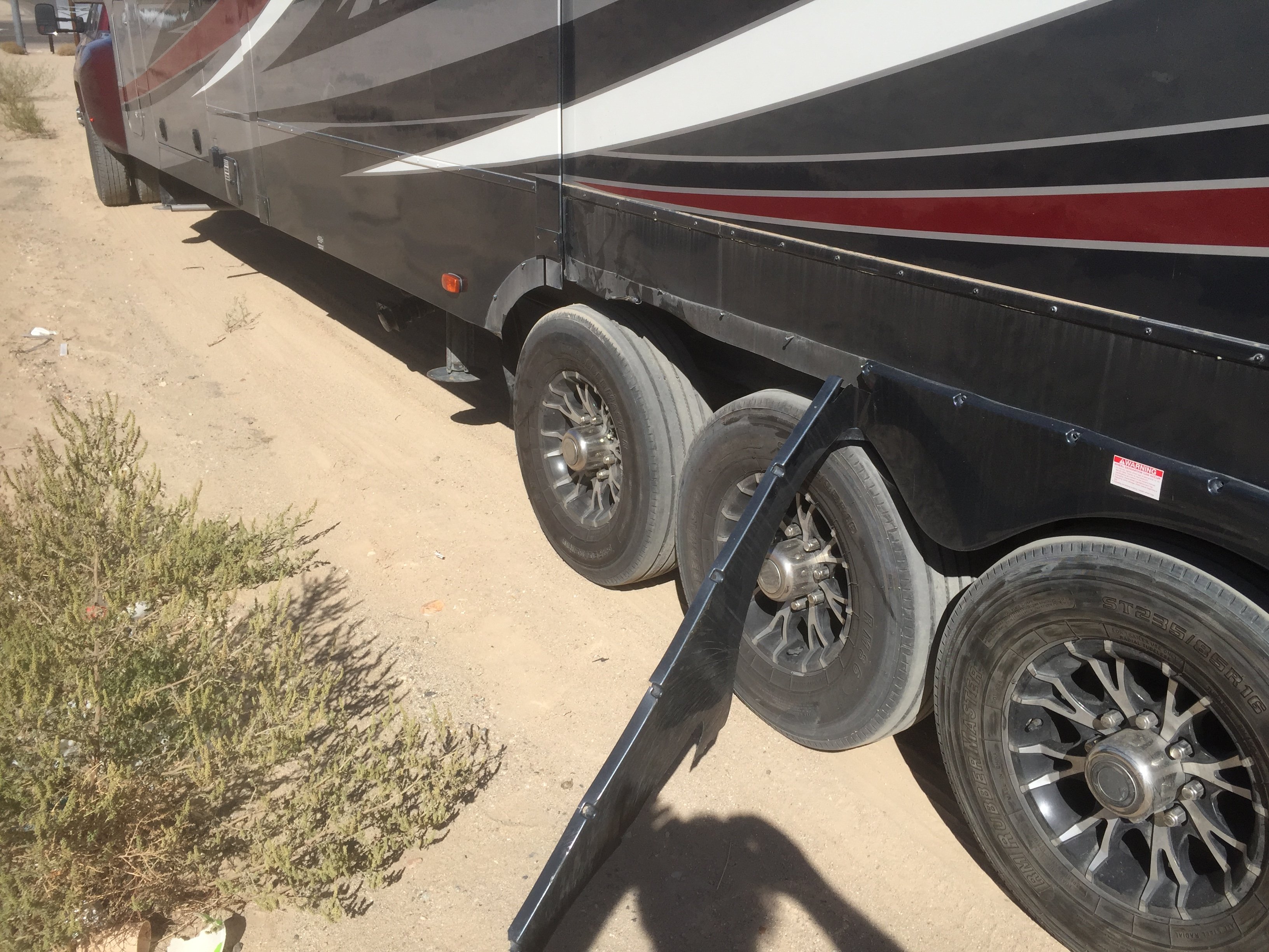

Heading back from Dumont I experienced the tread separation in Palmdale so I simply pulled into the Elks campground to deal with the issue.
$15 a night full hookups. $2.75 16 oz Shock Tops and a huge dirt section next door to run the X3.
The Tire Store had the Good Years I wanted but a MFSOB to pull this 43’ rig in there so I took the tires off at the RV Park and hauled them in.
Asskicking heavy, I used a MC ramp to roll them in the truck bed. Use a floor jack under each axel to line up the studs. Heed that advise brothers. Hold that thought.

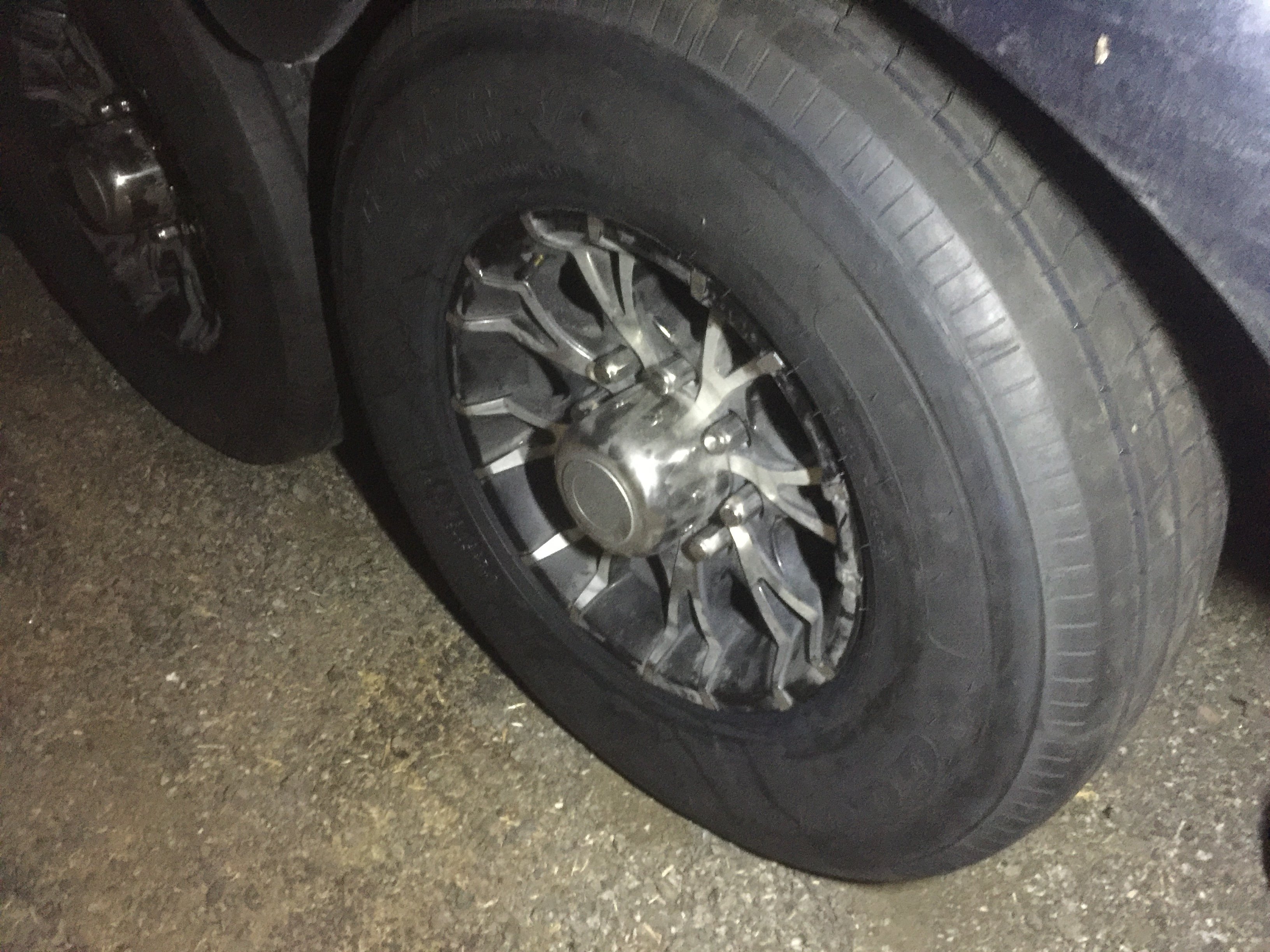

I learned the hard way with stock China bombs and Carlisle's as well. My current TH is the only one I've bought new. I changed the tires the day after I bought it. Wasn't going to risk it. I run Sailun S637 all steel 14 ply G rated tires. I know trying to save $ on tires is usually a regrettable decision. But they actually have a huge following and great reviews. Had them on my 43' TH for 2 years now and they look brand new. Besides the one I had to plug. Lol. Damn nails in a new housing construction.
Next time you're in the market, look them up.
They used to be labeled LT, with the higher speed rating. Due to something to do with importing them, they had to re label them for trailer use only. Same tire though, so you still get the G rating with the higher speed rating of an LT.
