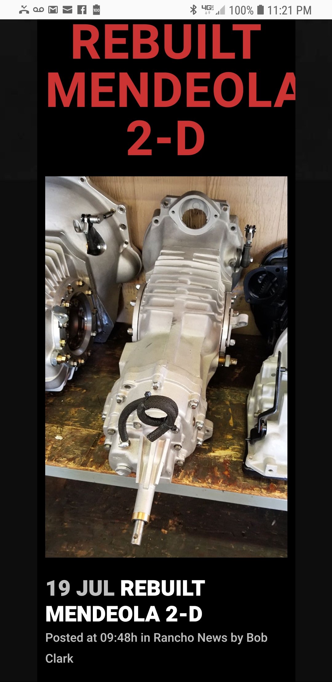

Cannon Smith Posted January 1, 2019 Share Posted January 1, 2019 I've got a leak at the rear , where the shifter connects, can I just pull that back section and replace the seal .. Quote Link to comment Share on other sites More sharing options...
dunefreak Posted January 1, 2019 Share Posted January 1, 2019 Yep, just pull the linkage off then unbolt that rear housing part of the case. The seal presses into the end. It's pretty easy. 1 Quote Link to comment Share on other sites More sharing options...
