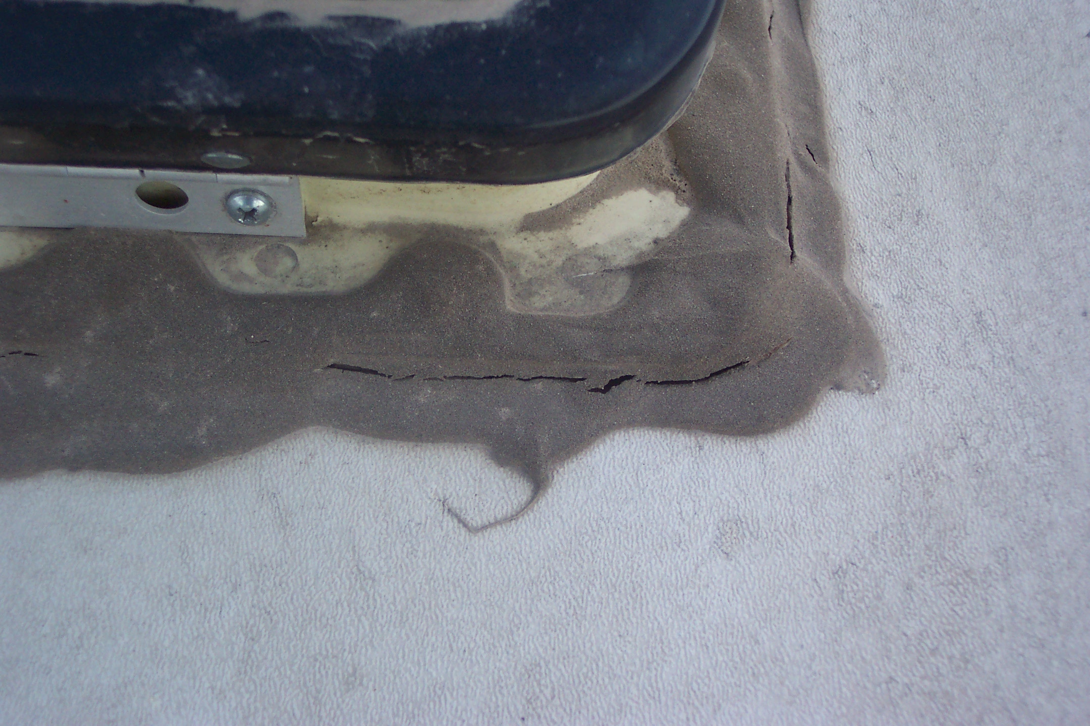

lindernglamis Posted January 8, 2006 Share Posted January 8, 2006 I just went on top of my hauler and I notice that around some of the vents and other stuff the caulking has split some. Is this a normal thing for 1year old trailer? Quote Link to comment Share on other sites More sharing options...

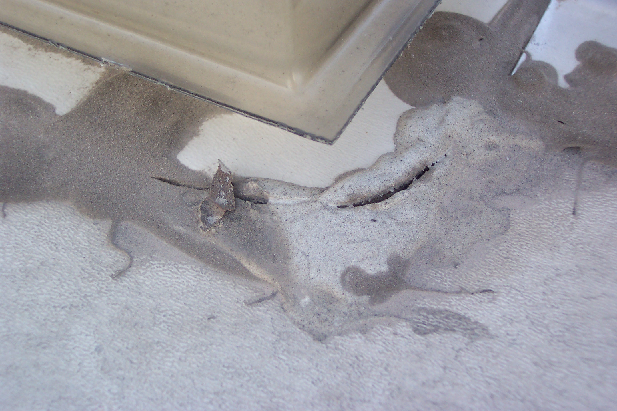

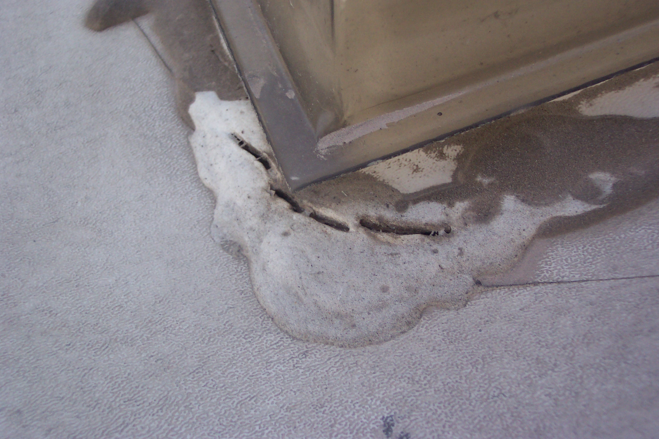

lindernglamis Posted January 30, 2006 Author Share Posted January 30, 2006 Here are some pics Quote Link to comment Share on other sites More sharing options...
dunefreak Posted January 30, 2006 Share Posted January 30, 2006 I think mine has some small separating like in this pic you posted... It must be some cheap caulk/ sealer that can't hold up to the heat on the roof. I'd just go over it w/ some good sealer from HomeDepot or something. Quote Link to comment Share on other sites More sharing options...
ynot Posted January 30, 2006 Share Posted January 30, 2006 I think mine has some small separating like in this pic you posted... It must be some cheap caulk/ sealer that can't hold up to the heat on the roof. I'd just go over it w/ some good sealer from HomeDepot or something. You may want to check with camping world etc. I think they use a different type caulk/sealer on rubber roofs. I always buy mine at camping world as it is made for rubber roofs. It is a yearly task to check and repair sealant around vents etc. I also always rinse off and about every 3rd time washing the coach take my brush and soap up on top and give it a good scrub after checking the sealant. Quote Link to comment Share on other sites More sharing options...
