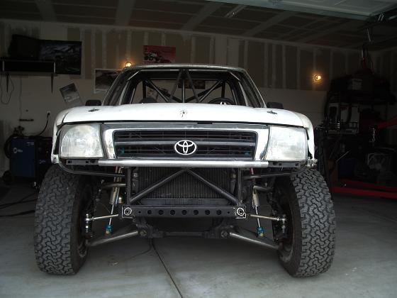

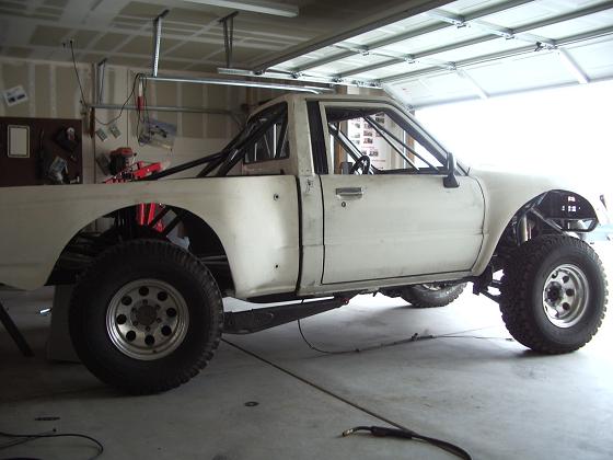

anarchist Posted December 17, 2005 Share Posted December 17, 2005 didn't know where else i could post this,this is the long travel truck im building, i have done 100% of the work on this truck except frt a-arms those were bought before i knew how to weld. Quote Link to comment Share on other sites More sharing options...
anarchist Posted December 17, 2005 Share Posted December 17, 2005 `87 cab 2000 taco update full fiberglass Quote Link to comment Share on other sites More sharing options...

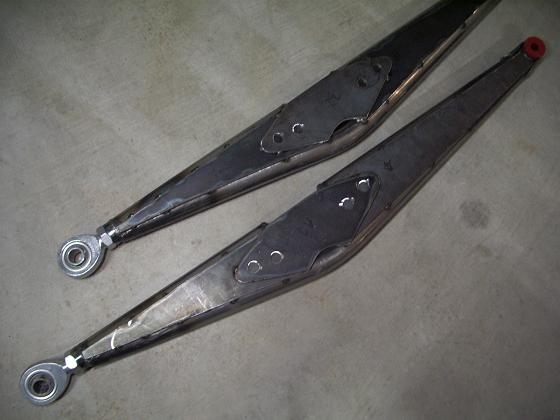

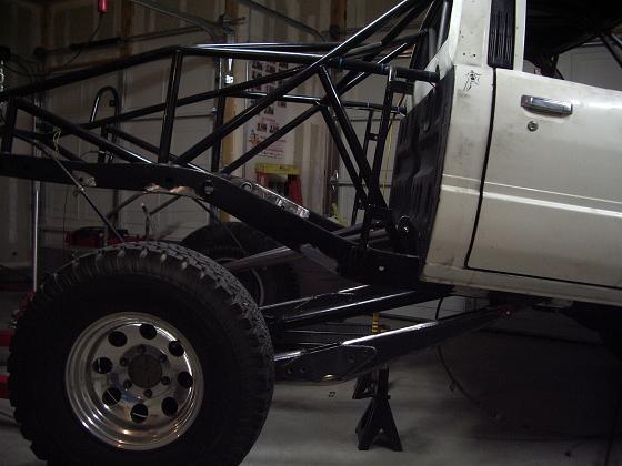

anarchist Posted December 17, 2005 Share Posted December 17, 2005 3 link rear suspension i designed and fabricated, 1.25"teflon lined heims,lower tube is made from 1.75" x .250 wall, upper tube 1.75" x 120wall and plated with .188, still need to build shock bungs and finish all mounting points but the links will be bulletproof for the size of this truck Quote Link to comment Share on other sites More sharing options...
anarchist Posted December 17, 2005 Share Posted December 17, 2005 capable of two feet of travel with stock driveshaft but will be strapped at around 19" because how the rest of the truck is setup plunge is at 3/8" throughout travel Quote Link to comment Share on other sites More sharing options...

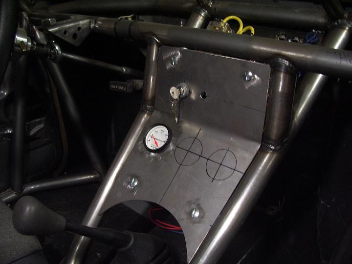

anarchist Posted December 17, 2005 Share Posted December 17, 2005 inside of cab, rewired everything and all wires are soildered,crimped and shrink tubed<---love fire but don't want to be a victim of leaking fuel cells and sparking wires. billet steering quick release, little dash using dzuz fastners,stewart warner gauges Quote Link to comment Share on other sites More sharing options...

superdave Posted December 18, 2005 Share Posted December 18, 2005 3 link rear suspension i designed and fabricated, 1.25"teflon lined heims,lower tube is made from 1.75" x .250 wall, upper tube 1.75" x 120wall and plated with .188, still need to build shock bungs and finish all mounting points but the links will be bulletproof for the size of this truck thats a real nice job your doing there. thats what i want to do to my luv truck. i kinda threw it together in a couple of months and it is all half assed except for the drive train. where are you located? i would like to check it out. Quote Link to comment Share on other sites More sharing options...

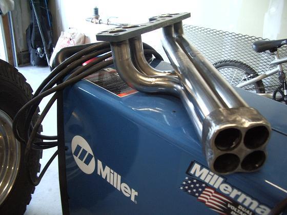

anarchist Posted December 20, 2005 Share Posted December 20, 2005 the headers im building Quote Link to comment Share on other sites More sharing options...

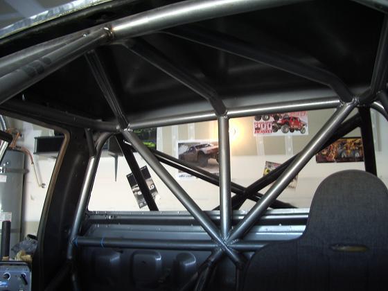

anarchist Posted December 20, 2005 Share Posted December 20, 2005 some of the cage Quote Link to comment Share on other sites More sharing options...

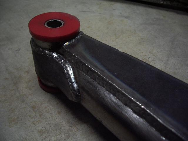

anarchist Posted December 20, 2005 Share Posted December 20, 2005 trailing arm close-up Quote Link to comment Share on other sites More sharing options...
zero Posted December 27, 2005 Share Posted December 27, 2005 that cage looks sick the welding on the trailing arm is sweet Quote Link to comment Share on other sites More sharing options...
