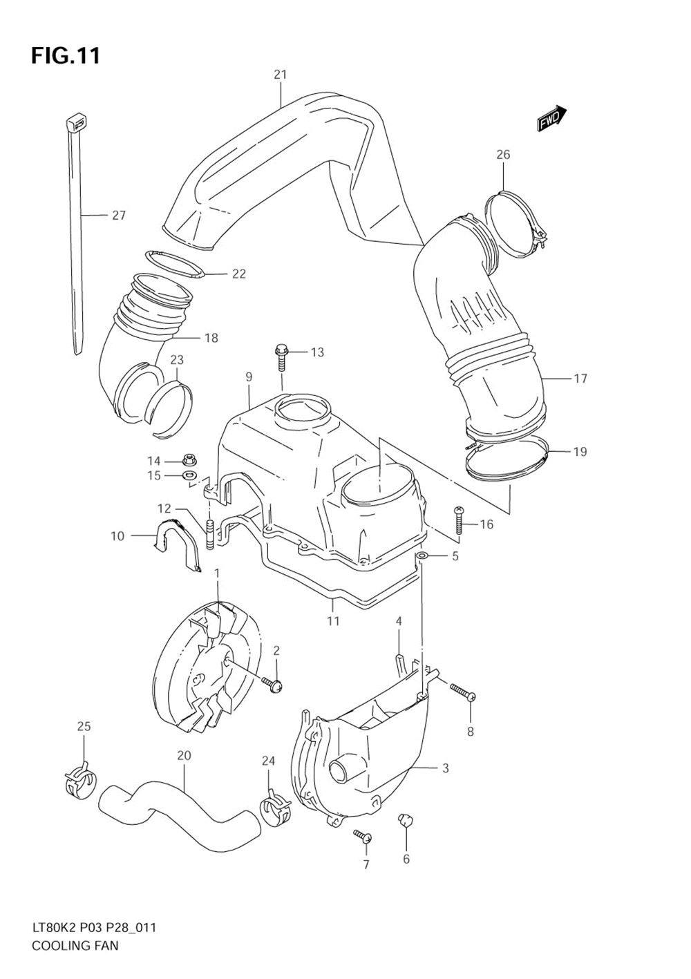

travism Posted July 25, 2007 Share Posted July 25, 2007 My kids have LT80's. How do you cover up the air intake to keep so much dirt and sand from coming in? The intake is just behind the left front wheel Quote Link to comment Share on other sites More sharing options...
Warrior07 Posted July 26, 2007 Share Posted July 26, 2007 which intake are you referring to Quote Link to comment Share on other sites More sharing options...
travism Posted July 26, 2007 Author Share Posted July 26, 2007 which intake are you referring to I think it is #21 on figure 11 Where air goes into the whole assembly Quote Link to comment Share on other sites More sharing options...
Warrior07 Posted July 26, 2007 Share Posted July 26, 2007 that's real similar to a rhino clutch/belt system intake best bet is to take the pipe off and try to find a universal filter (uni makes a wide variety ) it will at least help out with the dust / dirt . Quote Link to comment Share on other sites More sharing options...
