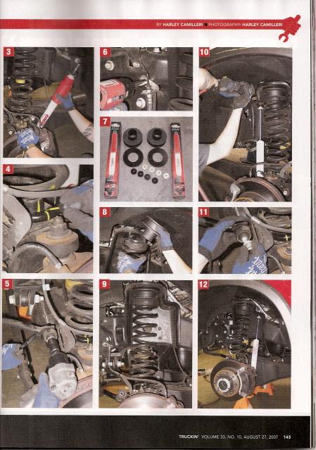

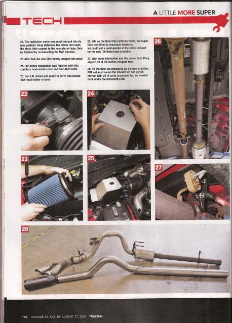

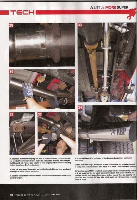

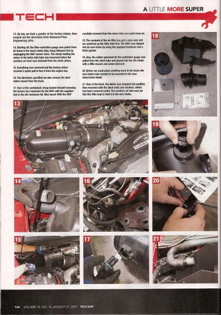

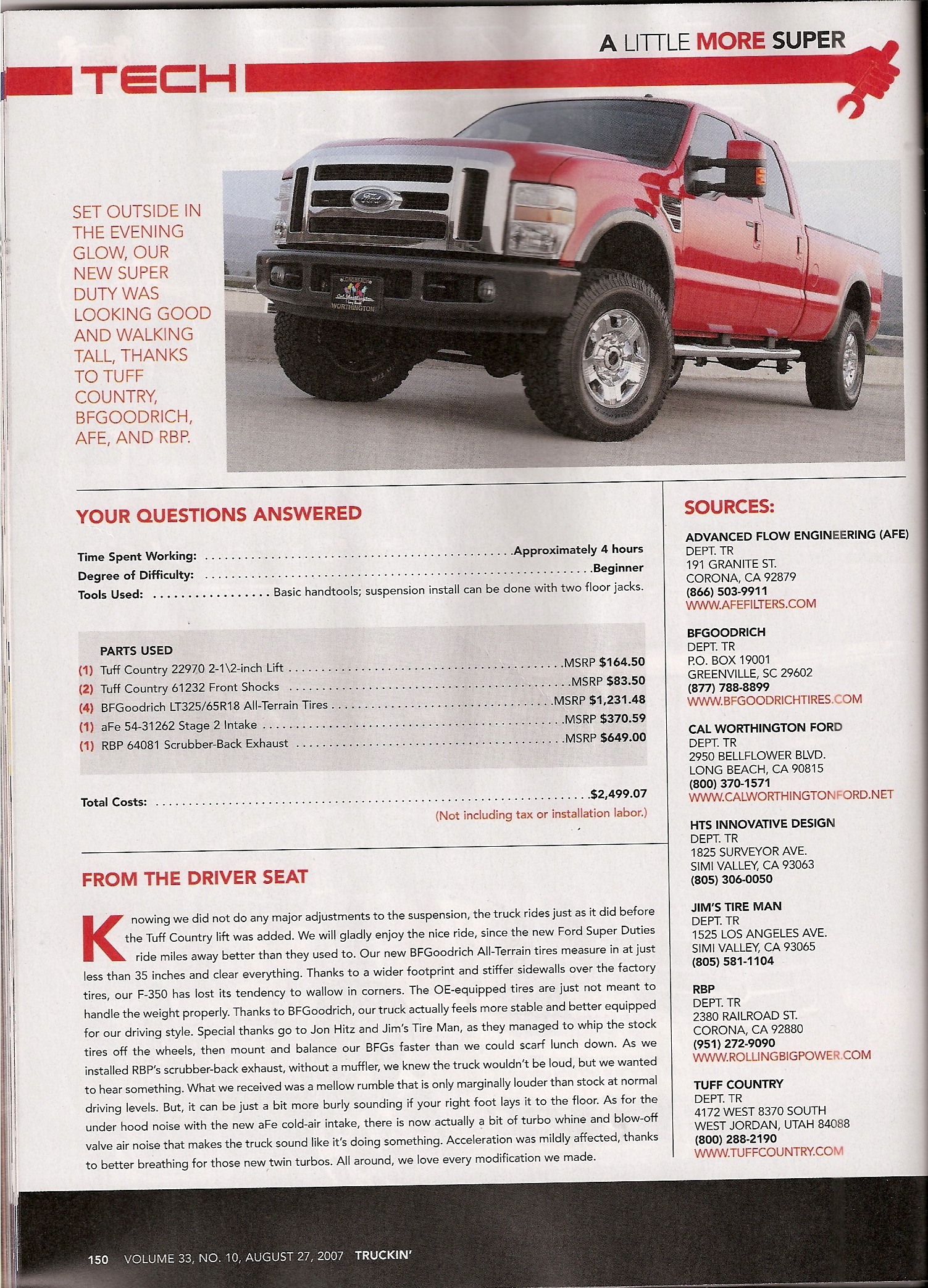

Desert Yeti Posted July 26, 2007 Share Posted July 26, 2007 here is some info for everybody to check out... My wife had a friend that works for Truckin Mag. and he needed my model truck for some basic mod's.. here is some pictures go check out Truckin magazine to see more of it.... Quote Link to comment Share on other sites More sharing options...
Desert Yeti Posted July 26, 2007 Author Share Posted July 26, 2007 (edited) here is the before picture....sorry having trouble posting before picture bu t you get the idea Edited July 26, 2007 by Desert Yeti Quote Link to comment Share on other sites More sharing options...

Desert Yeti Posted August 2, 2007 Author Share Posted August 2, 2007 is there a big night and day difference? yes there is a HUGE difference the response time is that much quicker and the TORQUE is unbelievable.. I can get off throttle pulling our 5-er and get back on it and have no trouble pulling up the Mountain..... and I LOVE the TURBO Noise too . If anyone interested in FORD SUPER DUTY let me know my Wife is MANAGER.. Quote Link to comment Share on other sites More sharing options...
