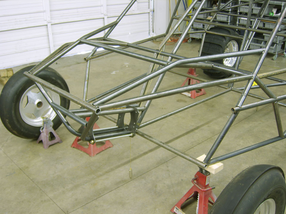

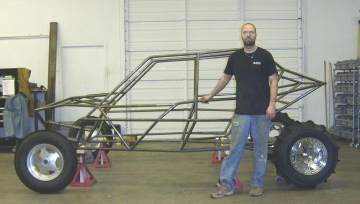

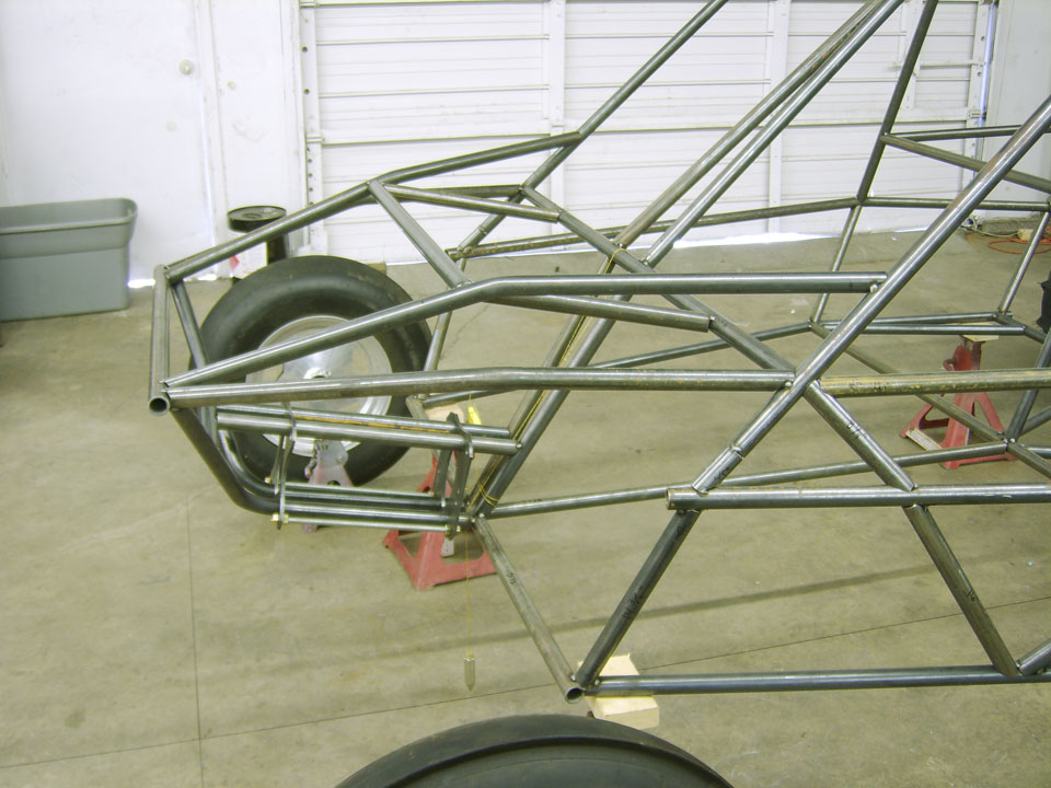

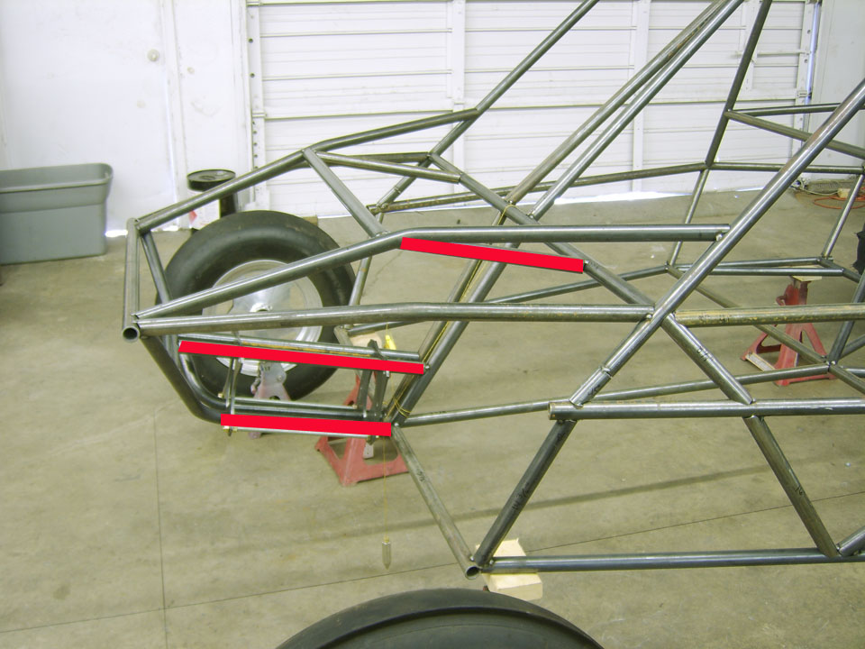

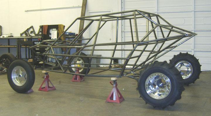

Yoshi Posted August 8, 2007 Author Share Posted August 8, 2007 Made some more progress on the front end, just a couple more tubes and it's done. People think it's a lot bigger than it is, so i'm posting a pic with me standing next to it for reference. I'm, 6'1" and 165 pounds... Quote Link to comment Share on other sites More sharing options...

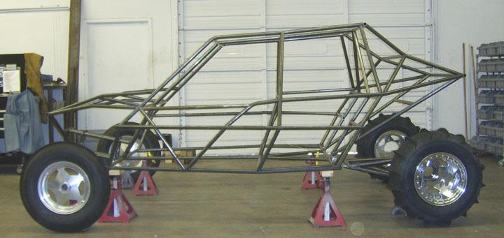

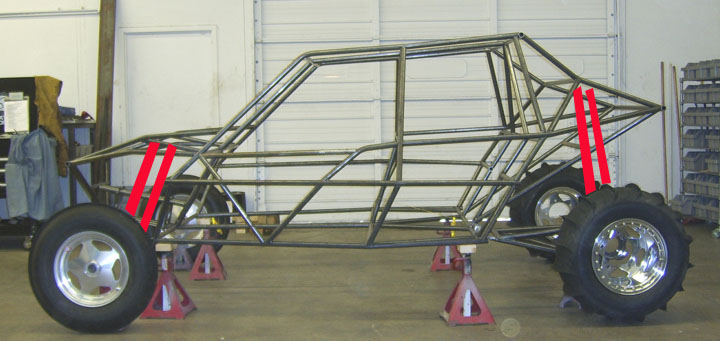

dunefreak Posted August 9, 2007 Share Posted August 9, 2007 Looks good I went to the show this past weekend in Ontario and a place called Federal sand rails has a car with the same seat lay out.... Those are Yoshi's cars. http://www.dumontduneriders.com/invision/i...amp;#entry86869 Looking good Yoshi. I really like the design and the bracing looks strong. Where and how are the front shocks going to be mounted? Quote Link to comment Share on other sites More sharing options...
Yoshi Posted August 9, 2007 Author Share Posted August 9, 2007 (edited) Those are Yoshi's cars. http://www.dumontduneriders.com/invision/i...amp;#entry86869 Looking good Yoshi. I really like the design and the bracing looks strong. Where and how are the front shocks going to be mounted? Thank ya much. The red tubes in the first picture are all parallel to each other. there is 13 degrees of rake in the front suspension, so the wheels cycle back perfectly inline with the upper red tubes. I designed the nose around the suspension rake. The second pic is to give an idea of the placement for 2 shocks on each wheel.... Edited August 9, 2007 by Yoshi Quote Link to comment Share on other sites More sharing options...
