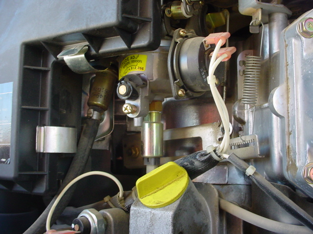

JoeDuner Posted August 11, 2007 Share Posted August 11, 2007 Take a picture of it and upload it. I had the same thing happen. I was able to keep it running by manually choking it. I had to pull the elevation screw (idle mixture screw) and clean the float bowl real good. Quote Link to comment Share on other sites More sharing options...
dunefreak Posted August 11, 2007 Share Posted August 11, 2007 ^ yep what he said. Tyler, you should be able to access the carb on a Onan pretty easily. another tip- mine didn't start once and it was because the choke linkage cam screw backed out. (side of teh carb) So when it was supposed to be choked, the choke plate was wide open not allowing it to start. Quote Link to comment Share on other sites More sharing options...

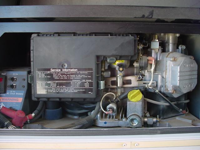

MAXDOUT Posted August 11, 2007 Author Share Posted August 11, 2007 here it is Quote Link to comment Share on other sites More sharing options...

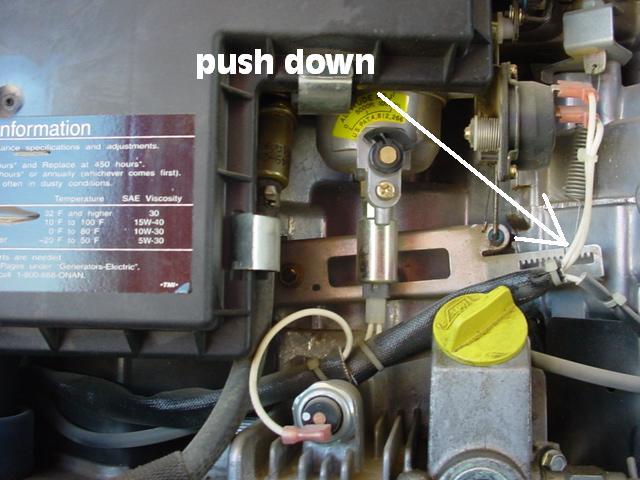

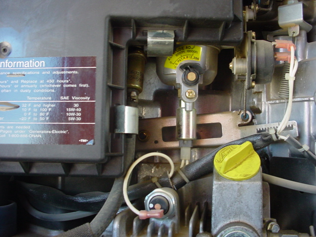

dunefreak Posted August 11, 2007 Share Posted August 11, 2007 Try that first then. You are gonna take off the air filter cover. It's real simple, just unclip the 2 or 3 clips, pull the air filter out and hold the throttle plate or choke open and shoot some in there while cranking. You should have a start switch outside on the generator so you don't have to do it from inside. Just don't go overboard and flood it out. Here is where the throat of the carb will be when you take the air filter and cover off. Quote Link to comment Share on other sites More sharing options...
dunefreak Posted August 11, 2007 Share Posted August 11, 2007 Another thing that worked for me once was to hold down the choke manually while cranking and let go if it starts. It is a metal arm with a spring on it. Quote Link to comment Share on other sites More sharing options...
