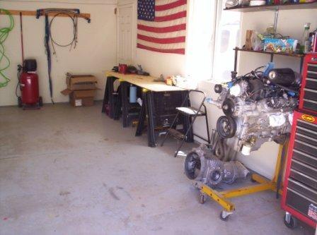

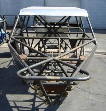

Sick Dayz Posted August 20, 2007 Share Posted August 20, 2007 I don't know many of you, but wouldn't mind meeting some new dune buddies. My family and I try to make it out to Dumont 1-2 times a year. I removed the LS1, computer, 2D, lights, gauges, and other odds and ends, from my old Sand Candy chassis. It’s time for me to step up to something that can handle the off-road as well as the sand. And I know Justin is the man for the job. Justin is just about done with my 4 seat Silencer “roller”. I am planning to pick it up next weekend. Pic of the chassis, so far… Pic of the garage awaiting arrival… As usual, I’m a little over budget, but felt some things were worth it. I’m going with 2” front spindles Fox coil overs Fox 2.5” 3 tube + gold tube in the front Fox 3” 4 tube + gold tube in the rear I’m also adding a Lowance 540c I went with RaceCraft leatherette seats Already had the 4 seat in car radio Gear One mid board hubs Enclosed front body work Gear One 2.5” power rack Rear Sway bar Etc… The one thing I wish I could afford to do right now is an S4 or Fortin. Another is the 934 CVs. For now I am going to run the 2D with 930s. I figure, there’s really no point in running 934s if I got a 2D. One nice thing about the Silencer is that upgrading is not that big of a deal, and there’s always next year… Quote Link to comment Share on other sites More sharing options...

Sick Dayz Posted August 20, 2007 Author Share Posted August 20, 2007 Thanks guys, I will keep you posted on my progress. I’m going to try and have it ready by the end of September. I’m not going to paint it this season, I’m saving that for next season, just in case I want to make some changes… Quote Link to comment Share on other sites More sharing options...
barefoot bob Posted August 20, 2007 Share Posted August 20, 2007 (edited) Sick Dayz said: Thanks guys, I will keep you posted on my progress. I’m going to try and have it ready by the end of September. I’m not going to paint it this season, I’m saving that for next season, just in case I want to make some changes… lmao changes !!! thats inevitable looks like a nice frame you can go nuts on a frame like that Edited August 23, 2007 by barefoot bob Quote Link to comment Share on other sites More sharing options...
