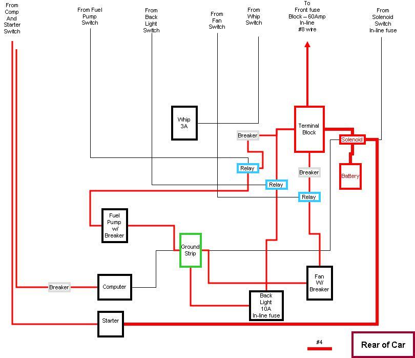

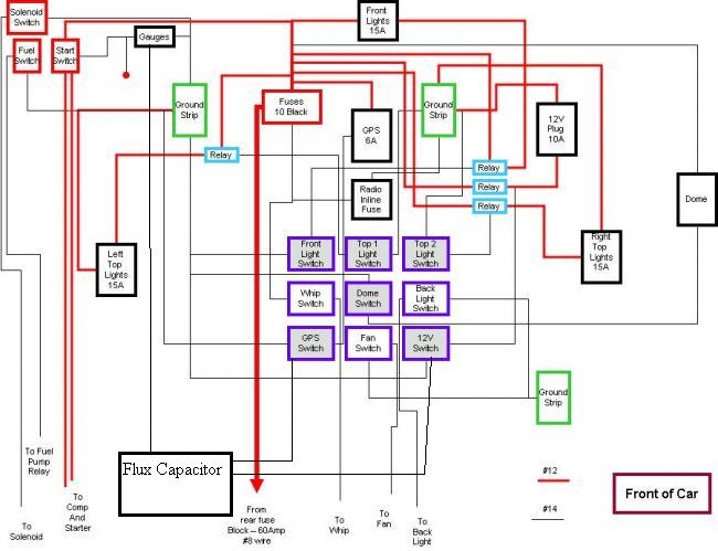

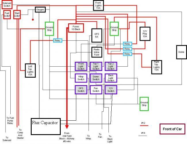

RAGDOLL MX Posted August 26, 2007 Share Posted August 26, 2007 Well, I’m not going to get my chassis this weekend. So, I thought I would get a jump on the wiring. Here is what I have so far. I’m no expert, am I missing anything? where is the flux capisator???? Quote Link to comment Share on other sites More sharing options...

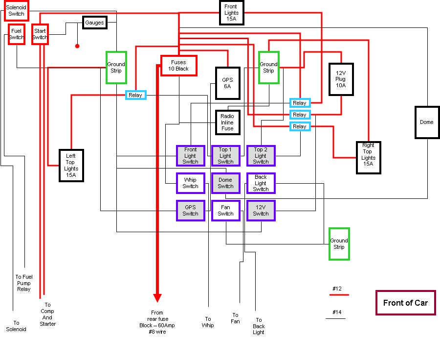

RAGDOLL MX Posted August 26, 2007 Share Posted August 26, 2007 here is a revised version Quote Link to comment Share on other sites More sharing options...

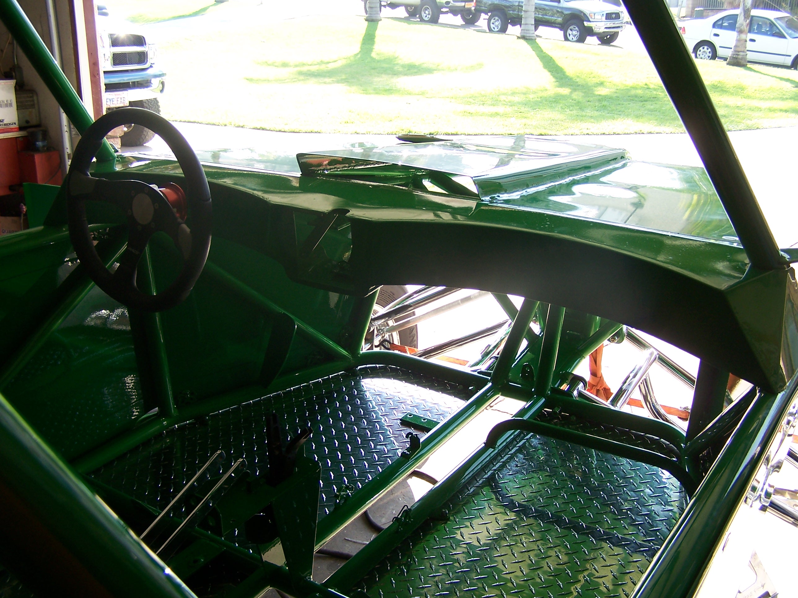

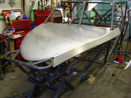

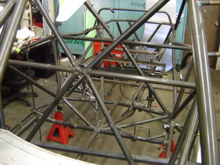

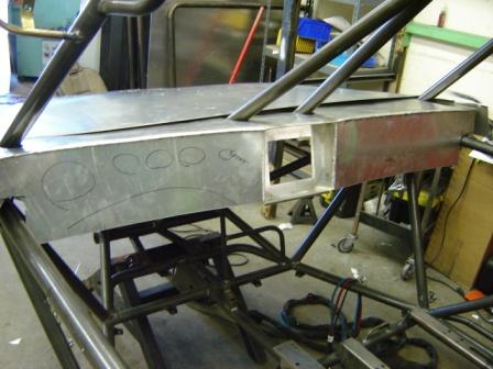

Sick Dayz Posted August 30, 2007 Author Share Posted August 30, 2007 Here are a few picks. Should be a roller by Friday. I'm picking it up on Saturday Quote Link to comment Share on other sites More sharing options...
dunefreak Posted August 30, 2007 Share Posted August 30, 2007 Looking pretty good! Those cars look stout as hell. Quote Link to comment Share on other sites More sharing options...
wingnut Posted August 30, 2007 Share Posted August 30, 2007 Nice!!!! Hey someone drew on your dash with a sharpie were your gauges are supposed to be!!! :shocked2: Quote Link to comment Share on other sites More sharing options...

Sick Dayz Posted August 30, 2007 Author Share Posted August 30, 2007 Nice!!!! Hey someone drew on your dash with a sharpie were your gauges are supposed to be!!! :shocked2: I told you my budget was getting tight. I had to go with the sharpie gauges… Quote Link to comment Share on other sites More sharing options...
barefoot bob Posted August 30, 2007 Share Posted August 30, 2007 (edited) I told you my budget was getting tight. I had to go with the sharpie gauges… make sure you draw the needle in the 170 zone dont need to overheat. and make sure you draw the fuel gauge on full your dash looks like mine copycater 2 half moons with a mount for the nav in the middle . lol but i drew my gauges all wrong i erased them so i can draw the needles in the right places :shocked2: Edited August 30, 2007 by barefoot bob Quote Link to comment Share on other sites More sharing options...

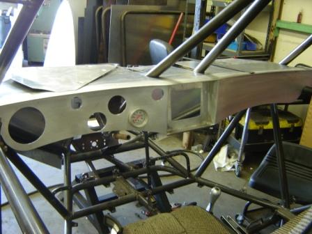

Sick Dayz Posted August 30, 2007 Author Share Posted August 30, 2007 make sure you draw the needle in the 170 zone dont need to overheat. and make sure you draw the fuel gauge on full your dash looks like mine copycater 2 half moons with a mount for the nav in the middle . lol but i drew my gauges all wrong i erased them so i can draw the needles in the right places :Danielle: Temp = 170... check Oil = 50... check Volts = 13... check Fuel = full... check Tach = 6000... check I think i got it, by the way, I’m going with black sharpie (can't go wrong with black) That dash is similar... Here is an updated pick of the dash... Quote Link to comment Share on other sites More sharing options...
dunefreak Posted August 30, 2007 Share Posted August 30, 2007 Hey some jerk cut holes in your gauges! Quote Link to comment Share on other sites More sharing options...
