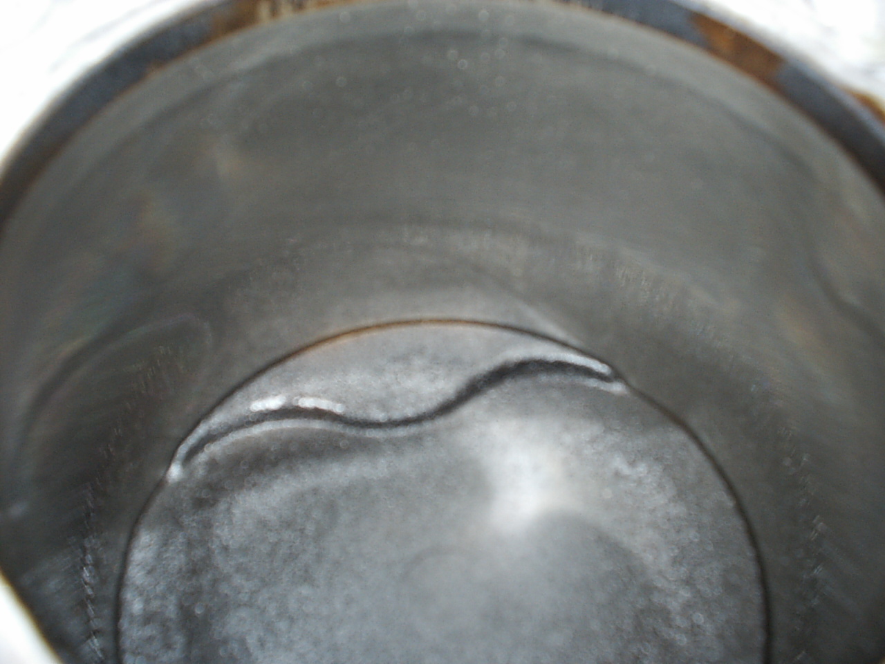

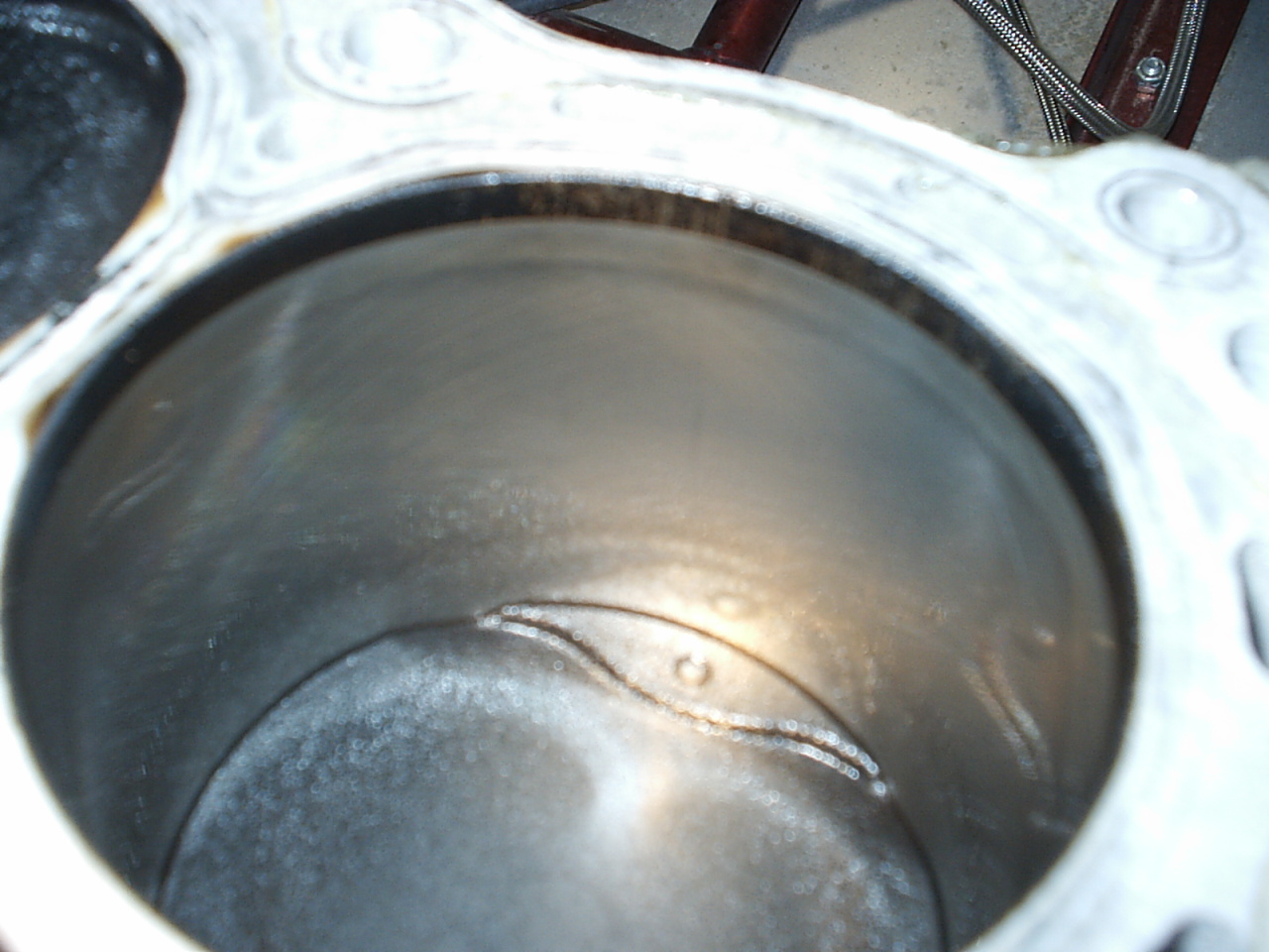

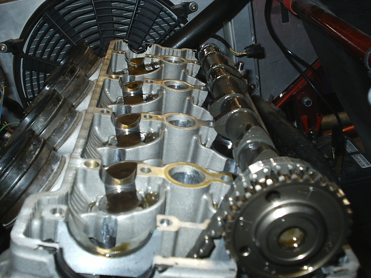

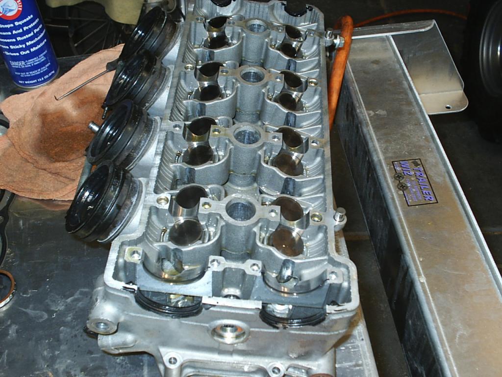

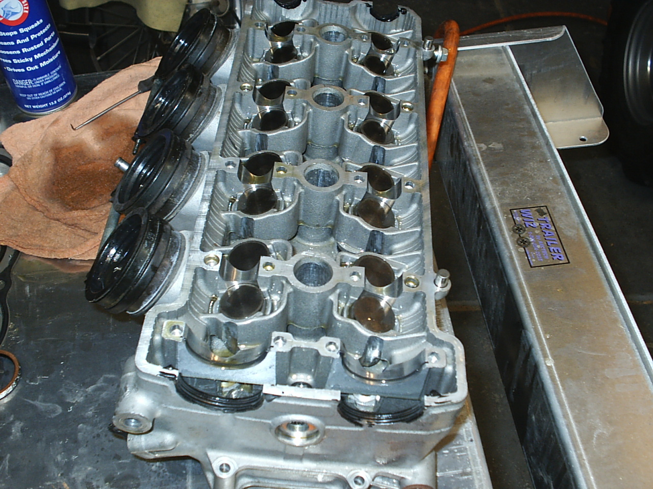

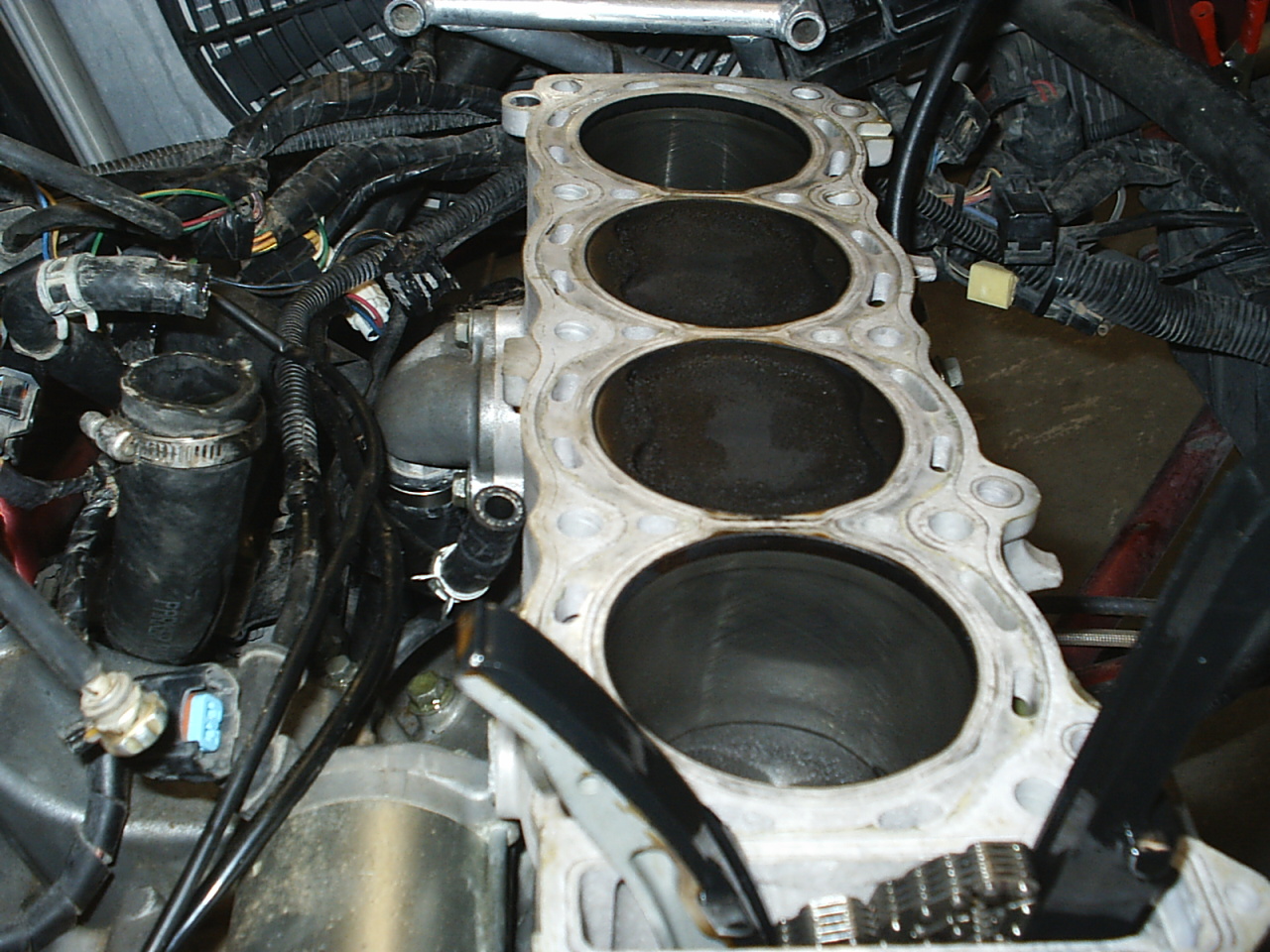

:laughoff: Car is finally back up and running. I ended up pulling the head and cylinders off the motor. I didn't find any leakage from the valves or any ring/ cylinder issues. I was pretty dissapointed to say the least. :rockon: So I dropped the head off at Heads Up to have the valves cleaned up and checked out. Scott found sand in #4! :shake: As originalpimp said, "Where the heck would I have gotten SAND from?" :laughing: I have no clue how it got in there. I always clean my air filter and I checked all the intake boots off the throttle body, so who knows....? It doesn't matter much now though, the car runs and runs good! I might have to jam out to Dumont in the AM and test it out and make sure there are no issues before next weekend. I'm happier than a pig in sh*t! :monkeedance2:
some pics from the painfull project...
