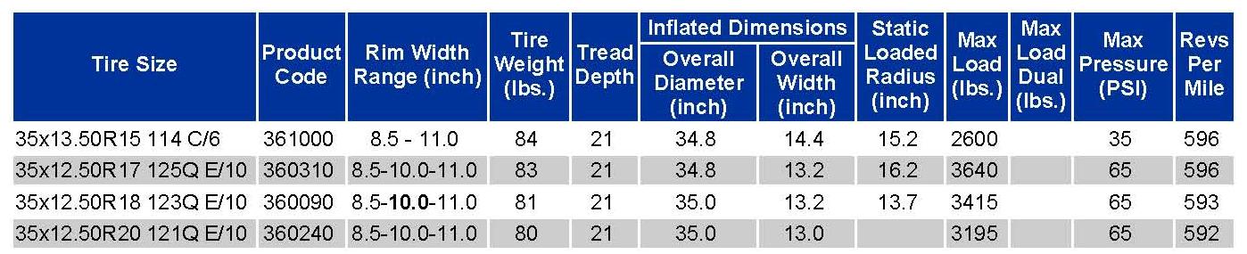

So I'm not out of my mind to want to tow a large 5th wheel w/ a 6” lift & 35's on a 1-Ton SRW?
What about the lift, do you loose the 1-Ton rating? And the 35” tires, can you get a mud terrain type tire with heavy load rating?

Yeah you can get the Toyo Open Country MT's with the rating you need.
Here I cut this from their spec sheet.

I know people love toyos yoyos,but I had a problem with the 16" they are squirly. my bfg`s are rated 3195 and have the same side wall as toyos,,,they tow great!!! :shocked2:
I know people love toyos yoyos,but I had a problem with the 16" they are squirly. my bfg`s are rated 3195 and have the same side wall as toyos,,,they tow great!!! :laughoff:

No, your not out of your mind! Yes, you can retain the same payload capacity. Give me a call if you need someone to build your truck the correct way for towing and style. Travis 702-436-6777 (The Custom Shop)
Rhino_King tows a 38' gear box w/ a slighty lifted 1 ton srw shortbed Ford... Get the bigger load range tires and your fine.. :D
Just when I was starting to think I should really get the dually and be done with it, I’m glad to hear it seems to be fine and not unsafe. I’m going for the SRW 6” lift and 35’s, cheers.
