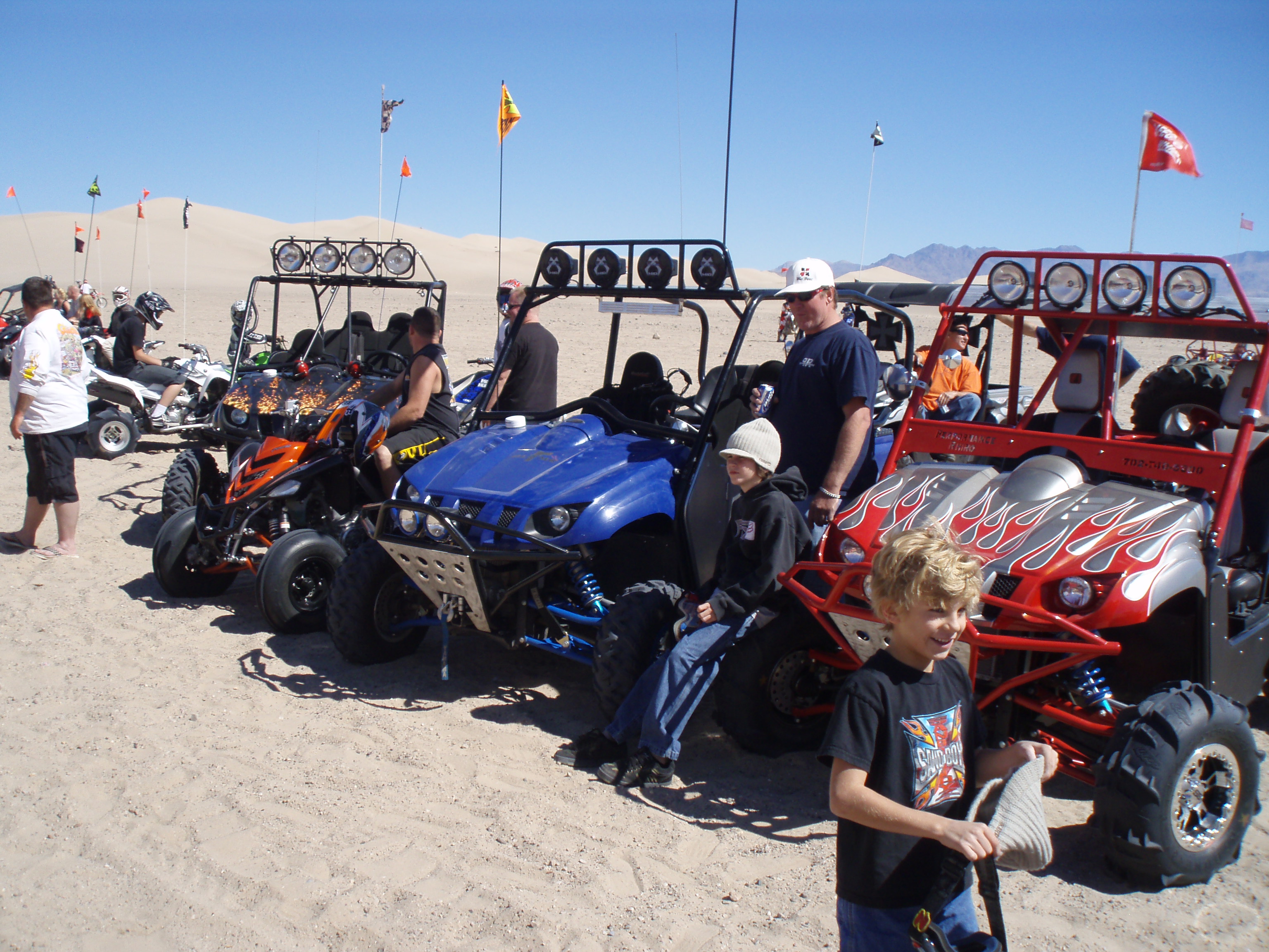

90+ PLUS Posted October 11, 2007 Share Posted October 11, 2007 (edited) get LT kit, clutch kit and a lectron carb and it will run like a champ. do what they said call mark he does good work. he did ours the blue one Edited October 11, 2007 by tanner54 Quote Link to comment Share on other sites More sharing options...
