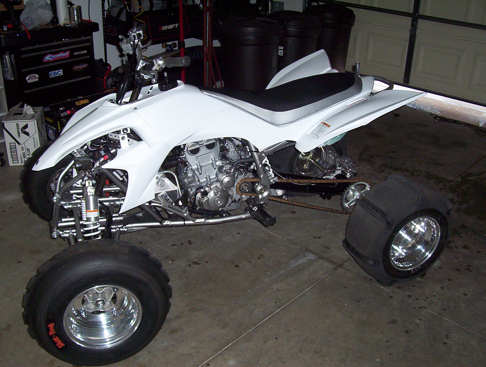

Got some new stuff for the YFZ

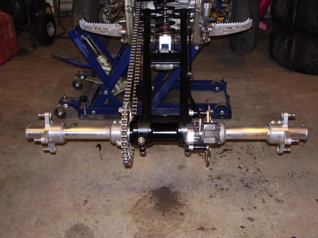

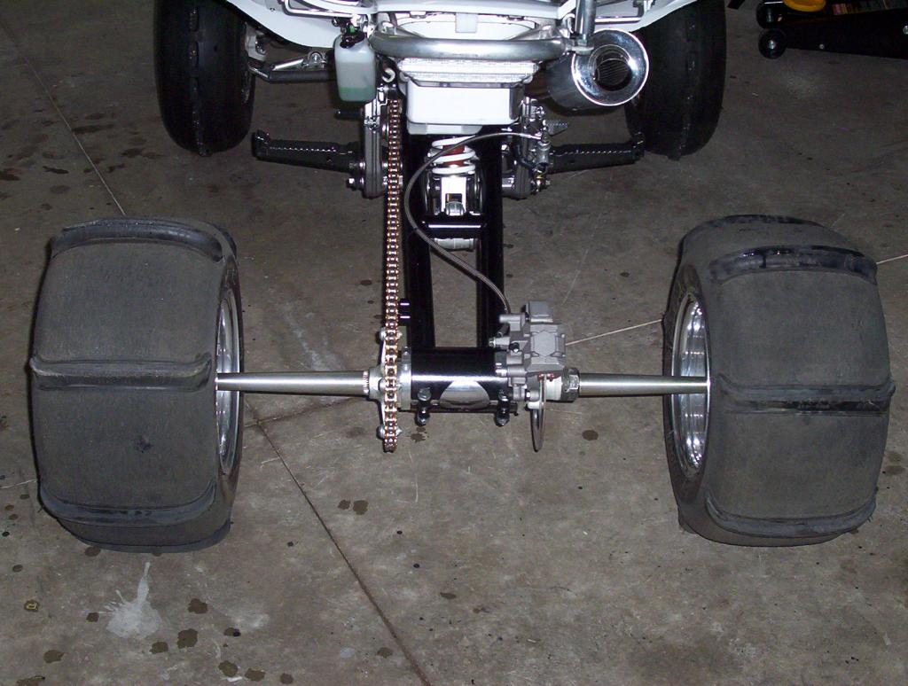

I just got a new +4 swingarm and modquad carrier for mine.
Advice...if anybody adds a +4 swingarm or under, you can use your stock brake line. Notice the snaking of the brake line. Do not order a +4 brakeline!!:hello:

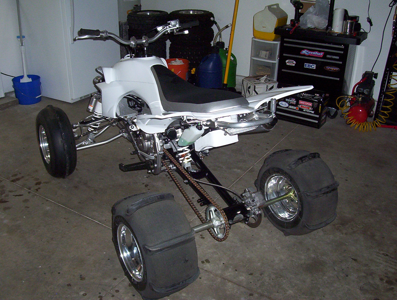

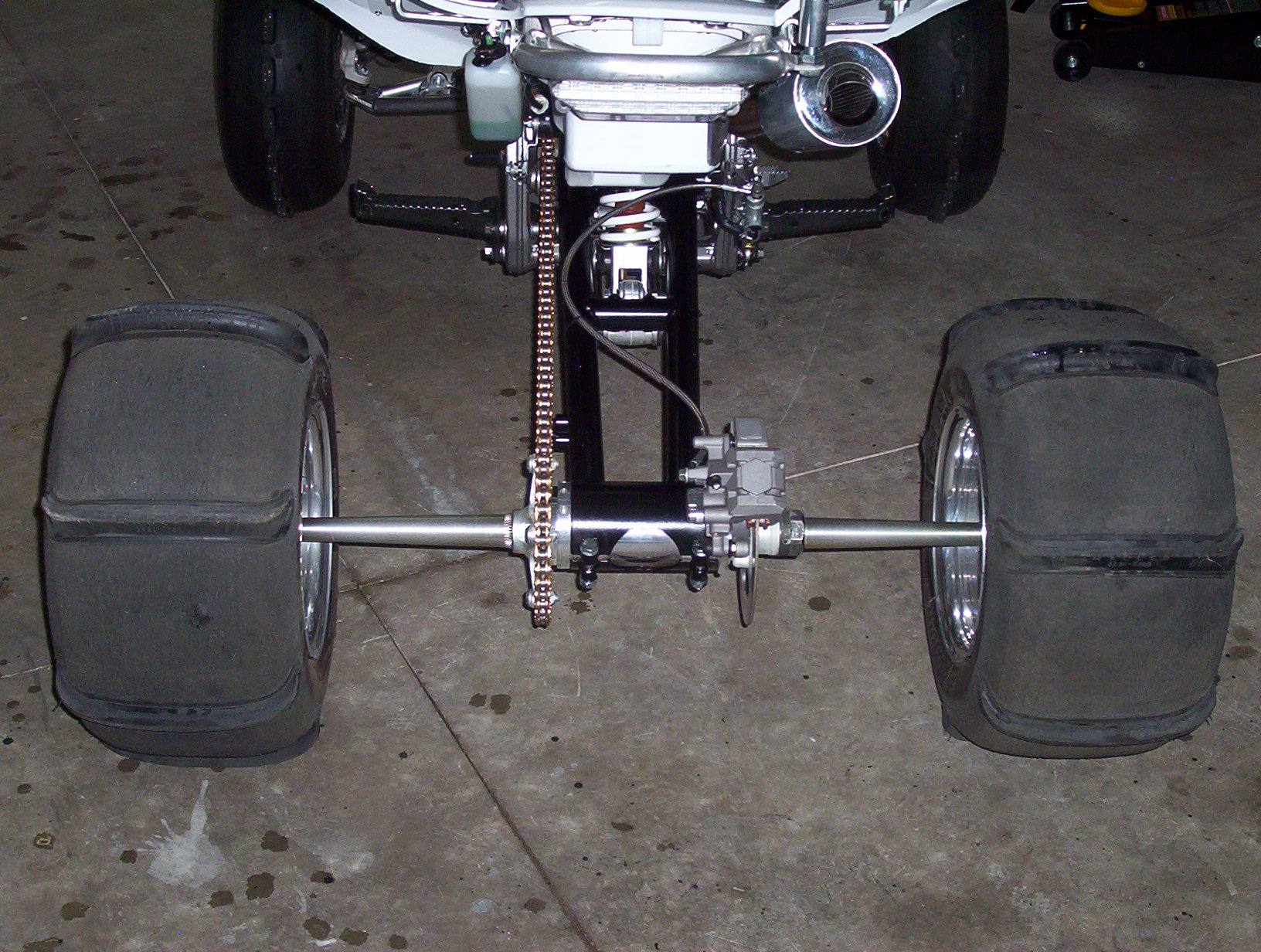

Heres my +3 with the stock brake line.I would have bought a longer one too,but my friend warned me first. :shocked2:

You would think of getting a longer brake line with a longer swingarm. Wish I would have had warning first. Oh well... :dolphin: I also noticed that the stock front brake lines snake up too. If anyone is going to add +2 a-arms, it looks like getting stock length aftermarket lines would work.

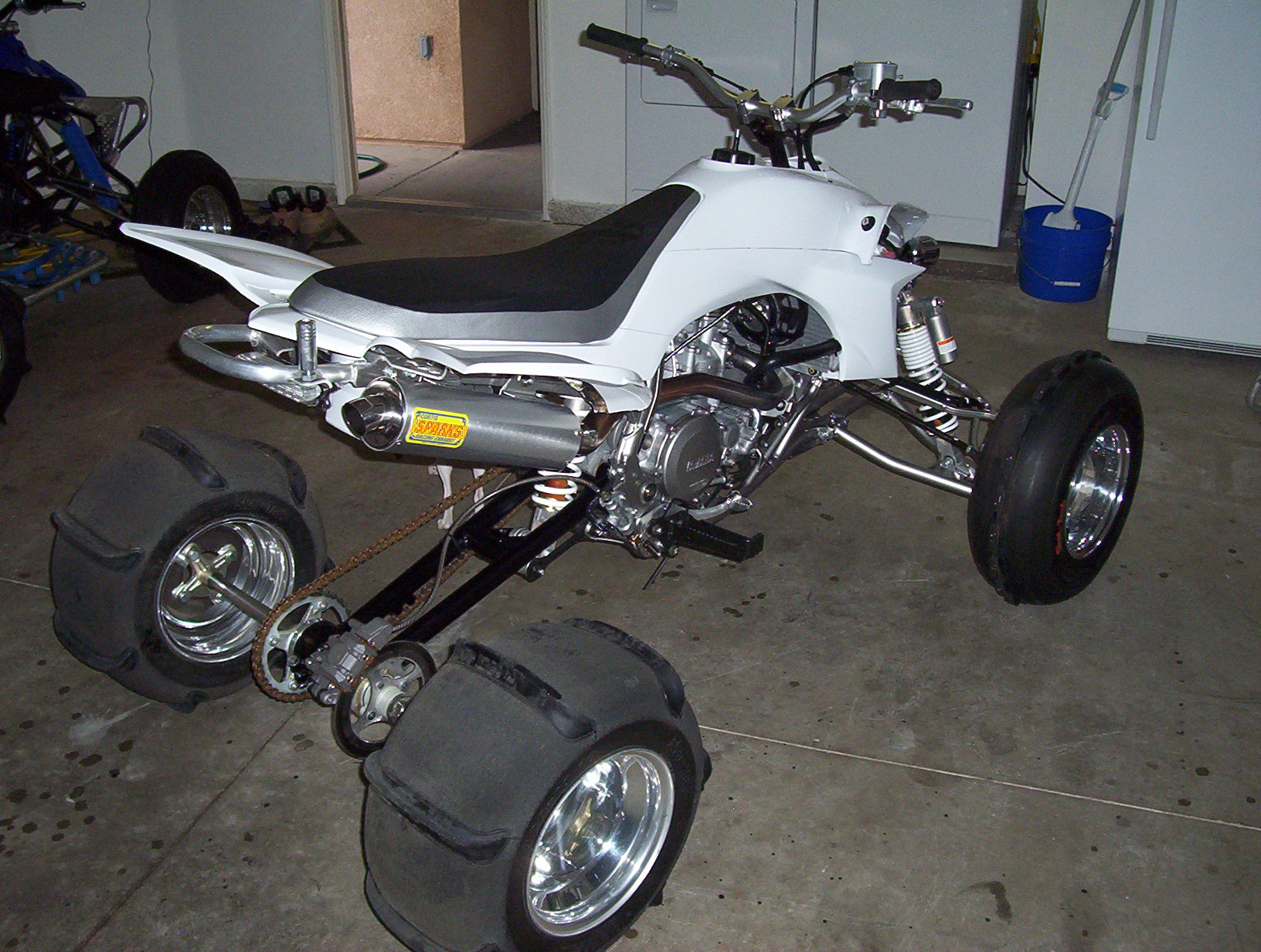

Bone stock with a pipe... :D
